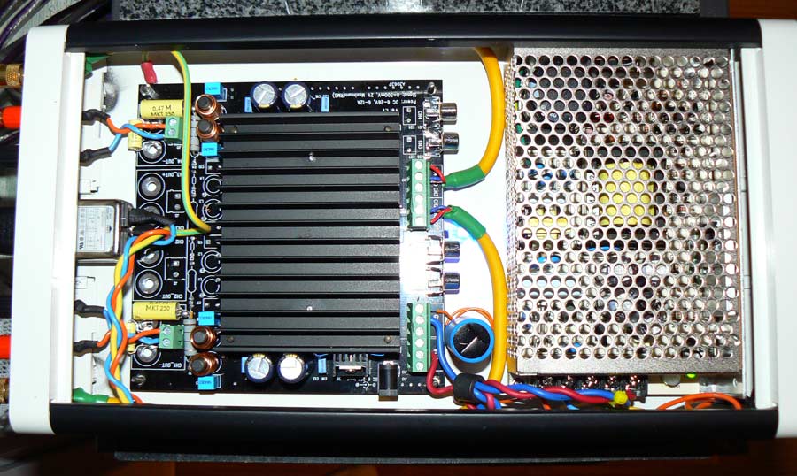

Mine measured 1k, so I've changed to 10r with 0.47uf. Added 0.22uf across the output as well..Changed the 1k input resistor to 4.7k to prevent input overload, still may need higher value? Running it with 14v power supply. Removed channels 2 and 3 (3 was the noisiest on mine.
Works best with less efficient speakers.
Also using with no input caps and DC at output is less than 20mv all volumes..

audio1st: Your set-up looks great! Can you share where you got the case and what other components you used?
Thanks!

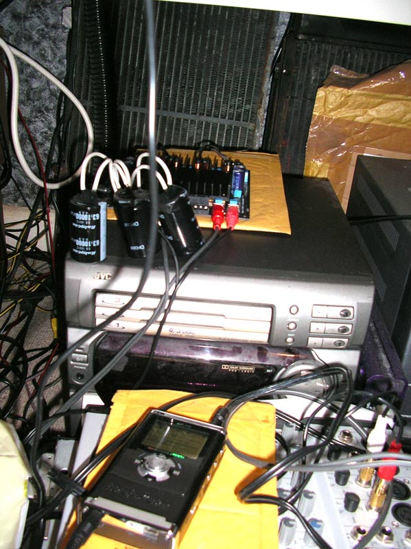

Yep, it's surprising how little power this amp uses when you turn it up...Sherman said:I'm using a 24V PS with mine for testing. It is only 3A but should be fine for two channels I think.
I'm now running mine from a 19v laptop PSU (Rated at 6.5A), and it's doing a great job, with 4 channels....
I only think you'd need 13A if you were running 24v, at 4 ohm loads, and cranked right up!
Anyway, I copied your cap idea, and added 3 x 10000uF Rubycon caps to the power input... It seems to make it sound a little better IMO, but then again it could be placebo...
My rig isn't quite so well organized, wires everywhere, but it works... Sorry for the bad pic quality:
Yep, well spotted. It's an H140.theAnonymous1 said:Is that an iRiver H120/H140 I see?
I've found the line-out sounds nice when playing FLAC's and high bitrate OGG's... It's sat on the volume control right now (little mixing desk).
I guess it would sound better if I just used a pot, but the desk is handy as I've got low-cut when I don't want to annoy the neighbours.
You wouldn't want to trade it for a well kept H320 would you?
You could even swap drives to keep it 40GB.
I use the digital out on it for my headphones rig, so I'd rather keep it really... I do see the odd one on e-bay tho...theAnonymous1 said:
