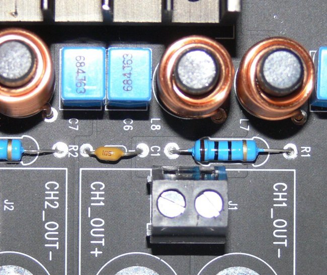

Are you sure? The Zobel caps on the one I bought are marked '105', ie 1uF. I think the resistors on mine are 10 Ohm as well. (10R + 1uf sounds realistic, but the resistors are only 1W at the most, and the caps are very small).
Mine only arrived two days ago , so I've not tried it yet, (and I could be wrong about the Zobel components, though I don't think so. How are your conponents marked?).

Re: Photos
If it helps at all, the large version of the photo should let you see a lot of the components on the Version 1.1 board that I got.
Large photo of board - it's bigger than your screen, probably, so hover over the lower right (in IE) until the icon to expand it shows up
Though the C1 type can't be read easily there, in another photo it pretty clearly looks to be 224 to me:
Closeup of C2
Other photos here:
Photos of Sure 4 Channel Amp

V1.1 is marked on the board, but I think that is the pcb version mumber.
It would be interesting to know what other people have got fitted on the board. 1k is a very high value for the Zobel resistor, and I can't see it having any useful effect. If you had 220n and 10R fitted it would be more understandable. Have you measured the resistors to see if they really are 1k?
