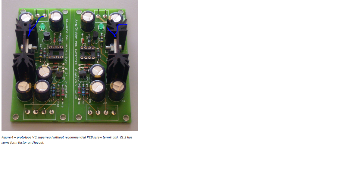

The BJTs are facing the wrong way, aren't they?
The silk screen is misleading, if they are in the wrong way.
Also the Galo 1995 article recommended raw dc power supply looks wrong as well. The negative section look exactly like the positive section. The cap isn't reversed in the negative section, and probably wrong at the bridge as well. I'm not sure about this so don't chew me out. I guess it depend on what reference is...
looks OK to me, the BJT's. See picture of mine
Pic in the article shows the tab pointing out.

With the tab facing out, the D44h11is backwards.
Checked against part specs and traces on the board.
So the silkscreen is correct, the photo is wrong, which is board v2.0.
I'll reverse the large BJTs again then take measurements.

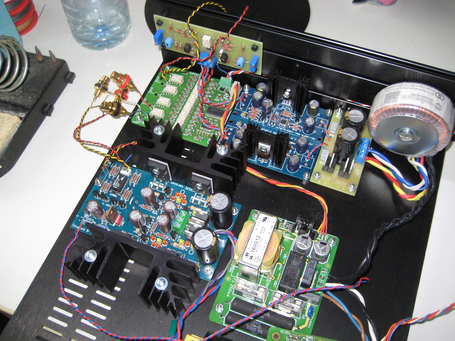

This weekend I built a Jung/Didden super reg with CRC filter and with a 2+ amp toroid for the B1. No other filtering. Im blown away with the results.
A friend passed on a simple tweak. Simply raise the transformer away from the chassis. I also removed the metal mounting hardware and used nylon bolt, washer and nut. I used plexiglass, but wood could work as a riser. Really good results.
I wish I could thank the original person who suggest this for DACs. I'll ask my friend.
