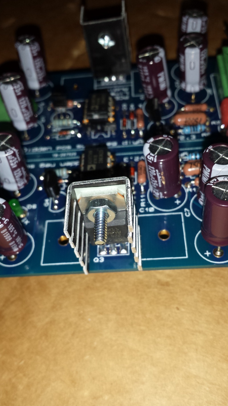

Need a little help.
I set up R14 and R7 as 1k for 12v output with R13 and R6 set to 750 ohm.
The zener is 6.8v and the LM329DZ is 6.9v. Only getting 7.77v at the output.
I tried to flip the values of say R14 and R7 thinking I had "top" and "bottom" mixed up, but it made no difference.
Ran a test on the positive side with an adjustable lab DC supply. The voltage increased at the output until it hits 7.77v, the lab supply could be increased further but the reg output stays at 7.77v.
I didn't connect the sense leads. What the proper way to connect them in a test? I tried to jumper the sense but the output was almost equal to the input voltage, even beyond 12v.
Used all the exact values except c12/11 which is 180pF. It's what I had on hand.
Thanks in advance,
Vince
Joined 2000
The BJTs are facing the wrong way, aren't they?
The silk screen is misleading, if they are in the wrong way.
Also the Galo 1995 article recommended raw dc power supply looks wrong as well. The negative section look exactly like the positive section. The cap isn't reversed in the negative section, and probably wrong at the bridge as well. I'm not sure about this so don't chew me out. I guess it depend on what reference is...
I am not at home right now but I seem to remember that the pass transistor heat tab faced outward.
See the pic in the diyaudio store.
Another check is to measure the ref voltage.
Jan
