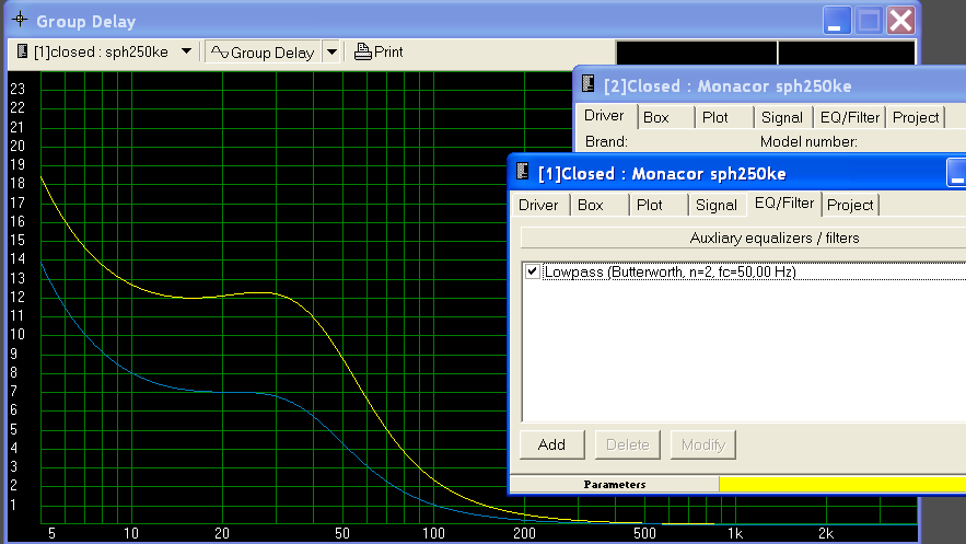

I would definately go closed box or Aperiodic, the linkwitz transform is great if your driver can handle the excursion but that's just me, I rarely go for ported designs.

LINKWITZ transform If I do a correction like that this happens to the group delay yellow line. Bleu line closed box without linkwitz correction. Looks like a avarage basreflex(yellow line).

Than group delay maybe isn't the problem.Doesn't sound like reflex bass, at all.
