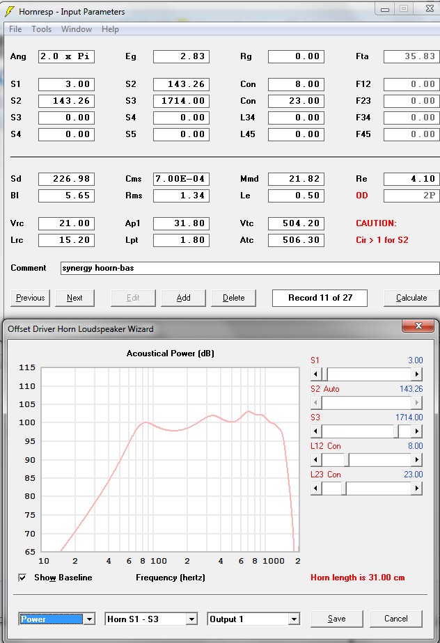

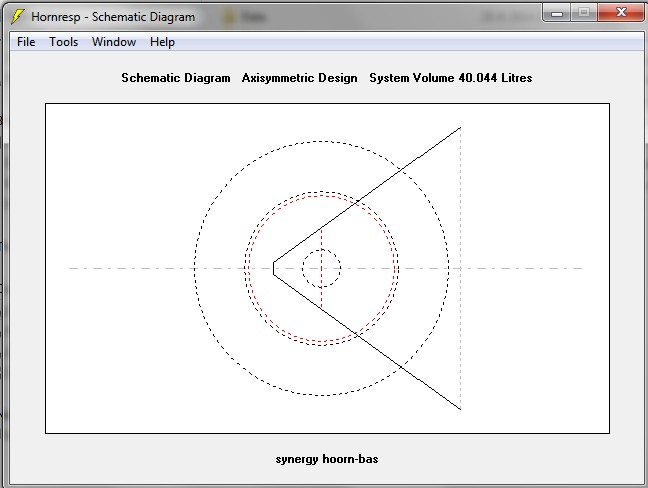

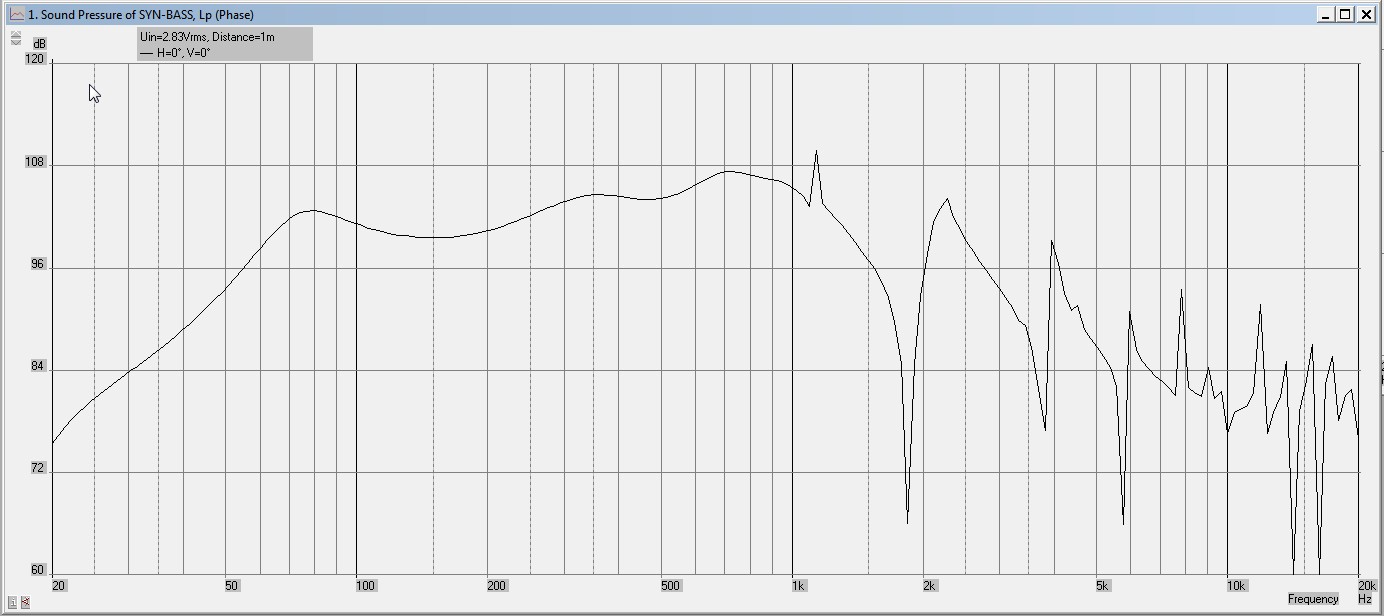

I did see a synergy from danley who have a coaxial high mid driver and two 8 inchers, are here some peoplw who are play with this? I did plan to make home horn, so this are big enough for that.
The phillips did goh wide but the port I can not make, speaker is in the way of the tweeter driver.
SM60F from danley is such type, I think part of coaxial go behind the tweeter driver to get mid, but this I think can not be simulated.
I like tp play a lot then decide.
regards
kees
I did find a synergy with a CD and two 8 inch woofers, I have use this dimensions in hornresp and akabak and get this as output.
Then I do with a bassreflex port then I see just one port in the back chamber and without it is in front, have I to use two ports of the same dimensions if i do use a bassreflex port?, however the phillips driver does wel without. using the extra flare normally seen on the synergy do sim more bad, I do not get smoother graph.
I did set lpt length to 1.80 the thickness of the used wood panels, If I did this right afcourse
I go for a conic synergy and a tratrix for testing, I am curieus about it, nice winter project.
regards kees
Kees,
The port area can be divided in multiples equaling the same area and still tune to roughly the same frequency, as long as their depth remains the same.
Kees,
I do use the thickness of the wood for the length of both ports, the injection ports aswel the reflex port, however, I need two, for each speaker one, that means divede in two indeed, but I think she will be small.
I go be a whole undertaking to get the back chamber right, calculate that volume is not so easy with al these forms, maybe sketchup is of use for that,
If only mid and high then is this not so difficult with the closed mids.
regards
kees
A last thing remains.
the throat, closed rear volume etc, I presume closed rear volume is as it is for two woofers.? a possible port
there i have to devide by number of ports?
the throat I have to devide when two speakers? like throat chamber volume and throat chamber port
if i use 4 ports two per speaker then divide /4?
I need also the volume of the cone included, also here x 2 because there are two speakers.
this is the last trouble I can experience when I am not shure how to dfo it right.
thanks
regards
kees
1)the throat, closed rear volume etc, I presume closed rear volume is as it is for two woofers.?
2)a possible port there i have to devide by number of ports?
3)the throat I have to devide when two speakers?
4)if i use 4 ports two per speaker then divide /4?
1) If you use two rear chambers, that is, the drivers are not sharing a common box, then VRC is divided by 2.
2) Huh :)?
3)Yes.
4) Yes, four ports APT /4 .
