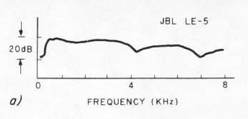

For those not familiar with the basis of my tractrix horn, inspiration came from the Edgar midrange horn: http://volvotreter.de/downloads/Edgar-Midrange-Horn.pdf where the esteemed JBL LE-5 driver was the one to have. This horn/driver combo may not have had much high frequency extension because the LE-5 driver was not capable of producing it as a bare driver, as it was designed as a mid. Here is the Edgar tractrix with an LE-5 as measured by Edgar in the above paper:
It too, has a dip near 4kHz - which Edgar later describes can be reduced using Scotchbrite pads around the throat. But the response is not unlike what I measured, given Edgar's horn is made of plywood and mine is made of foam core and caulking. Is this a "poor design"?

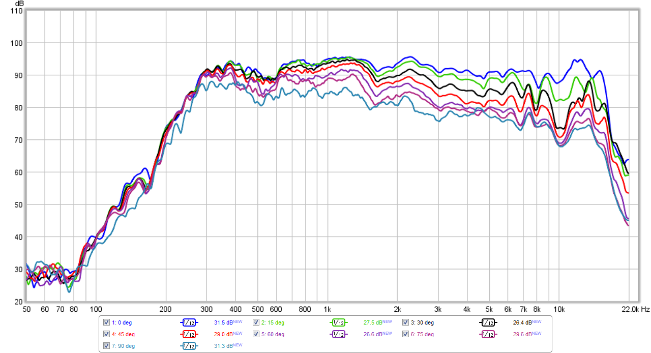

And here is the polar response measured with the new panel damping scheme:

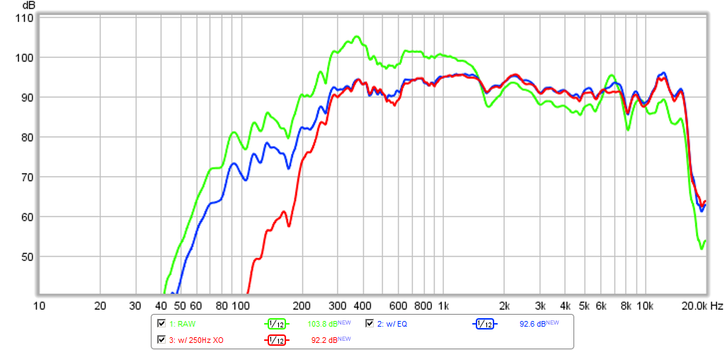

Here is the raw response vs the EQ'd response (with 75Hz HPF and 250Hz HPF):

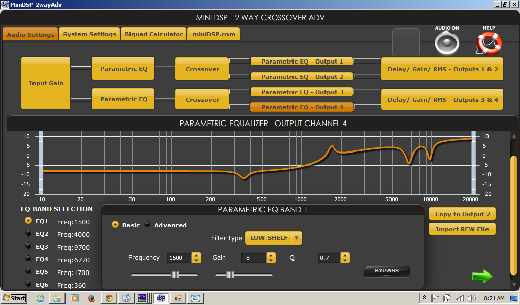

And here is the excessively heavy DSP EQ that is being applied:
I have laid it all on the table so folks can decide for themselves if this is the sort of horn they may want to try. But to dismiss it as a "bad design" isn't right as it is a 175Hz tractrix design per equations in the Ed Forker spreadsheet, which I assume, are good. Maybe not low-passing it at 1.4kHz or so is "bad" but that seems to allow the horn to reach 15kHz, and do it with acceptable low distortion levels.
