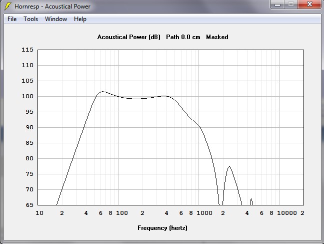

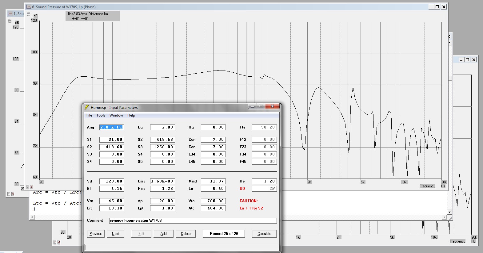

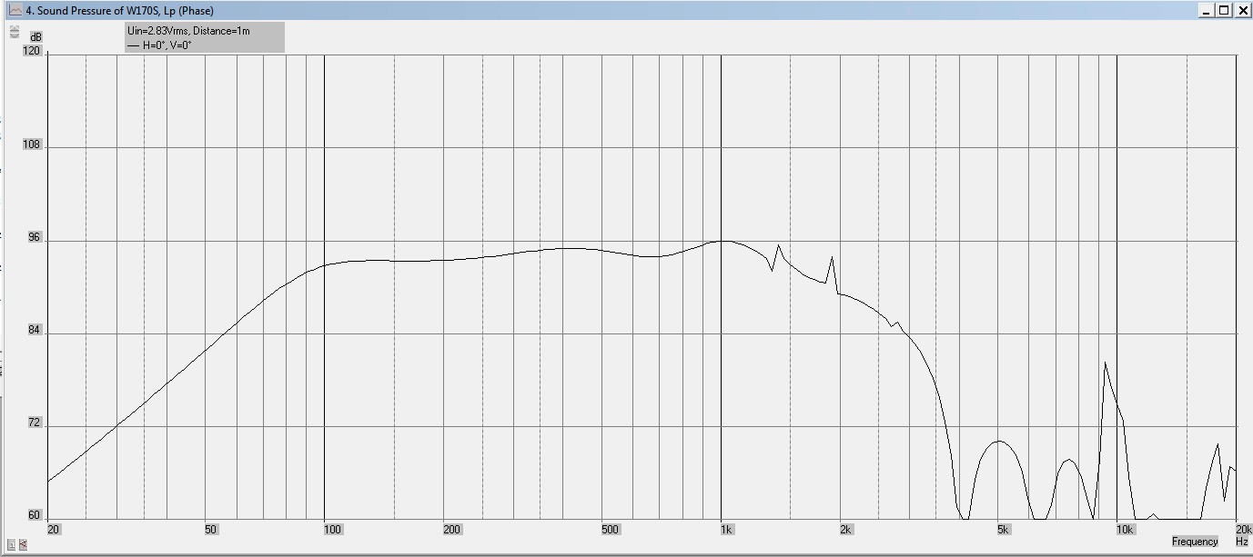

It is always interesting to test different speakers, this time thw W170S from visaton who is not expensive, but I do see that there is big difference between akabak and hornresp, to get hornresp sim oke I need to put the port very close to the throat, for akabak it sims oke when vtc is 300 cc and hornresp needs 700cc for a good sim.
I think hornresp can not do higher frequenties very good, hornresp is more a subwoofer simmer but it is very interesting when it do also frequenties to 20 Khz, but maybe this is not easy to implement.
I do also not now if akabak has trusted sims, I have learn it for 60 procent and I do use it for high frequentie sims.

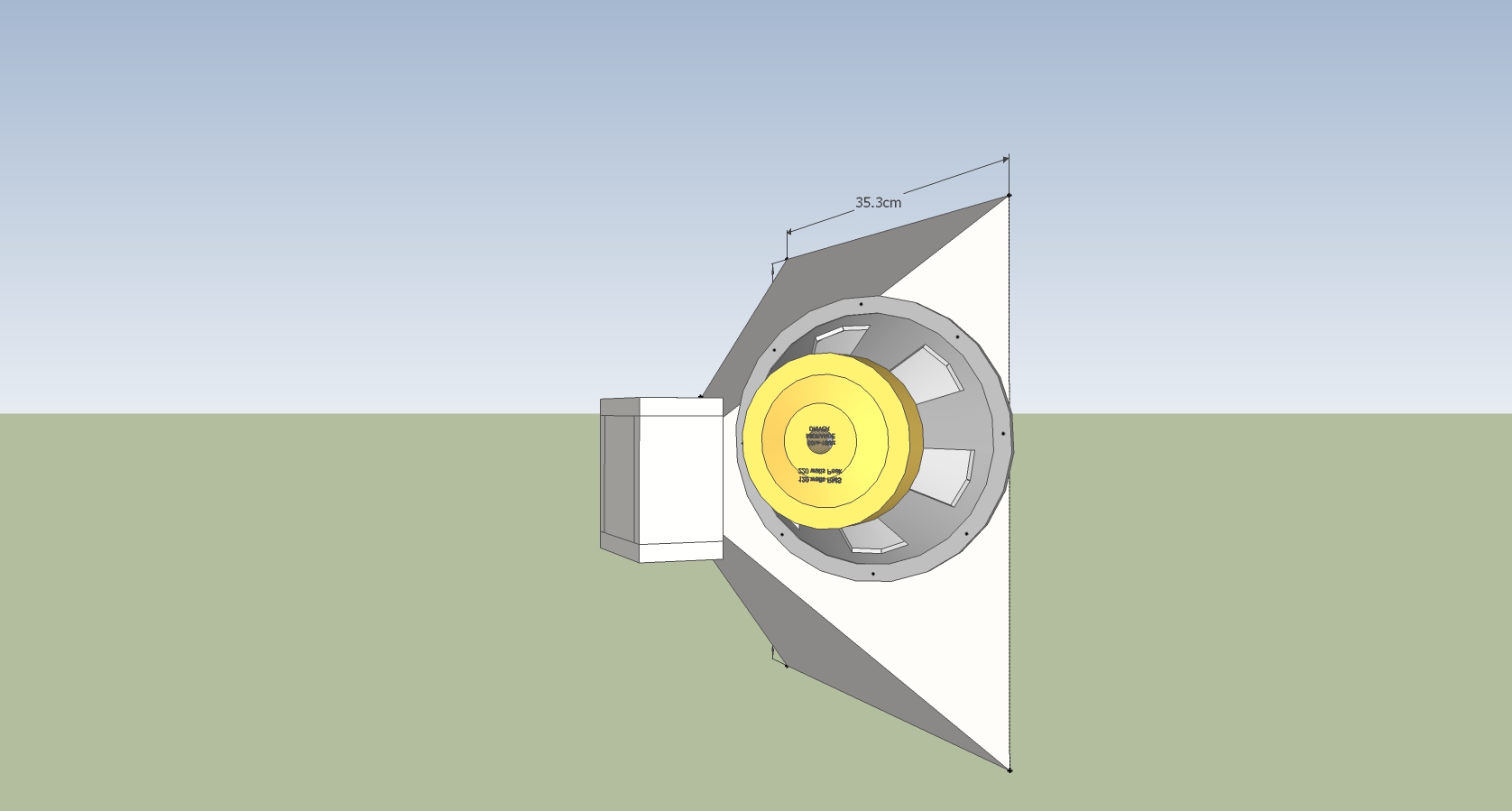

:eek: this one is ported, length port is thickness wood. I think rear chambel of 45 liters is to small when make the horn, I have just to drawn it.
By the way, I need nod so low, I make a horn who go 70 a 80 hz to 20 Khz.
but way different outcomes betweet akabak and hornresp, help David:confused:

Don't compare the acoustical pressure from akabak to the acoustical power from hornresp. Akabak can show you acoustic power also - its on a different screen/tab. You should be able to export an akabak script from a hornresp 2 pi simulation, change a couple of akabak parameters noted in the exported script and get the same response from both simulators.
Hi Kees,
Make sure that you are not confusing acoustical power response with acoustical pressure response :).
The on-axis pressure response extends to higher frequencies than the power response due to directivity effects causing "beaming" of the radiated energy.
Hornresp and AkAbak power response results will be identical if the two sets of input parameter values are the same. The pressure response results may differ at higher frequencies due to the different directivity models employed. AkAbak uses a relatively simple "radiation cone" method.
Both programs have the limitation that the driver diaphragm is considered to be a rigid plane piston at all frequencies, which is unlikely to be the case in practice.
Kind regards,
David

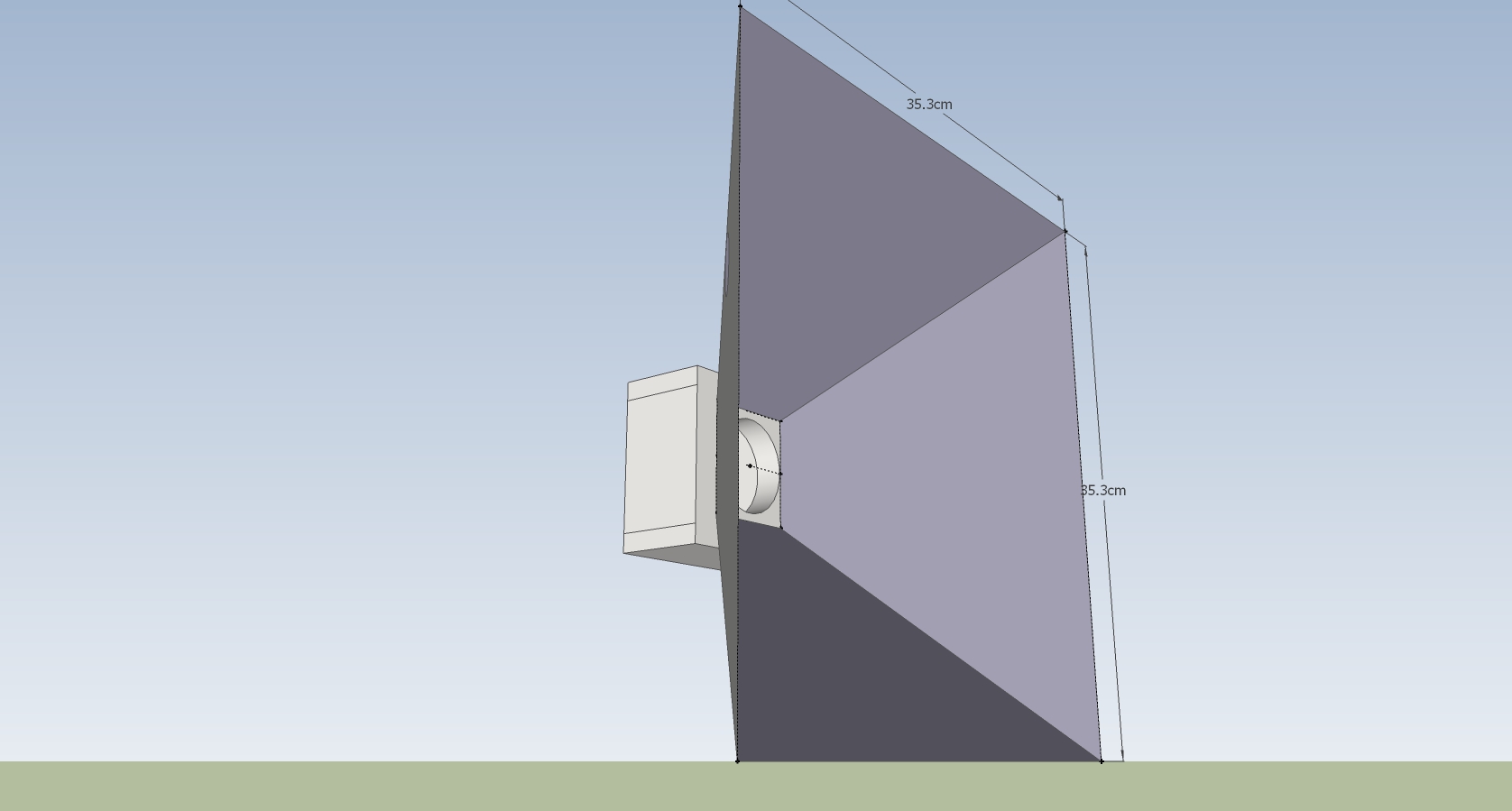

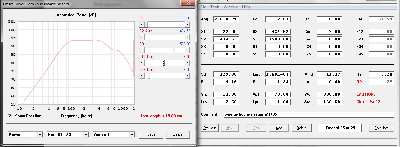

I do not understand my sim go as high with a portdistance of 7 cm from throat, something has to be wrong with that or the speaker has weird specs.
Hot to measure the portdistance from throat? from center of horn to panel or just across the panels itselfs if I do explane it right.
Ohh the horn is to small for 8 inch woofer but a 6.5 inch fit well, like that visaton who also do good.
regards

the picture you've drawn is a front loaded horn. Not an offset driver horn. Only when the driver is mounted on the side of the horn (on the flares) does the distance from the throat matter. In that case
1. draw a line on the axis of the horn,
2. draw a 2nd line perpendicular to the axial line to the center of the port hole for your driver.
3. The distance from the throat is measured from the apex of the horn to the intersection of the two lines.
After you create your simulation based on the geometry of the horn and this distance, add the acoustic path length of your CD to the L12 parameter (in the CON box on the 2nd row of the input parameters screen. This will give you a better prediction of where the acoustic null due to the reflection from the apex will occur. Values for several popular CDs, about 3 cm, can be found earlier in this thread.

I have did a ND for the compression driver as seen, and a OD for the bas/mid speaker, but when I do also a OD for high driver I do not get much change. Do you sim
also front loaded horn for high and a offset horn for the bass/mid?
here a example drawn, I do need look, I have tryed in akabak to get the power sim like in hornresp but do not now how. I need two 6.5 inch woofers to fit this horn or make it bigger, but then respons get more bad.
Still with the ports such far from apex why I get respons to above 1000 hz?.
I did want to make 60, 90 horn but export this in hornresp make strange apex dimenson, (more a gap), yes I need some more playing with it.
regards
kees

OD will show response fairly high; you'll just see a notch in it at the frequency corresponding to 1/4 lambda from the apex (inside the HF driver). The mids will roll off due to the acoustic low pass filtering of the front chamber and port, if you model them.
regards
kees
yes sim the highs as FLH
I do know the tab is there, the problem is to find it. (timeout to open akabak which is a pain on my 64-bit machine and figure it out again) Look on the top row tool bar. Click on "sum". Acoustic power and acoustic pressure are the first two options

I did see in hornresp that under tools there is a xhamber type, when I do lined then it do not go to 1Khz anymore, when choose ported it do go to 1 to 1.2 Khz.
little confusion.
NC535 I go look at akabak where it is, but in hornresp there is also this possebility to put it acoustical i did read somewhere
I have found it and try it, and yes then it predict like hornresp.
regards
when you choose "throat ported" in chamber type under tools, then you are modeling the volume of air trapped between the cone and the wall of the horn and the port through that wall into the horn. This acts like a low pass filter. The following four paramters then become important and will determine the high frequency response: Ap, Vtc, Lpt, Atc. Definitions are in the help file. You play play with them using Loudspeaker Wizard.
Hope that helps
Hope that helps
thanks, now I understand, yes some drivers in the synergy who has to do low end needs sometimes that ported throat as extra for the early fall off.

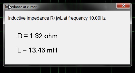

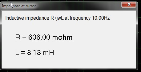

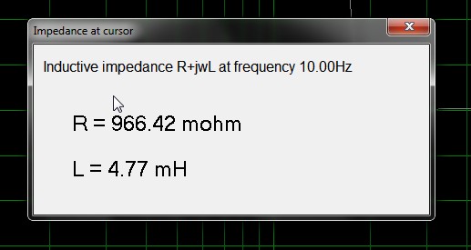

Little out of topic but I did measure with limp some speakers, but no succes, jig is oke, I use headphone output on pc intern audio.
just every measurement differend outcome, I did a coil measure, coil is 6.8 mH, just one measurement was right, I did also measure a reference speaker, way out of specs, I can not trust that for making a synergy..
