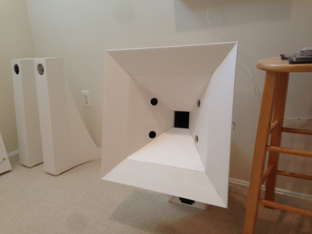

I have drawn the horn but is is short, but very wide, (1 meter), with heigh is 10 cm.
I do try more height to see what happens, I do not understand the throat is so wide, while for he high it is much smaller, hornresp do take this with them
regards
That looks like a Danley SM100 style "waveguide" given how shallow it is. Does HR predict off axis polar directivity?

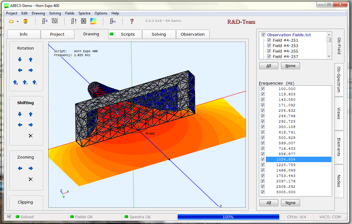

I was just checking out ABEC3 (the 3d FEA acoustics modeling package from makers of Akabak) and it seems to be really what I need to start using to model horns properly. Especially if one wants to take into account finer details like phase plug geomtery and accurate polar directivity. Here is a screenshot of the calculation of a sample exponential horn with ABEC3. It is a complex package but appears manageable given all the examples provided and it is GUI based (there are still aspects that are script based though).
There is no question of whether it is plane wave or isowave - no assumptions as this is boundary finite element solver.
ABEC3 - Demo Version
If you are a student there is a non-commercial license available.

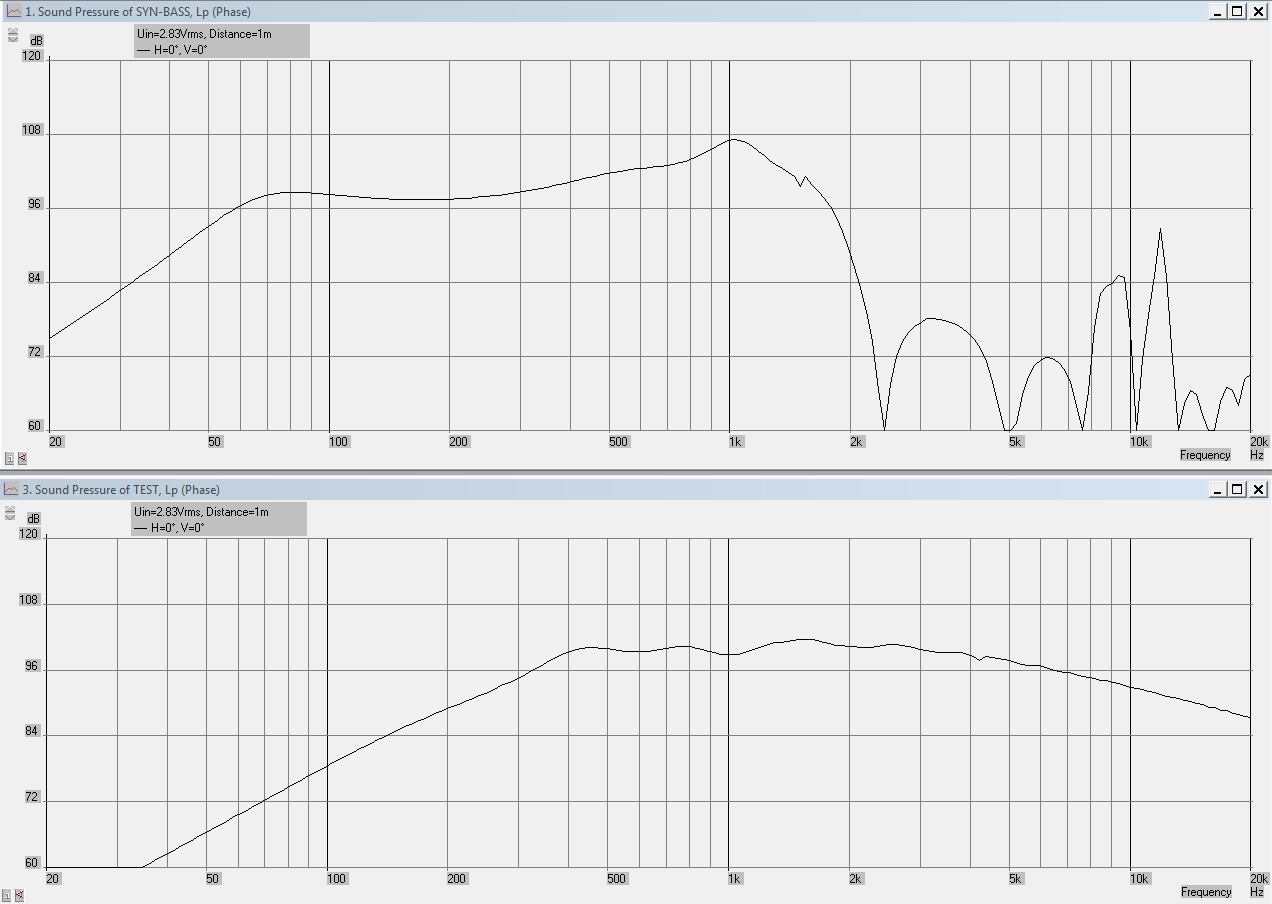

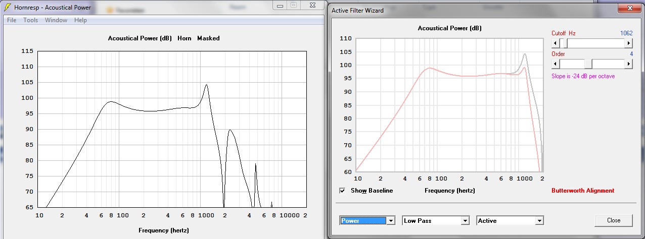

I have did a sim this time with corrected horn incl tweeter section, then I get a peak on 1.1 Khz. but with filter it can be removed.
I think woofers 6 to 8 inch with heavy cone and a tweeter with FS of 500 hz wil do nice.
making the horn is more difficult but use thin wood panels wil do by glue the on each order to make a thick exponential panel, under and upside is flat wood, witj conic flare.

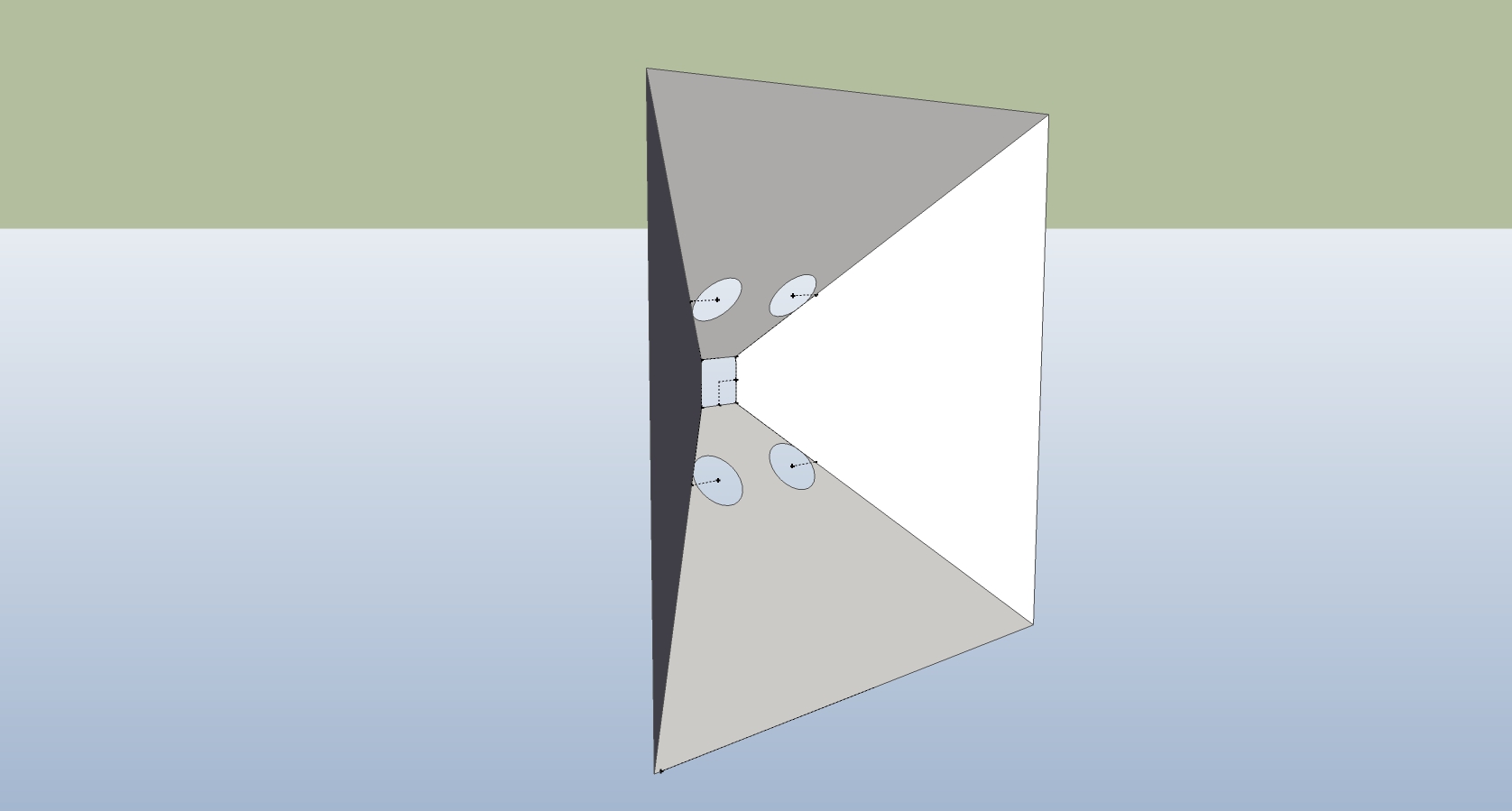

Can you show drawing with where your woofer injection ports are located? I don't understand what you mean by adding tweeter section to horn? The tweeter is at the apex and that is in the geometry already, no?

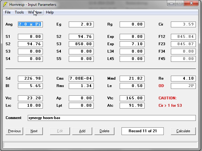

Yes tweeter is where the compression driver is normally, bass port is 8 cm from
compression driver, in my case a normal tweeter and has 165 cc and is 1.80 cm long, (thickness of used wood.) back is closed if I interpretere hornresp right, (I'm quite new in speaker thingies).
I do see it is a strange horn, 1 meter wide and 10 cm high, it is even not possible I think so I maybe need conic for all parts to fit woofers. I think ports are in the middle on both conic panels as I see it right in hornresp, I do not now what happens when in corners, hornresp do not sim that.
Maybe i have highjacked hornresp to improper sims, same for akabak.:D
see picture.
regards
I have drawn a conic version who do also work oke, these has a cone tweeter from visaton and the two phillips, however the phillips are a little to big so need a longer horn (3 cm total).
Do not now if I need two holes each side or just one gap.
