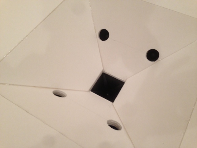

SH90 two-way in foam core
I am starting to prototype some designs in foam core. Here is a 90 deg horn with foam core TC9FD's for the mids/bass.

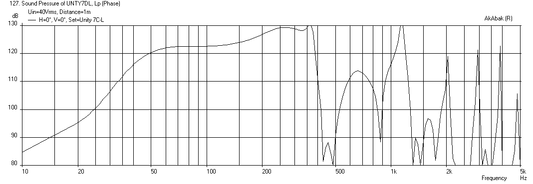

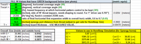

Chrapladm,
Here is what I managed to come up with for your 15 inch drivers (qnty 2). I ended up putting the bass injection ports at 14.5 in from the throat - you want bass ports to be farther out rather than close in. I had to put a big 3.5 mH coil and fat 8 ohm power resistor to tame the rising response but it is still there - so best to EQ it out rather than burn up precious watts on a resistor. I put this is a 38 in wide x 32 in high x 28 in deep box (3/4 in ply assumed) with qnty 3 x 6.0 in dia x 8 in long bass reflex ports. The bass driver injection ports are 3.0 in diameter.
Here is the input to the spreadsheet:
381761d1384203422-suitable-midrange-cone-bandpass-mid-unity-horn-sh-60x40-woofer-design-inputs.png

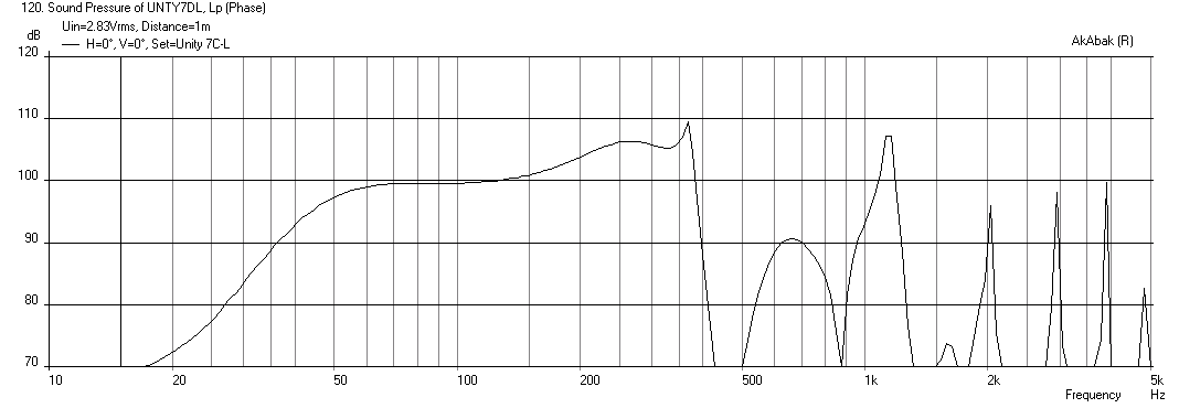

Here is the SPL vs Freq for 2.83V input - pretty sensitive speakers
381762d1384203422-suitable-midrange-cone-bandpass-mid-unity-horn-sh-60x40-woofer-freq-1m.png

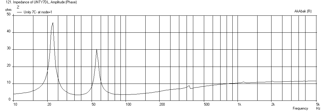

Here is the Impedance curve:
381763d1384203422-suitable-midrange-cone-bandpass-mid-unity-horn-sh-60x40-woofer-impedance.png

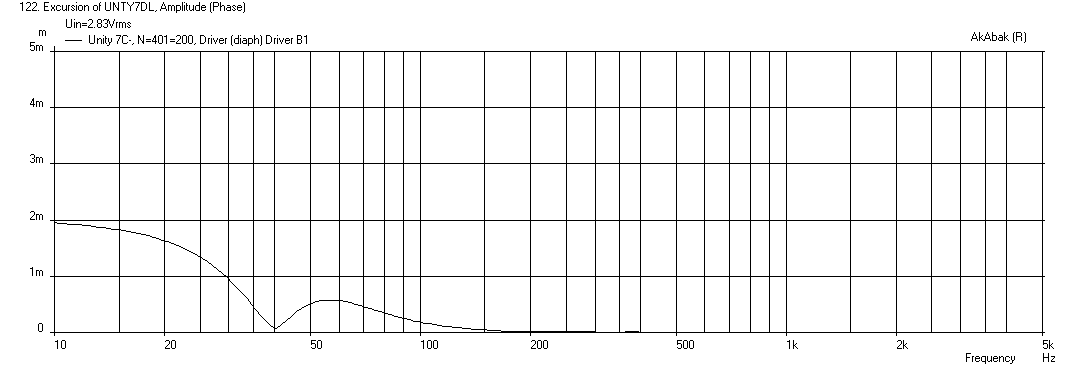

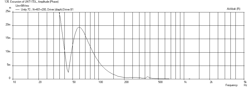

Here is the max cone displacement at 40 volts rms (really needs a high pass filter at 40 Hz):
381764d1384203422-suitable-midrange-cone-bandpass-mid-unity-horn-sh-60x40-woofer-displ.png

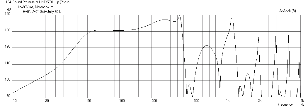

Here is the corresponding max SPL at max excursion (it will do 122 dB):
381765d1384203422-suitable-midrange-cone-bandpass-mid-unity-horn-sh-60x40-woofer-freq-max-spl-1m.png
At max SPL, there may be some port noise as the velocities are reaching 20 m/s in the ducts. However, I don't think you can hear that given the 122 dB from the main output.
This design achieves providing a high end up to about 350 Hz so that it can be integrated with a mid driver, it achieves usable bass extension down to about 45 Hz.

Will adding two more 15's smooth out the response or is the rising response something that will always be there?
These are the cheapest 15's I can get in OZ and still high quality. I was hoping for more SPL but it is what it is. In the end I think the combination of four mids, 1 CD and 2-4 15's will get me to 130db. I don't NEED this spl but want to have plenty of headroom. I also will be using these outdoors.
Thanks again for your efforts. Have a lot more to go reading wise but this is at least narrowing down what I need.
That rising response is following the rising acoustical impedance of the horn and will be there no matter how many woofers you use. No worries. As he said, you can EQ it flat.

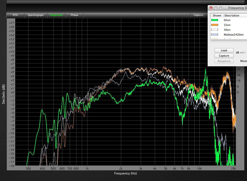

Patrick,
There are many one inch exit drivers using aluminum, titanium, and phenolic diaphragms that have more LF response than the plastic diaphragm BMS 4550.
The reduced SD of the ring radiator makes the HF peak higher, but reduces the LF SPL it can put out prior to distortion.
The examples below are BMS 4550 (50 on), BMS 4552 (52 on), Eminence PSD2002 (02 on), and a JBL 2420 using a Radian titanium diaphragm.
All the tests are on the same 13 degree conical horn.
The PSD2002 and the 2420 both have more output below 800 Hz than the BMS drivers.
Art
