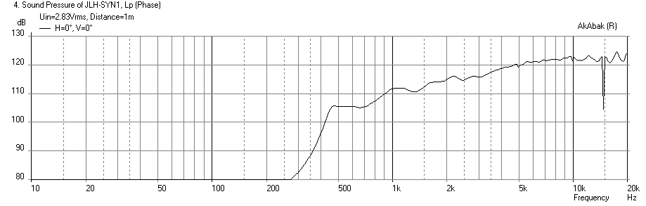

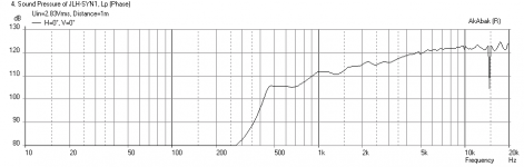

Thanks for the Synergy Akabak script. I just ran it and that is some crazy efficiency you have going on there in the high frequencies. With 2.83v input at 1m the highs are hitting 120dB! Is that correct? The CD will have to be padded down to match the 105dB output from the mids. How were you going to handle the bass below 400Hz - external woofer or in-horn?

Don't look at the acoustic pressure, look at the acoustic power. This will end up being a 3-way to fill in below 450Hz. I'm shooting for a low end around 100Hz.

The simulation in question was ran as acoustic pressure instead of acoustic power in Akabak. If the simulation is ran as acoustic power it is beautiful. Probably some of my better work.

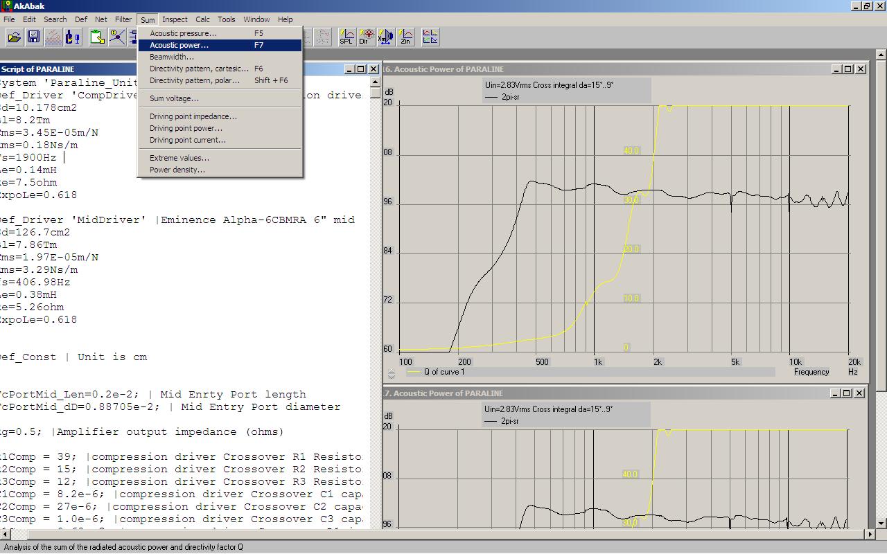

Ok, here is a stupid question - how do you get Akabak to calculate the acoustic power? There is a power spectrum dialog but it says missing input when I select it...

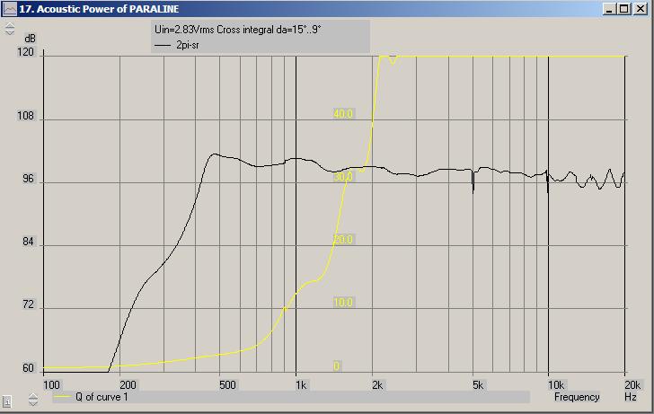

Click Sum from the menu bar at the top and select acoustic power. It should be the second selection under the Sum menu. With the scritp I posted, it should look like the attached graph.
If anyone is wondering about the spikes at 5KHz and 10KHz they directly correspond to the 3.5cm distance from the mid's cone to the mounting surface. This suggests I might want to add some poly batting around the port holes to stop this reflection. In addition, since Akabak is showing these spikes but nothing relating to the mid ports I'm confident the ports will be acoustically invisible to the compression driver as I predicted.
Here, like this
Ok, that works - thanks. Your Synergy design is very nice - flat in acoustic power. Now this begs the question: should we be designing for flat response in SPL (pressure level) or Power? I have been going the former route - and that appears to be how measurements are presented. Is the power what the ear hears for an even response across the frequency range? This is where room EQ comes in?
This still has me confused. Recall (per hornresp help) that "the constant directivity SPL response is also the acoustical power response" and vice versa. I think that means in this context that to the extent that the acoustic power is contained within and evenly distributed within the "cone" defined by the horn walls, the two are the same. If you've got flat power, you must also have flat pressure.

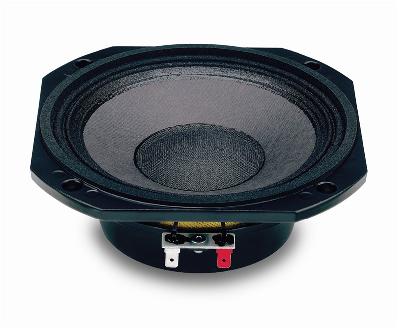

- Suitable midrange cone, for bandpass mid in Unity horn.
