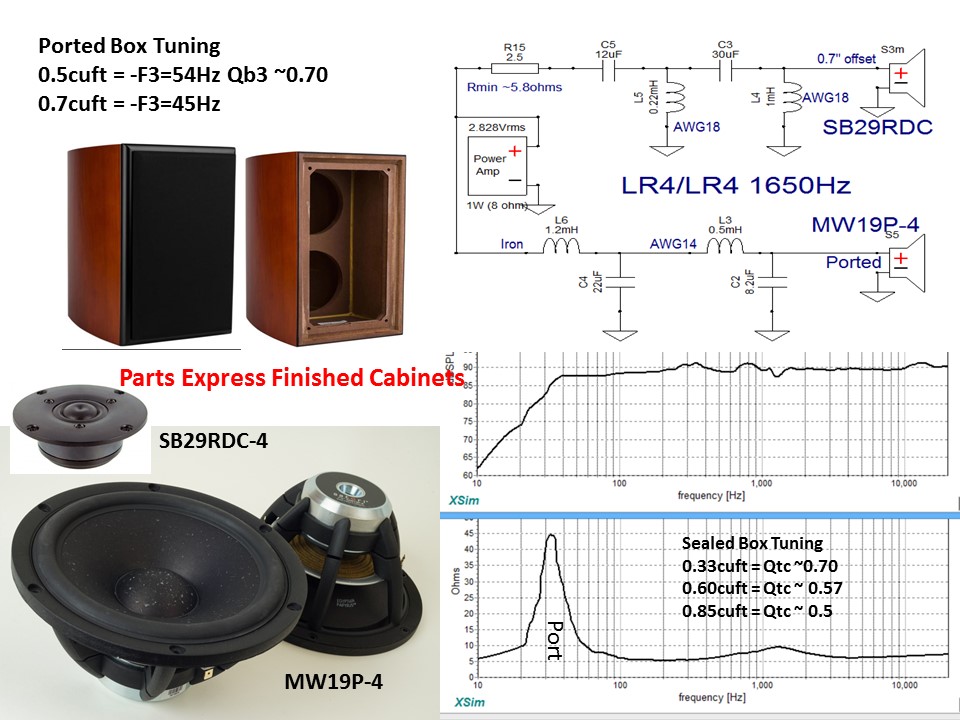

The normal "Pick two" can be difficult to balance,
1) high efficiency
2) small size
3) deep bass
4) tube friendly

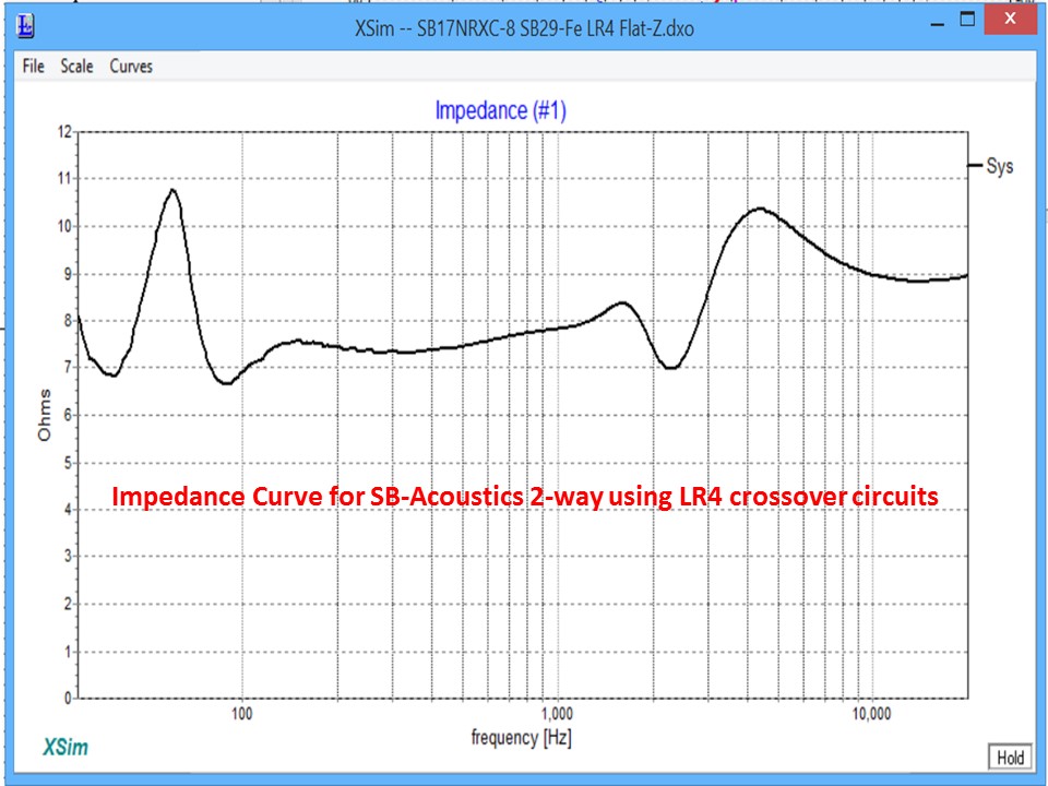

and adding Tube Friendly impedance requirements may place additional restrictions on the crossover circuit. Not impossible, but some sonic changes might be necessary. Curve: 7-to-10.5 ohms for the SB Acoustics TM with LR4 circuits.

DaveR’s XO yields a nice impedance curve. I think you just have to care.

90db efficiency is possible if 5-ohm amplifier loads are acceptable. Room gain plus desk gain will boost SPL at frequencies <200Hz.
See attached 7" Satori MW19P-4 + SB29RDC-4 tweet

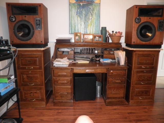

Picture of HarryY's office after 5 years of building tube amps.
