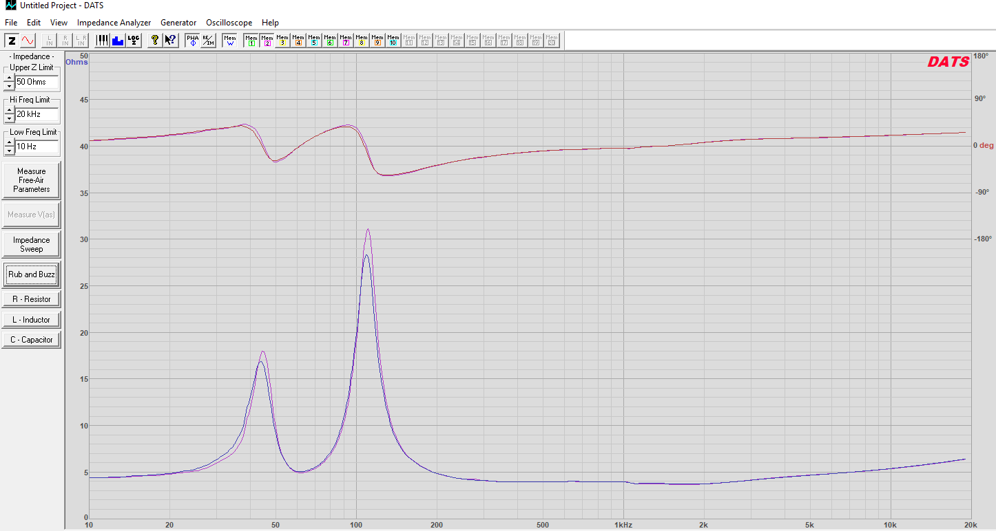

Mine are hooked up to a KT88 SE amp, which has 6 to 8 W output. The impedance load is very friendly for the tubes.
PM if interested.
Might even have the panels cut (need to be joined and box finished).

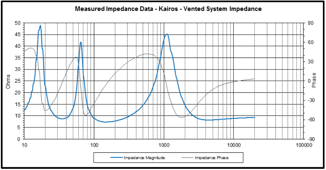

Satori Adelphos
86 dB sensitive.
This is the impedance curve from the similar Kairos. The tube amp isn’t going to get along with tha big peak just above 1 kHz.
SBAcoustics Mandolin
Cant’t find a sensitivity. Maybe as high as 90 dB but Jeff’s graph is a flat ~85 dB. Impedance cutve could have similar issues as above.
Indeed it is. Series?
dave
dave

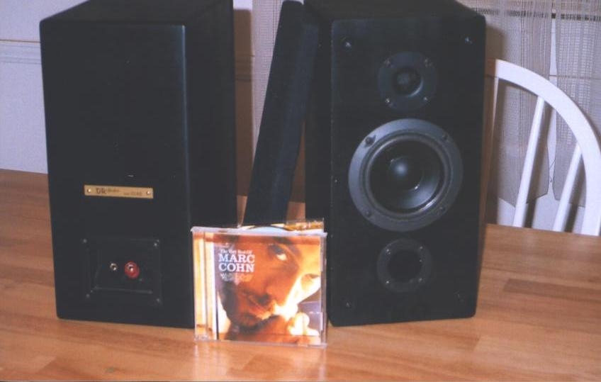

Yes series, you may recall hearing these before Dave. I brought them to VI diyfest a couple of times in the past.
Drivers are from about 12 (or 15?)years ago. Vifa/JBL midwoof 4-1/2" and Audax 3/4" tweeter. I would guess maybe 87 or 88 dB. Decent sound for their size.
