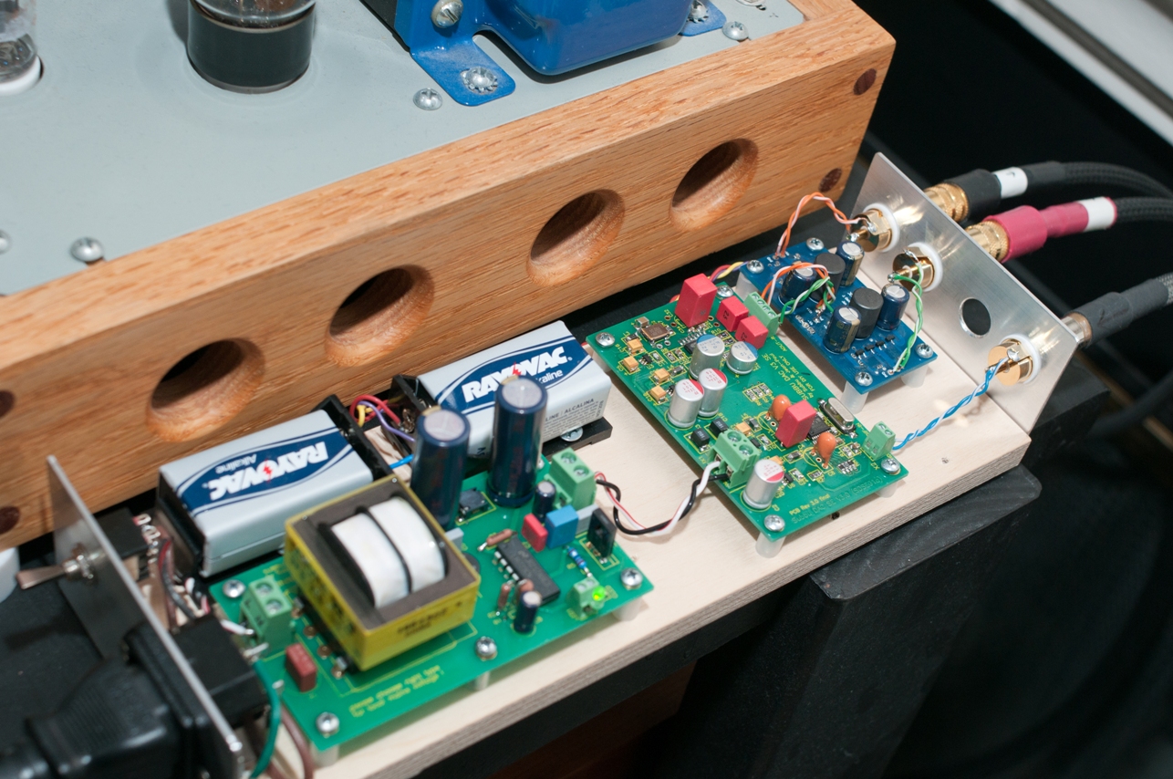

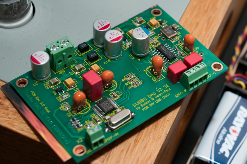

Sidney, can you report on any changes in the sound of the V3 with the JG buffer? A couple pictures would also be appreciated.
Bob,
The sound of SB v3 with the JG buffler/filter are more three dimensional and in a more relaxing way.
Sidney

Hi Sidney, you built the DAC just as we intended regarding wiring ! No 115/230 V wiring near in- or outputs and also short 115/230 V wiring close to the fuse/switch. You built layout may be used as an example how to do it right. I can't see the 115/230 V wiring itself clearly so I hope that is done right too (safety). Maybe you can post a picture ? And can you post your pictures in the Build thread too ? I think people will learn from your layout. I thought we designed it quite logical but a picture says more than 1000 words. Thank you.
