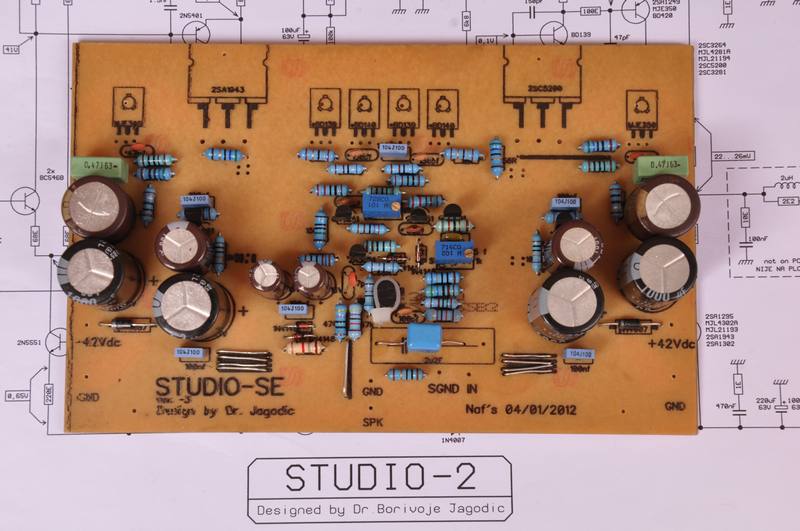

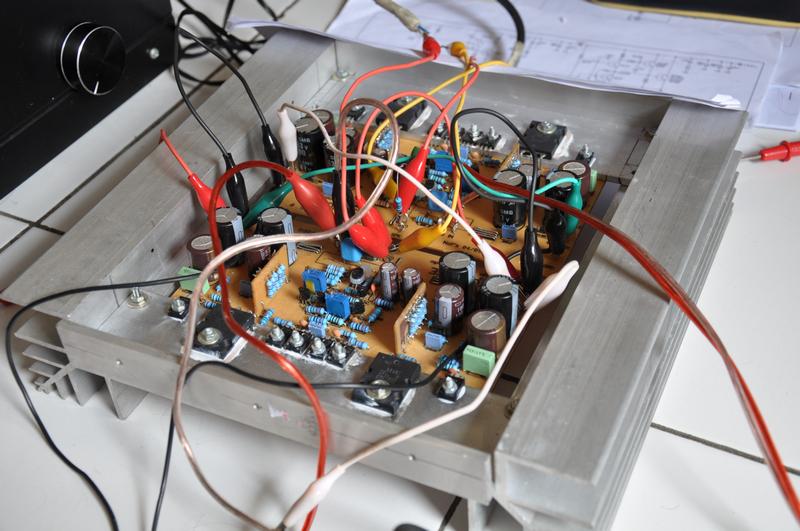

I'm totally agree with jmateus, this amp is very good (i build studio-se version), even i only build it with standart component. it's worth to build. It's sound very nice (nice bass, smooth treble, very detail). Picture taken a day before i finished my monoblock Amp.

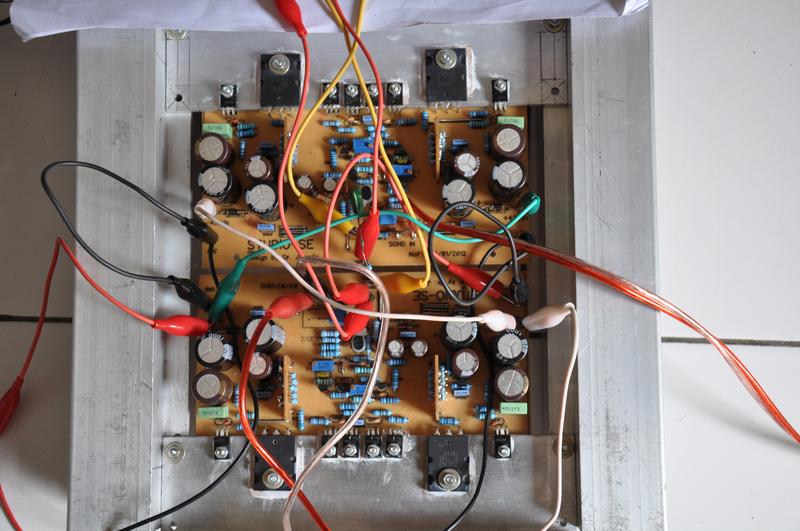

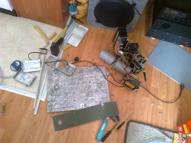

this heatsink is made of 2 L type heatsink screwed on another 2 heatsink to make it square (25cm x 28cm)
i buy it from my local electronic store, don't know where to buy online.
But are there whole separate heatsinks for each amp? Can you show them or have an image of them separate?

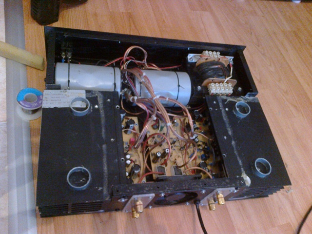

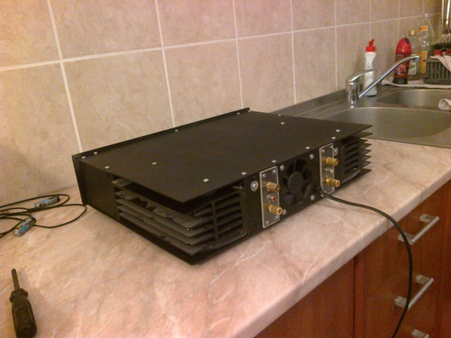

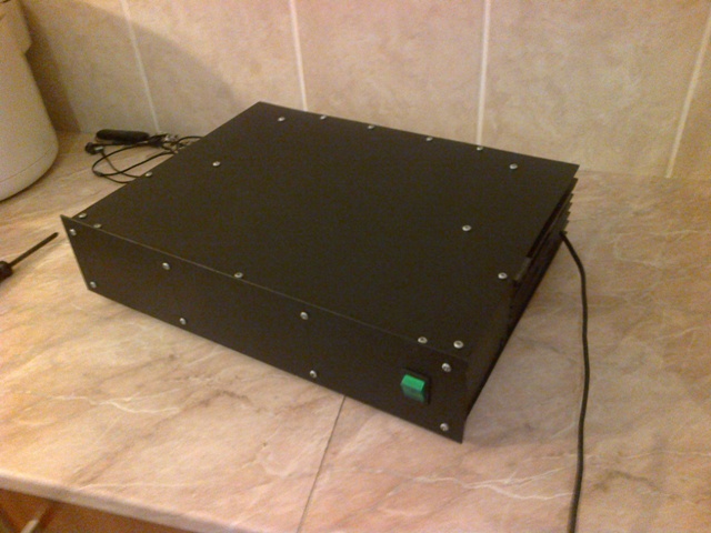

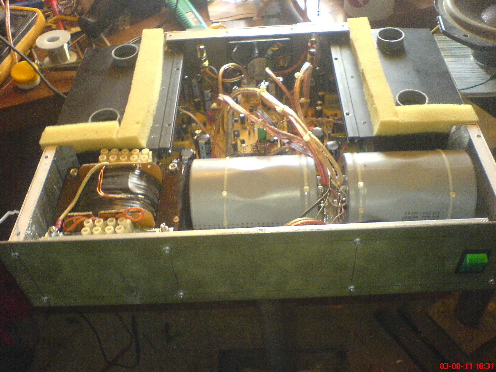

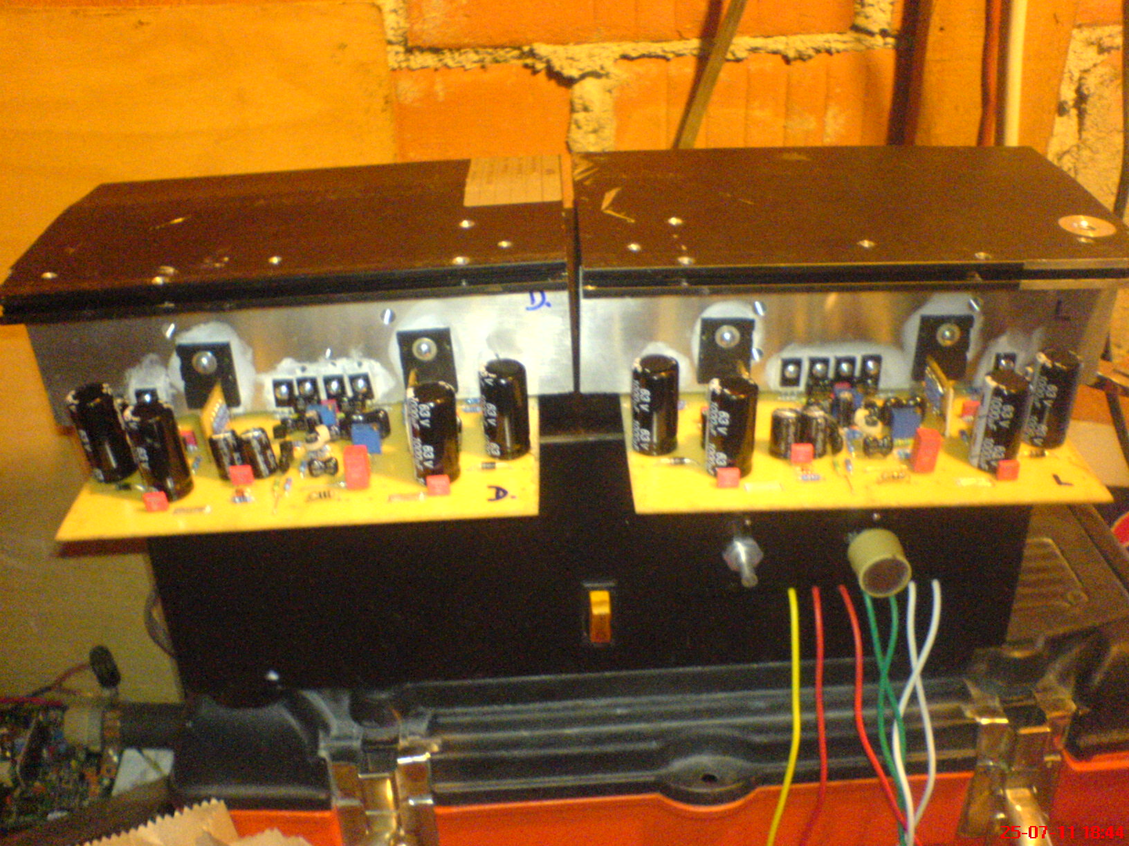

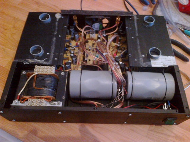

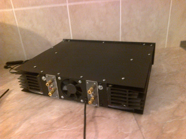

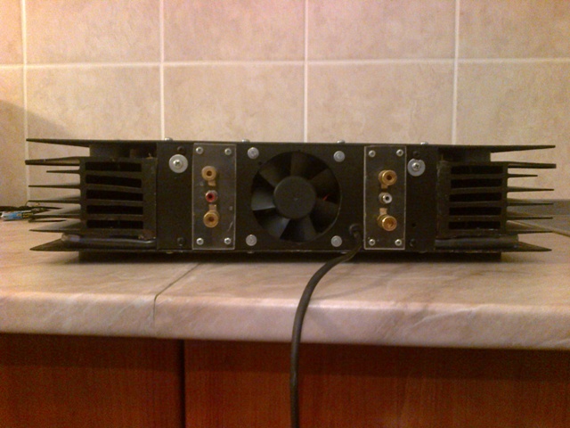

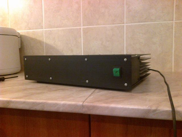

All the best about sound of this amplifier-not to complicated do be done,avaliable parts and realy realy great sound! You will think that somebody replaced your speakers for a pair of better one! I´ve assembled it last summer,but today it was painted and finished.
I´ve said it before and i will say it again:Thank you Borivoje!
