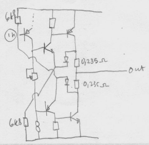

Hello everybody!
I am writing this to contribute and inform DIY community about another
design by Dr. Bora Jagodic. I found that thread on the best Croatian
Audiofil.net DIY forum two days ago, and I thought it is worth sharing it
with wider audio community. It is about his power amplifier design named
"Techno" that has been built and tested by well known and respectable
Croatian audiophile and DIY enthusiast "Dioklecijan" that he published on
Croatian Audiofil.net forum. My old friend from school, which speak English
better than me, helped me to make this translation of his posts:
"This days I've finished amplifier Techno with output stage done according
to schematics from Borivoje Jagodic. You can find that schematic on his
site: http://bas.elitesecurity.org/mojiprojekti1.html . Preamplifier stage
is my own idea with SMD OPAMP-s TLE2071.
Here are some photographs of progress of that project:

Some technical aspects:
Output transistors are ONSEMI 2SA1302/2SC3281 (thanks to "Pinco"), and the
rest is all according to schematic. Because those transistors have high GBW
it is necessary to put capacitor of between 150-330pF in parallel to
existing 10k resistor at the input of amp. Otherwise it might oscillate!
Everything else should be done by schematic.
Mains transformers were 29V/200VA per channel + separate transformer for
preamp.
Amplifier posses power in abundance. Control is immaculate, and in my tests
it was working with Focal Electra 1028, and with Electra 905, Diapason
Micra and JBL CM42. Amp is biased at 90mA and if anyone is going to build it
I suggest bigger heatsinks than mine.

Is this CCT contains EC? http://www.diyaudio.com/forums/attachment.php?s=&postid=1071301&stamp=1165127461
Look at the upper output stage. BD139 is forming left side differential. BD140 is forming right side differential (somekind of diode, because its C and B is connected by 10ohm). The CCS for these 2 transistors is 6K8. The BD139 is comparing its base (input) to it's emitor (output).
There are 2 threads, both talked about how good sounding this amp is, but none talked about what's making it perform like that.There are quite a few threads already about this particular design and its issues if one cares to do a bit of searching.
The front ends are ordinary, could it the output stage that makes it sounds good?
