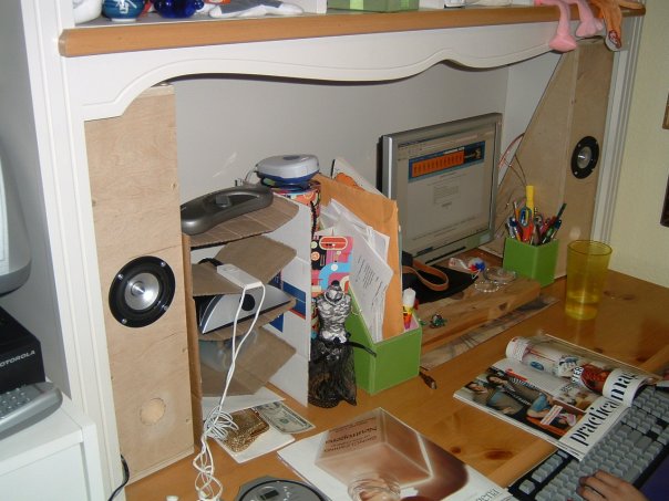

Just to let you know, I actually built a pair of the center version for my sister. They are now used as computer/tv/ipod speakers and they are coupled with the t-amp. They actually have good bass as long as they are in corners. In my parents house, they are the clearest sounding speakers we've ever owned. The system is really revealing showing a lot of faults in many recordings and broadcasts.
Overall greats speakers especially as a first builder.
(Notice the High Quality $10,000 HiFi Rack constructed from very expensive materials)

Nice !
I'm glad someone built those speakers and is satisfied with them.
This use as desk speakers is pretty what they could be intended for : not to big and good sounding in a small place.
Mine is still working as center speaker in my home theater.
But I still prefer the big ones I've built after.
