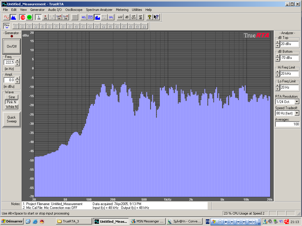

To finalize the cabinet, damp high frequencies and limit internal resonances (impulse response), I will have to use 0,08 lb.ft3 of internal damping. Is it a correct value ?

I realize that it is a little late making suggestions, but the last time I tried to look at your sims, I couldn't get in.
From your sims and RTA, I think that you are trying to tune WAY, WAY to low. A reasonable rule-of-thumb is to never try for F3 lower than 0.7*Fs, in this case 70-75Hz. When you have a spike at Fp, followed by a deep dip before recovery around Fs, this is a sure sign that the tuning is low. Try running a sim with F3 ~75Hz an a much smaller volume.
Yes, a stuffing density of 0.8 lb/ft^3 is too much. It is also indicative of a poor design. Once you design at a higher F3, you stuffing density will also go down.

The amount of stuffing is not 0.8, but 0.08, arround 0.1 so. It makes 1.2kg/m3 which seems not so big for me. Applying this, the frequency response gets almost perfectly smoothed, and the spike is a little attenuated, despite it's still here as I need it.
I know the simulation ( http://youyoung21147.site.voila.fr/data_satW3_871S_port.PNG ) looks far too bad tuned, but according to my RTA measurements, it should compensate the difference observed between the simulation and the real measurements, hence the spike, as the drivers seems to have wrong announced specifications. Moreover, it should somehow resolve the problem of baffle step without any electronic component.
You can see that this simulation, despite the big spike at 68Hz, doesn't go lower than the first one I did to build my center speaker. I tried to make a very low tuning which seems to work pretty well with the Cyburgs-needle enclosure, but with a dip that doesn't go lower than the driver's typical efficiency.
The only thing I don't really like in this enclosure is the quite big internal volume. If not correctly damped, it may cause undesired resonnances from the box itself.
I will draw the plans right now, and build the enclosure to give it a try.

I built a prototype based on the simulation this morning, in a folded configuration and I am using a brand new driver that needs to be broken in, its suspension is really hard !
The cabinet isn't even sealed, and there is no stuffing inside.
I didn't make any measurement right now, but I can already say that it gives a nice bass extension. Maybe linearity is a little worse but I get more bass.
I was afraid of "box noises" because of the large volume, but there is almost no box noise, mainly because the port is really large and therefore lets very much air pass without problem.
I think it's a nice enclosure but I need to make more measurements and finish the cabinet correctly.

I sealed the enclosure this afternoon and WOUAOUH !! it works exactly like I wanted it to work : it goes deep (70Hz -0dB) and mainly, the peak in the simulation exactly compensates baffle step diffraction, so I don't need any awful filter.
It really gives the punch that music needs !
I suppose building the second one will help increasing the bass response !
Here's a photo : http://youyoung21147.site.voila.fr/DSCF2747.JPG
Placed like on the photo, the bass extends down to 58Hz, then the awful JBL subwoofer under it does the job (only for the home theater, I prefer not to switch it on to listen to music. Grrr... How I hate bass reflex ! )
I publish the plans as soon as I have adjusted smoothly the port length, to give people the best configuration.
My RTA mesurements are not finished and I get some room resonnances so the response doesn't appear as smooth as it is, though I know linearity isn't as good as with my center speaker.
I have to try several positions and make an average, like I did for the center speaker measurements.
