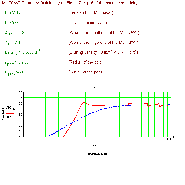

I'm doing the plans right now and I wondering where the port should be located, and if I can replace the circular port by a linear port, keeping the same surface and volume, because linear ports, which can be seen on most TQWTs are less likely to produce air flow noises than circular ports like BR.
You also told me the formula for length was not correct, then, I don't know if the length given in the geometry page of the ML-TQWT sheet (picture) can be applied to the straight face length, the tapered face or if this value is raw and must be corrected.

After many trials, and following joensd rules, I obtain something much better with no stuffing.
Although the results are correct, I wonder if placing the driver at 2/3 of the pipe will create an acoustic short circuit between the port and the driver, and therefore makes the simulation incorrect.

Are we talking about height from the base, or from the closed end? If it's the former, setting the driver at 1/3 pipe length will cancel the null at F3, but the geometry has an effect as well, as I'm sure you'll have discovered by now.
If it's the latter -well, none of the pipes I've built so far have needed the driver mounting lower than 1/2 length, though if required they can be mounted lower. I seem to recall Bob suggested such a layout for one of the larger Fostex drivers in a TQWT -FE206 or 207, I forget which, and that, with a line length of 60 inches, needed the driver mounting at around 26 or 27 inches above the base I believe (though I don't think he was overly enarmoured by the idea, frankly).
May I suggest that you are trying to force a driver into a cabinet that is not optimum? With the high Qts of the 871, you would be much better served by trying a negative taper pipe -- a more or less conventional TL. You have managed to smooth out the FR curve, but you have a huge peak at cut-off with a precipitous drop, and at a very unfortunate frequency. You are gong to have one-note bass that won't quit. Basically, the pipe is too efficient with too narrow a band width.
A technical note or two: It is correct to place the driver at 1/3 the ACOUSTIC length of a TQWT in order to suppress the third harmonic (first overtone). However, with a zero So pipe, this is 1/2 the PHYSICAL length of the pipe. Reducing the port area causes further movement of the PHYSICAL position of the 1/3 wave length.
Placing the port, circular or slot, up from the bottom of the pipe smooths out the FR curve. Particularly with a straight pipe, there are very strong 9-13 harmonics. moving the port so as to suppress the 11 harmonic, along with slight movements of the driver position smooths the the entire FR curve.
Bob

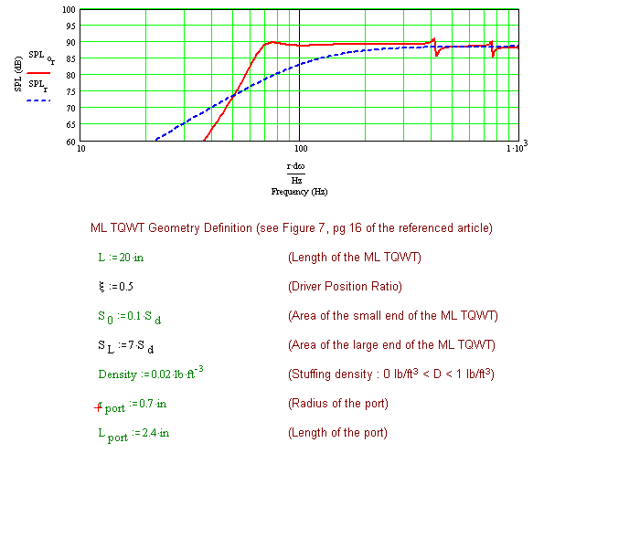

You are right Bob ! I were trying to force it because I didn't notice the length was so important, as I have the metric system in my contry. I know it has a high Qts not very suitable for a QWT but I'll manage with it. Anyway, the Fostex are worse on this point.
These speakers are intended for Home theater applications, so I have a subwoofer which I would like not to use above 100Hz because it's a **** from a cheap JBL kit, so I don't mind if the FR draws a cliff after the F3 point. But I know loading a speaker too much makes it "slow" and "soft'
I have made new trials and the curve I obtain is better, and still goes under 100Hz.
I also tried inverted taper but it doesn't give good results.
You tell that the height of the port has an importance to cancel undesired resonnances, so is there a formula or something else to calculate this height ?

Ok. Use metric units in you simulation. Mathcad actually works in metric anyway. Then you won't have problems trying to visualize English lengths.
To see what is happening in the harmonic structure of the pipe, you need to look at the port/driver response, which is two graphs farther down the page. You will see that you don't have the 3rd harmonic completely suppressed. As to the higher harmonics, I'm afraid that the 9-13 harmonics may be off of the graph to the right because of the high Fp of this pipe. It is no big deal, though, since frequencies this high are easily suppressed by the stuffing. Just center the port 5-6cm up from the bottom. (You will need to use the "ported" worksheet to adjust the port position. You can do it with the "sections" worksheet, but that is a pain.)

I think I've got it now !
Moving the port 3' above the bottom linearizes both the far field FR and the port output.
I'm ready to do the plan but I still have, I hope the last, question : when you give Mathcad the length of the TQWT, what is it based on ? Is it the total length of the line following the internal face that holds the speaker, or the tapered face, or an average of both ?

I usually set the length equal to the average, the line down the middle of the TQWT areas.
How do these graphs compare to the MathCad model of your first speaker. the one that you built?
Also, remember that these calculations do not account for the baffle step loss at low frequencies so you may still need some form of corrections filter.

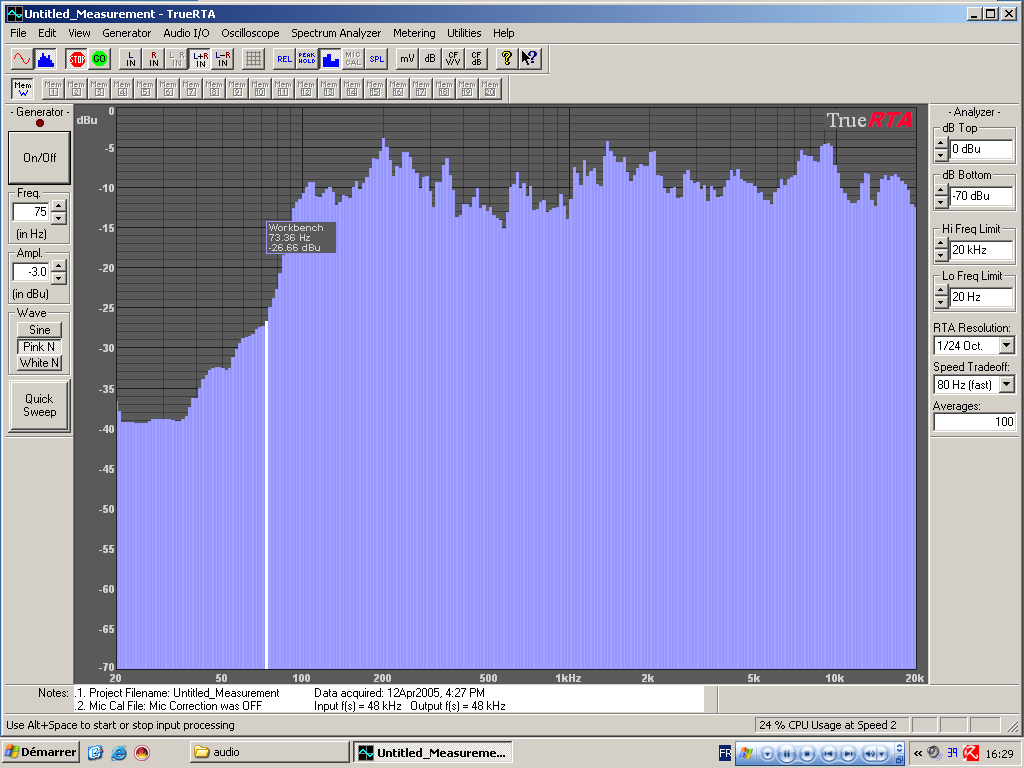

I've just built the enclosure this afternoon and made measurements
As you can see on the FR graph, linearity is excellent but the bass response is quite far from the simulation, although my cabinet is not well sealed and the port made with a thick Bristol sheet at this time but I know I won't be able to get the expected response anyway.
I think this enclosure will be perfect as a center speaker, designed to reproduce voices and not bass :)
