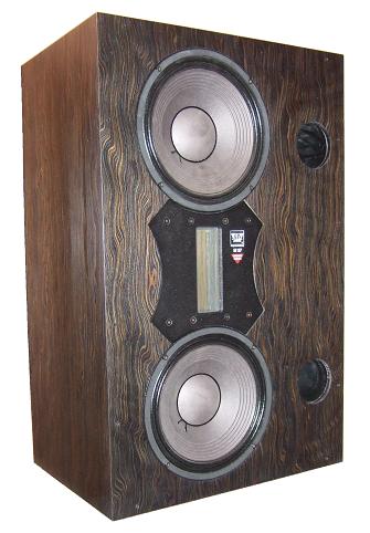

The "Planar Face Plate" (front plate), for use in the M57 and M59, can only be used if the terminals of the RCD have been modified (see attachments).
The terminals are also equal to the terminals used in the Screen RCD.
These terminals are shortened and equiped with an allen head bolts.
The allen head bolt can be reached by the two holes in the front plate.
The SA 8535M, used in the M57 and M59, has allready this modification.
Prices: SA 8535M: € 549,00 and front plate: € 87,00
Now I have understand the correlations.
Here a test report from the M57 from the german magazine "Production Partner"
http://www.stageaccompany.com/download/files/PP-m57.pdf
But there is an additional difference by SA8535 between the pictures of the M57: left with diffuser and right without.

In the moment a friend of me are looking of a SA8535 Version from the M57 (see small image above).
About the URL
Q: How many different SA8535 Ribbon Compact Drivers are there?
I read follow:
There are seven versions of the SA8535 RCD, see the list below:
SA8535 Standard - basic RCD without horn (e.g. used in the E24).
SA8535 Cinema - same as the standard, but with: different terminals*, stainlees steel mesh screen, horn gasket and screw threads in topplate (for use in the Screen Series).
SA8535 L - same as Cinema, but without screw threads, and with extra topplate inserts for better horizontal diffusion (for use in the GL20).
SA8535 C - standard, but with stainless steel mesh screen and horn (for use in Leader and Champ Series).
SA8535 P - standard, but with spoilers (for active cooling) and horn for use in Performer Series.
SA8535 XL - standard, but with wave shaper for use in AH36.
SA8535 M - same as Cinema (Screen) driver, but with an extra 5mm thick aluminum front plate, and sometimes equipped with Contrad foam wedges (for use in the Master Series, models: M57 and M59).
