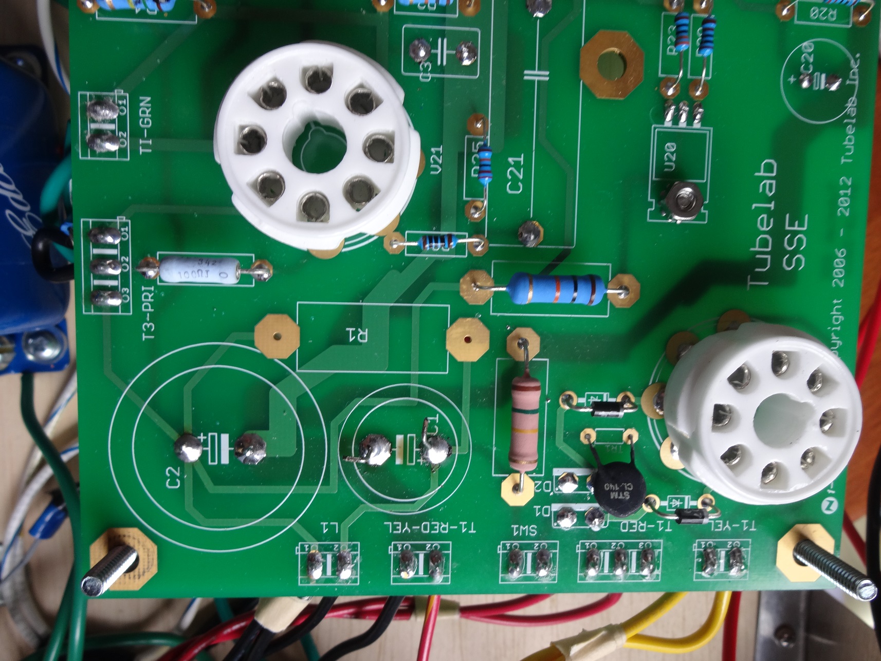

It is one channel. My nine pin socket is of poor quality. Very hard to get tube in and moving board( as to get readings from resistors on bottom) loosens tube.
The B+ at R4 is zip nil. At L1 it is 420.
R17 is nil.
T3 is 409, T2 is nil.
Preamp tube 12at7 pins 1 and 6 are 231 and 238. Pins 7 and 8 get static at touching.
V21 pins 3 and 4 are 408 and 409. V11 nil all pins.

Check around C2 and make sure the hole for the + capacitor lead of C2 is plated all the way through.
B+ for teminal block 3 comes from the TOP side of the C2 + lead. B+ for terminal block 2 comes from the BOTTOM side of the C2 + lead.
edit: since you have reversed your board, I think, power for your terminal block 2 will be at the TOP of your board, underneath the cap C2. Since you have no B+ at R4, the + lead of C2 where it passes through the board, is almost certainly your problem.
But since you have moved C1 to C2 position, I'm thinking that + hole did not plate through. You seem stingy with solder ....

The + lead of C2 distributes power to both top and bottom sides of the board.
At present, you are only getting power to one side of the board. The side of the board that has the traces for R4 and the terminal block for OPT 2 are not getting power because the + lead of C2 is not connected to them.
The power traces for the CCS for that channel are on the opposite side of the board and are getting power from C2, as is the rest of the board. Fix the C2 pass through and your board will work.

Picture 1 is your board as uploaded by Gcom. If you look closely, you can see the shadow of the trace on the opposite side of the board that is not getting B+.
Picture 2 shows where i have used orange highlight to show the path of the dead trace.
Running an insulated wire from the + terminal of C2 to the pad of R4 nearest the edge of the PCB will bring your dead channel to operation and properly elevate your heaters. if you like, you can use that unused pad for R1 that is connected to C2.
