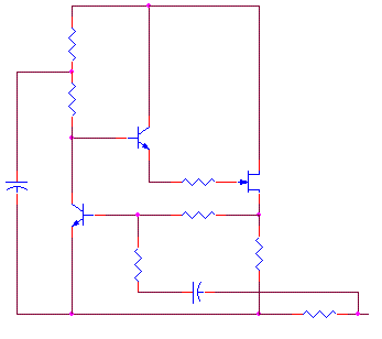

I suggested there was a way to allow the Aleph CS to operate with the lower threshold SS devices. I couldn't find any of that discussion so I made a picture. I'm not saying this would be better, or not, than the MOSFET solution but it's an idea. I'm sure you recognize most of the circuit below? But, there is an extra transitor.
The problem is that the govonor or regulator (it also sums the output and the Source resistor signals) transistor has to work with the output FETs Vth and RSource drop as its Vce. But at about 1.25V + .6V or so thats not very good. The extra transistor allows the govonor to have about .6V higher Vce. It operates as a follower and should not add much, if anything, bad. I havent actually built or simulated it but it should be close to solving the problem. If not, maybe a ZVN3310 or some small FET in it's place will add 4V to the govonor's Vce.

Thank you for the effort. I have considered converting my Aleph J to SS on the bottom, but not interested in that as much now. Looking for different types to compare sounds. I am seeing more and more that the difference between the ACS and the Mu follower is not so great, but still significant enough to warrant different design to optimize parts. Got my R085 SS fets today. I will try them in the F3 before moving on to SE Mu follower. I have FR drivers so SE has an appeal. Maybe no difference. We will see. Interesting to note that Nelson thought F3 was sweeter sounding than J2 or AJ. Guess I will know what he means soon enough. LU F3 then SS F3 then SS MuFollower. Hopefully will learn something before all is said and done.

I think I get it.
You will want to provide a path for that transistor to have some bias current.
Between its emitter and output would do it.
