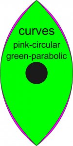

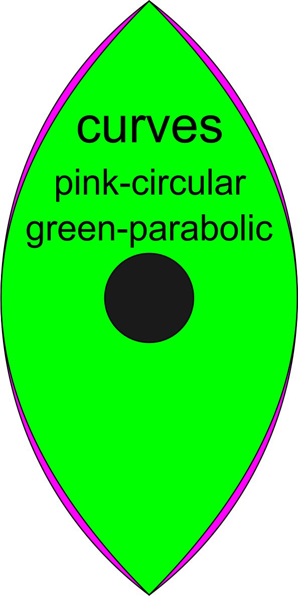

4. not all but most of D.I.Y. paralines I have seen on net use "overlaping circles" approach to design "eyeshape" for paraline device. Overlaping circles give us "circular curves" while for "real" paraline we need PARABOLIC curves. Those shapes look very similar but they are different in some places. This difference looks just slight but can bring pathlength difference of several millimeters in practical device which can change things up above ~10kHz pretty noticeable.
In attachment, there is circular eyeshape overlapped by parabolic eyeshape of same height/width proportions so ones of interest can see areas of difference.
hehe :) .. but.. theory.. ahh..
Do you also have chamfered edges of center paraline piece to maintain cross section area?
(I see you noted example C. not B. .. but just asking to be 127.4% sure)
Yep, that's why I said C ;).

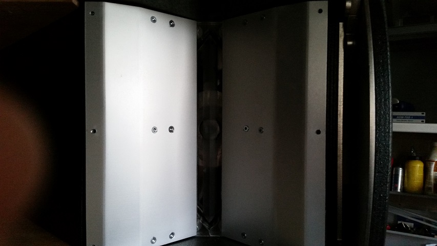

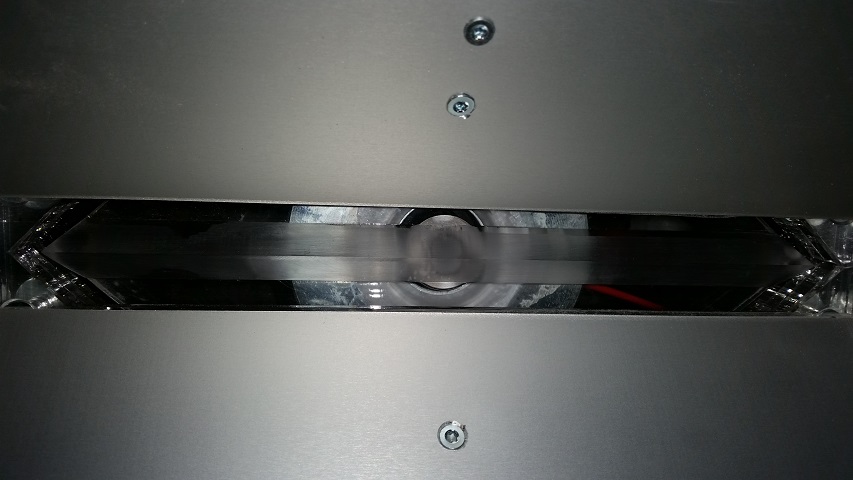

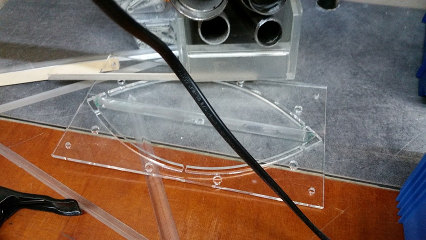

Hi all!
At first i must apologize if i mess English language as i'm not English speaking and going with plain elementary school basis..
About paralines.. I wouldn't judge it as having an ugly responce too hastily!
I came to know about paraline waveguide somewhere around winter 2014/2015. As i had motive of replacing the hf waveguide of some old retired line array boxes to something more up to date as a learning process i started investigating this device more closely and now i'm at the stage of 2. prototype.
These boxes are old and have no use other than this educational project.. Also i'm not able to keep this project in very high priority. I'm merely fiddling and spending time when i feel like it and learn some valuable lessons while i'm at it.. :)
The prototype is made out of 5mm plexiglass layers and laser cut which turned out to be surpricingly fairly priced.
The eye shape, i think, is quite near overlapping circles (anyway the shape was determined by a+b=c+d..etc. since these pl's are meant to be used in a line-array.. The eye shape mostly affects wavefront shape at the exit so it should be chosen by that criteria..). This particular shape gives parabolic expansion to wavefront inside paraline device. (because we are dealing with 360deg radial horn bent to have rectangular mouth with equal path lengths at the exit..that gives us parabolic expansion if we 'dismantle' the expansion in paraline..)
These are not yet perfect..Eg. they are not currently glued/sealed at all..nothing is rounded and the driver screws are completely exposed to audio path on the first plate although quite nicely recessed phillips head screws. This means also abrupt turns. The laser cut surface is very good and the plates fit so well that there is no leak when bolted together around the 'assembly'. Eventually these will be glued, etc..
The 5mm plexiglass was chosen to meet theoretically 16kHz upper response limit (thinking more with 1/4 wavelength than 1/3..)..so in theory according to paraline patent the abrupt corners shouldn't have room to affect response..

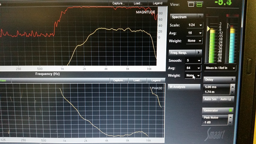

These are just *very* quick fr measurements measured on axis paraline bolted on 90 degree horizontal waveguide giving total path length of about 19cm. The whole 'assembly unit' was dropped into it's place in original speakerbox. Maximum 5 minutes spent in eq:ing (xo near 2kHz, some quick cd correction, few eq dips and bumps. All done in smoothed view and should be done better some time later as can be seeing in unsmoothed response graph!) Power level not calibrated nor the meas.mic gain other than to excite the speaker some and get nice coherent fr and phase resp.). Ah..the driver used is BMS 4552.
Meas.mic distance about 40cm from speaker (speaker height at about my head level from ground), outdoors but a little bit noisy environment with some potentially reflective surfaces nearby.
The response looks promising..! The tricky part was to understand the throat (one should not have the acoustical impedance to change too much at that point! I think 5mm material thickness simplified the construction quite a bit [doable also on 4mm, but not easy on 6mm..] and how it should be done and that seemed to make quite a bit of a difference. I think the throat and coupling to the driver turned out quite well..
The scale on fr is 3dB/div so +/-1,5dB on intended fr range. Also quite usable phase response in the same range (As one can see, the 2 peaks on unsmoothed graphs having also almost perfect phase shift, so they should be eq'able.. and i'm not convinced that they aren't consequence of my hasty eq's on smoothed graph..! :) )
The smoother fr graph is havin a smoothing of 5 and the other one has no smoothing.. The magenta curve on processor setting is the one that is being used (the other graphs are just other channels not being used).
I'd conclude that there are not too much of nasty things going on inside the paraline, once it's crafted with attention to detail and material smoothness!
Br,
Jani
Jani,

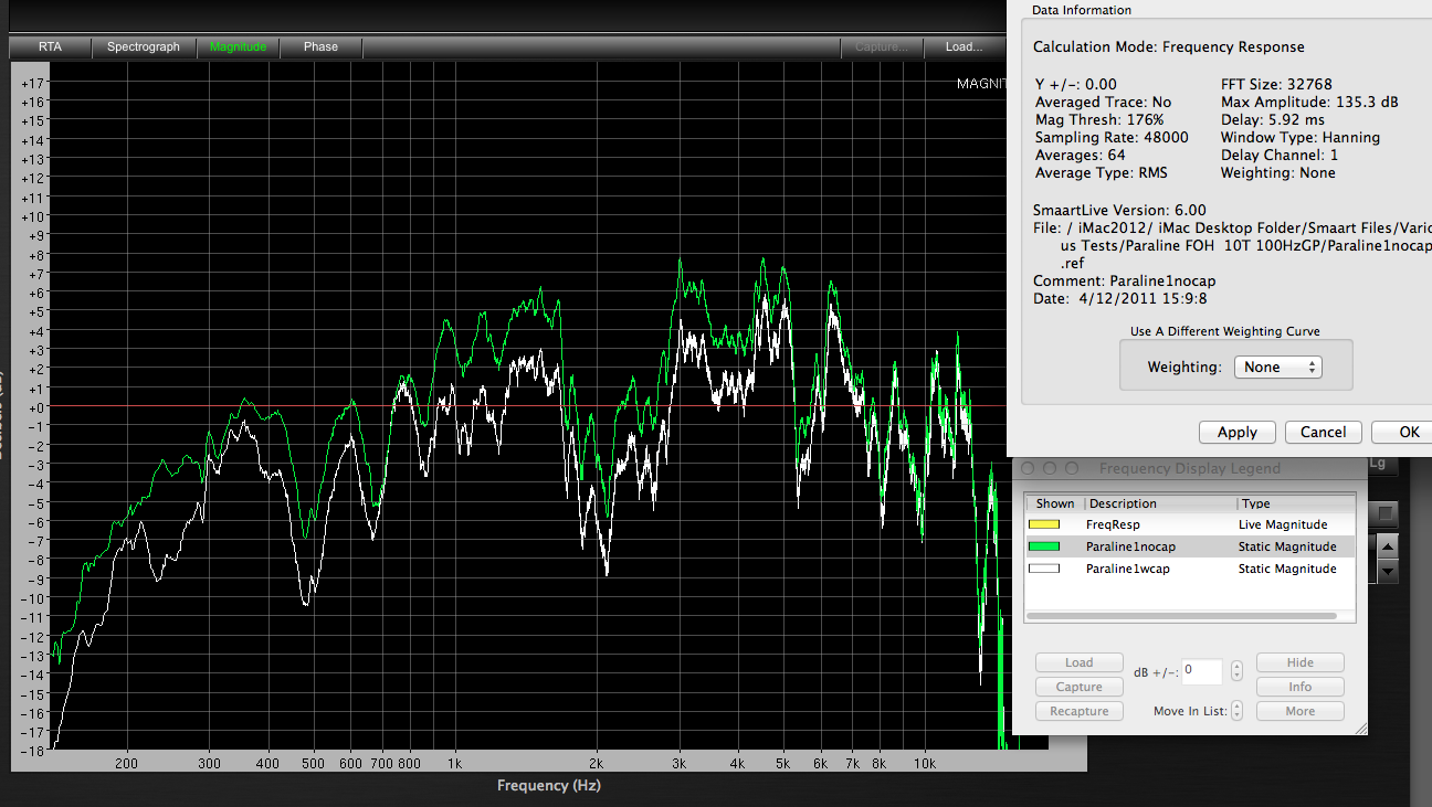

Nice looking Paralines!

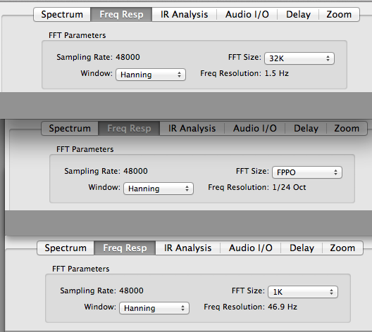

I think your conclusions are influenced by your choice of "Options" under "Frequency Response" in Smaart.
If you have chosen an FFT size "FPPO" (fixed point per octave) the maximum resolution is only 1/24 octave, which won't show the narrow high frequency peaks and dips that are clearly evident in my comparative screen shots in post #314, using an FFT size of 32K, which gives a resolution of 1.5 Hz. Post # 768 also has more "smoothed" comparisons.
Using an FFT size of 1K reduces the resolution to 46.9 Hz, even with no "smoothing" that would also result in a fairly smooth looking graph such as yours (or DSL's), reducing the +/- deviations by a large margin.
Art

Hello Art,
For truths sake i can't recall what size fft window i chose..!
I will, out of curiosity, check the fft size out (and take of course more measurements with same fft parameters as Your graphs to get comparative data) when next time i have a chance to advance this project. Be it a week, a month, or some other time.. Fortunately i have a separate laptop without any other usage, so i'm pretty sure all settings are still unchanged.
By the way, Art.. You have made synergy-style array before.. I have these boxes containing plenty of fine drivers.. I might eventually try that out too.. Can I eg. pm You to ask some questions or should i just post here..? (It may be a little off topic even though there is paraline involved.. :) )
Jani,
Questions regarding my SynTripP design would be best in the thread:
http://www.diyaudio.com/forums/mult...ual-single-point-source-horn.html#post4114406
To determine what FFT size you used for any of your tests, select the file on the "Frequency Display Legend", then hit "Info", and a data information screen will be displayed with all the test data, in the example below the FFT size is 32768 (32K) which gives a 1.5 Hz resolution.
Art
