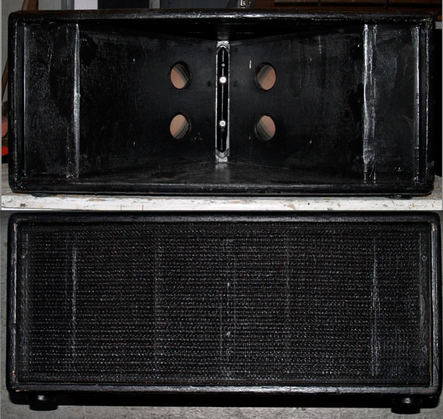

Here's all I need to know:
1) Nate Hansen wrote the following:
"Someone mentioned my Paralines a few days ago, and put up a link. The measurement shown, I'm fairly sure, is 1/6 octave smoothed. The response with higher resolution is absolutely awful.
I used them for about a year and a half, but really they were only good for background music.....if that even."
2) Art was the first to clone Paralines, and Art has mentioned numerous times that he prefers "conventional" Synergy horns for hifi use
3) I built a whole bunch of Paralines, and I gave up.
I'm not saying that Paralines don't work. They DO work, but the diffraction artifacts are noticeable.
If I needed narrow vertical directivity and wide horizontal directivity I would use a Sausalito Audio Works lens or a ribbon.

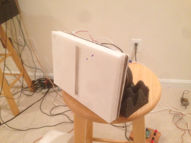

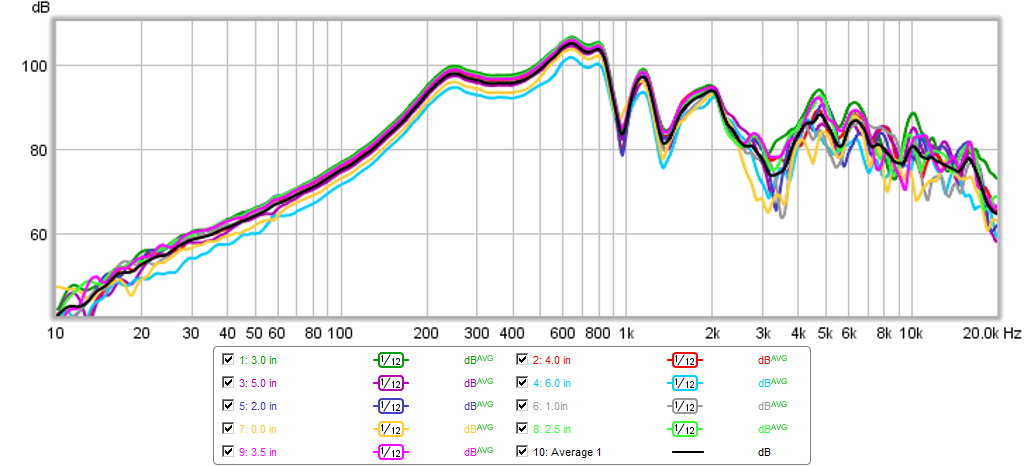

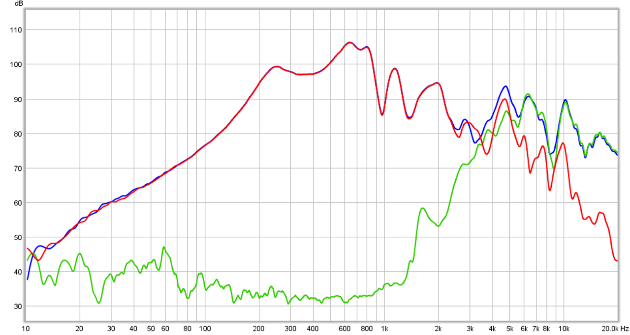

Although I don't technically have a paraline design, I do have the sharp 180 deg folds and I agree that the diffraction artifacts combined with what the folds do to the frequency response as shown in both the sims and measurements inidcate that its not worth pursuing further if high fidelity domestic audio is what you are after.
Here is a photo of the speaker during the test:

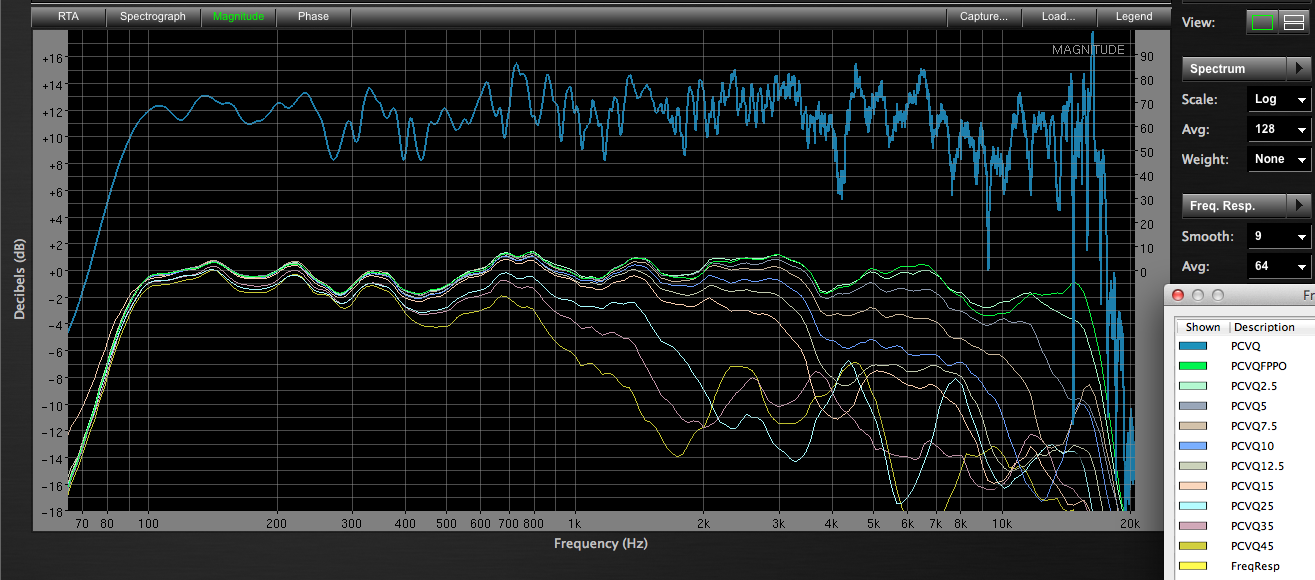

Here is a measurement of the response showing the LF drivers (full range) and the HF piezo tweeter (3.3uF series cap HPF):
Granted, if I had a higher sensitivity CD for the HF's the amplitude levels would be more balanced, but that would not change the "pine trees in forest" frequency response profile I am getting, which I believe, is not totally inconsistent with some of the other measurements that are out there. On the plus side, it looks like the simple mid freq injection ports for a pancake synergy are working well and the cheap sealed back driver is getting down to 200Hz or so.
Here is a measurement of the amplitude variation along the slot axis at 2cm away (0, 1.0, 2.0, 2.5, 3.0, 3.5, 4.0, 5.0, 6.0 in locations, with 0in and 6in at the very edge of the slot) - I don't see any "beaming" or light ray like "focusing" going on here:

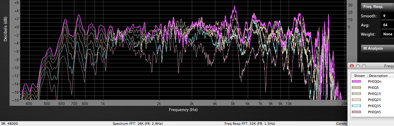

And here is a measurement of the polar response at a distance of 12in away:
Thanks for your documentation X! The results show us that this folded technology is pretty consistent in its performance.

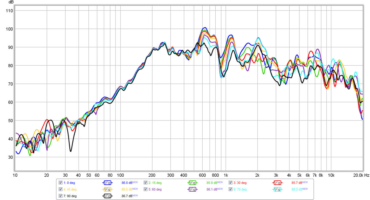

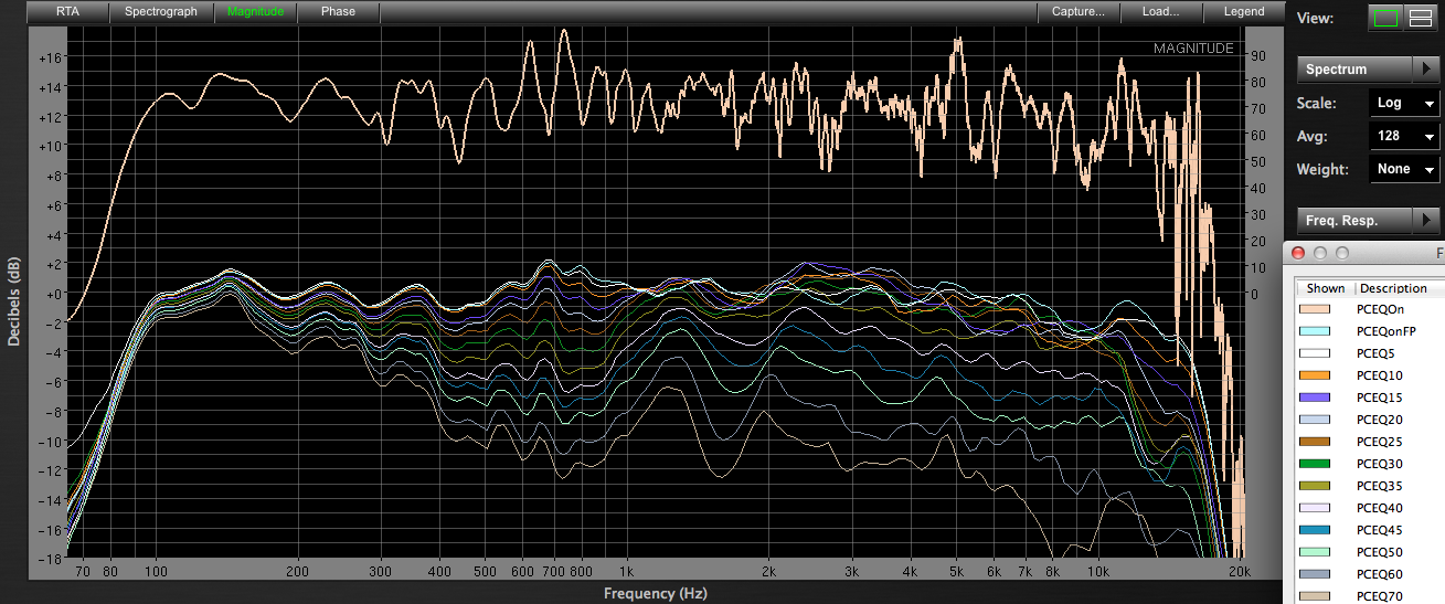

I had lost the polar response data for my 90 degree Paralines built in 2008, for a reference point to compare with my current SynTripP
http://www.diyaudio.com/forums/multi-way/262838-synergy-tripp-10-a.html
project using the same size enclosure (26.5" x 11.25" x 15" deep), I retested one of them yesterday. The top trace shows the equalized response with 1.5Hz resolution, the rest use 1/24 octave resolution (Fixed Point Per Octave, FPPO) with a smoothing of "9". The horizontal response is quite even, other than a narrow region centered around 1250 Hz were the dispersion gets wider- the opposite of what often happens with conical horns, which often exhibit "waistbanding", a frequency region that has more narrow dispersion, then wider. The interior height of the parallel walls of the horn is 9.75", the wavelength of 1390 Hz, so I'm not sure what about the Paraline/horn geometry that is responsible for the "midriff bulge".
Vertical polars of the Paraline are a different story, exhibiting a classic pattern flip, 90 degree at 1000 Hz, but only 10 degrees at 16,000 Hz. The VHF vertical pattern is so narrow I had to take the polars twice, after realizing the mic, at six feet away was about 2.5" off from dead center, causing a 3 dB drop at 16,000 Hz!

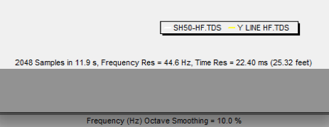

Ken,Danley's paraline measurement at #621 looks very smooth to 5K, and not bad above...
Yes, it looks smooth, because the measurements were smoothed.
Look at post #795 to see what the difference the type of smoothing and frequency resolution does to a response curve.
