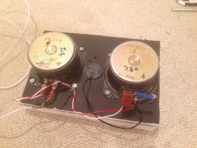

One problem: I don't have a suitable compression driver... I have a piezo tweeter and a mylar dome tweeter I can stick in there but it won't have the SPL's to match the two mids. I may try some GRS 87/8 sealed back mids first that I have on hand and see how that goes.

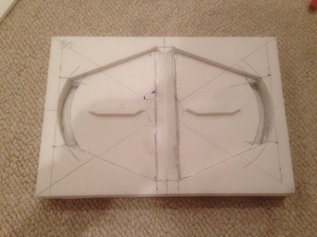

That is the feeling I get from reading posts and one reason why I built my first one out of foam core for under a $1 and 1 hr. Although my design deviates from a classical Paraline, the 180deg fold in such a tight channel with two 90 deg turns at the begining and end really seems to do a number on the frequency response. I am just starting to listen to it and make some initial measurments with a piezo tweeter stuffed into the 1in dia port hole. It sounds ok and measures terribly with lots of dips and peaks. The one good thing is that the mid injection port works really well extending down to 200Hz and going up to almost 2kHz using the two sealed back Goldwood 5in mids. If I had a decent CD it would have been simple to XO at 1200Hz or so.
This is by no means the aha moment I got when I listened to my full range Trynergy for the first time which I described as magical.
I have to say that this Paraline design is very compact as I have a 9in long horn that is only 1in deep and I am able to couple a pair of 5in mids into it very easily.

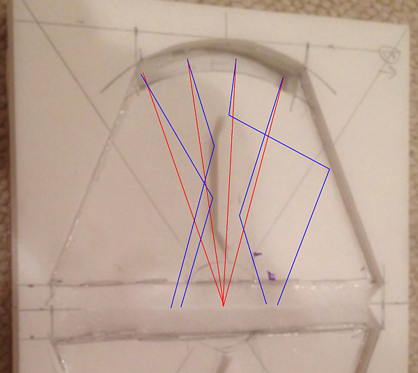

Wrong shape. Therefore conclusions about performance are meaningless.
Worse than parabolic, you seem to have focused a bit to the center.
With bounces off the supporting structure, its not even a focus...
The second horn section is not properly filled, doing mostly nothing useful.
These almost random paths and lengths do not create a coherent wavefront.
Its not a paraline. Its not smithagrain. Its not a folded triangle waveguide.
The resulting exit pattern is a complete jumble of unscientific incoherence!
Other than having inexpensive fun, I think you've
slightly missed the best points this build had to offer.
If you can't draw the proper curve, then just stick to
a simple folded triangle that doesn't change expansion
rate before/after the fold. With a flat reflector slot.
That way should be almost idiotproof. Almost...

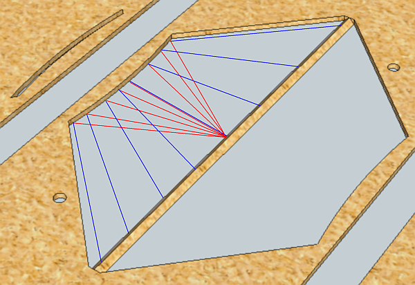

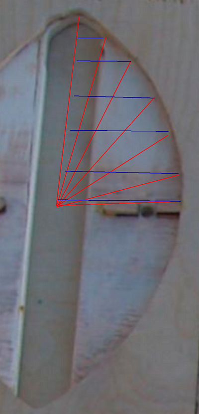

I think you've just volunteered us into building one of these contraptions.
For comparison:
Raytrace of Patrick's example for the correctly shaped paraline...
Raytrace of the proposed smithagrain...
Raytrace of a confused mess...
Congratulations! You have invented the misalign.

I appreciate your feedback but would have to disagree with how you basically applied optical ray tracing to what is essentially a pressure waveguide. Imagine a conical flat horn going from 1 in to 6 in wide x 0.1875in deep over 9 in long. Now fold it in half and add a small brace akin to a spider in a CD phase plug or the struts in a Smith horn. How come no one complains about all those struts that would mess up the ray tracing. Or what about all the walls in a cellular horn? I maintain it is not ray tracing based to design this but concept of flow path lengths. The wavefront coming from the center will spread out radially and pass through the 180 deg fold. Just because the fold is curved doesn't mean the sound wave is focused like light rays in a magnifying glass. Sound waves do not propagate like a pencil like laser beam. The flat wall at the fold is not a reflector - what is important is the path length of propagation from the source. If I had stiffer material I would skip the brace but the foam core needed it there. I do see that to make a horn capable of higher SPL I need to use stiffer material as the FC vibrates and has some harmonic distortion contribution. Next build will be wood or plastic. This prototype was useful for me to see the tricks in construction and layout.
Yes, I should have drawn all the rays the same length rather than stop at the exit.
So you can better see and compare how the paraline descibes a line, smithagrain
describes an arc, and misalign describes a completely confused mess. Wood and/or
plastic upgrades will help, but won't change that sound waves do behave optically.

corners. As for the center, it might not make the optimum lens to draw
a simple circular arc, but its probably not far off.
If you want to figure lens bulge or squish, then you need to draw a
circle from the apex (another point somewhere off board) of the exit
triangle, to the edges of the exit slot, to visualize the curve of the exit
wavefront. Then the distance from the driver to the lens and back to
the wavefront should be the same in the middle as the outside edge.
When raytrace bounces and distances all agree, you've got your lens.
Probably overkill to worry about more than two or three points on the
lens curve, as most folks couldn't saw a curve that accurate anyway.
Now, I like the exit triangle to be 90deg so it can go in a corner and
seamlessly cover all the way to the walls. And I like the throat triangle
to be somewhat narrower, so the expansion rate can increase at some
stepped approximation of logarythmic. What that means in height to
width of the panel? I didn't rightly figure anything, but just eyeballed it...
Which is probably rediculously bigger than it needs to be. Also I drew
the layers 1/2inch thick. They should probably be less than 1/4inch.
The exit slot should have been only 1/2 inch wide, which means the
whole thing shouldn't have been taller than 24.5inches... So, its all
kinds of ways messed up (the drawing is). But the idea is still solid.
Just gonna to have to wing it on the specifics...
Find some sonotube you like. Make a panel about 1cm to 0.5in taller
than two sonotube diameters. Then draw a pair of 90deg (or whatever
coverage angle you wish) triangles, narrowing as they go away from
the exit slot. Then at some reasonable margin from the edges of the
panel, you need to draw two triangles back to the center to meet the
driver. Lastly you have to draw the lens that matches your triangles.
If the triangles are same, the curve is a flat line. Elsewise, you draw
lines that bisect the difference between one triangle's edge and the
other. And they meet somewhere way off the panel, but thats the
center of the curve you got to draw that will be correct at the outside
