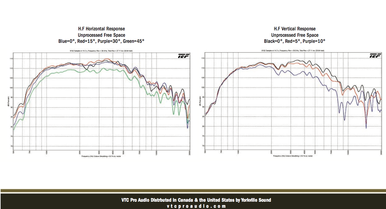

Earl,
The Paraline device controls vertical beamwidth, the waveguide it is attached to controls horizontal beamwidth.
Below are horizontal and vertical response charts for the VTC EL210 HF drivers, a pair of Paralines on a single 90 degree waveguide.
The horizontal dispersion is very uniform, the vertical not so good.
Evidently they designed their Paraline with a 10 degree divergence, the ones I designed have no vertical divergence (in theory) while in practice something like about 5 degree at 16 K, widening with lower frequencies.
I'd post the charts of my Paraline polar response too, but unfortunately I deleted them at some point.
I did save a test which resulted in my removing 18mfd series "protection" caps, a holdover from the days of Phase Linear amps dumping the full DC supply voltage on the output when a transistor would fail.
Removing the capacitors made the crossover transition area much easier to "get right", and generally was an improvement in the EVDH1AMT's response.
I reused existing PA cabinet shells when building my Paralines, I was concerned that having parallel top and bottom horn walls might cause a standing wave problem.
To my surprise, angling the top or bottom walls on the prototype made no measurable difference in on axis response, in fact removing the top and bottom made no difference either!
When I saw (and heard) that attribute of the Paraline, I knew that it was doing something I had not experienced before.
The Paraline is very good for the desired application of multiple drivers on a single horn, or narrow vertical dispersion in a line array, but the ragged frequency response it imparts is a trade off that makes it a poor choice for home use.
Art

I'm still not following and the data just looks like any other slot loaded diffraction horn.
What am I missing?

Earl,
The data does look like a slot loaded diffraction horn, which is what it is.
An old style slot loaded diffraction horn built like the Manta Ray would require about a 30 inch long pinched throat for 10 degree vertical dispersion, or 60 inch long pinched throat for 5 degree vertical dispersion.
The Paraline can do the same with a path length of a few inches, which is good both from a sonic standpoint as well as cabinet depth, and allows the mid driver's exit to be placed within 1/4 wavelength of the apparent acoustical center of the diffraction slot.
There are many different ways to accomplish the same end that don't require 30 to 60 inch throats, though the usual minimum seems around 5 inches, about 5 times the depth of a Paraline.
