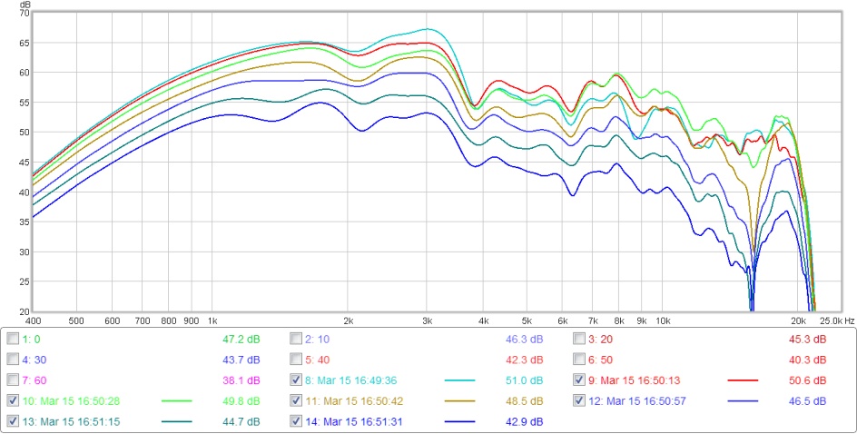

IMHO, the Paraline has the potential to deliver smooth 'hifi' output. In order to do this, we need to satisfy two requirements:
1) The horn must be of sufficient size
2) The horn must be carefully built
Here are the reasons I believe this:
In the pics above, I've shown measurements of five different Paralines.*
In those measurements, I believe that we see a trend. The Paralines which use small diaphragms and careful construction measure the smoothest. For instance, the VTC Paraline (measurement two) is relatively smooth. My 'Stargate' Paraline (measurement five) is smoother than my earlier Paraline (measurement four.) Your Paraline with an EV DH1-AMT uses a diaphragm that's 7.62cm in diameter; my Paraline with a Celestion CDX1-1425 uses a diaphragm that's 3.6cm in diameter.
The Paraline from the fifth measurement was built using a template that I printed on my PC; the Paraline from the fourth measurement was 'eyeballed', I basically did it with a sharpie.
See how the fifth is so much smoother? Both use the same compression driver.
I believe the reason that we need a small diaphragm and a very carefully constructed Paraline is due to the wavelengths involved. For instance, an error of just 1.7cm at 5khz will make a measurable difference in the response. And when we build these things 'by eye', a lot of small errors can creep in.
The other reason for small drivers is because it smooths out the ripples in the output which are due to the impedance mismatch. The alternative would be to use a larger height inside of the Paraline, but that rolls off the highs, an unacceptable solution.

Patrick,

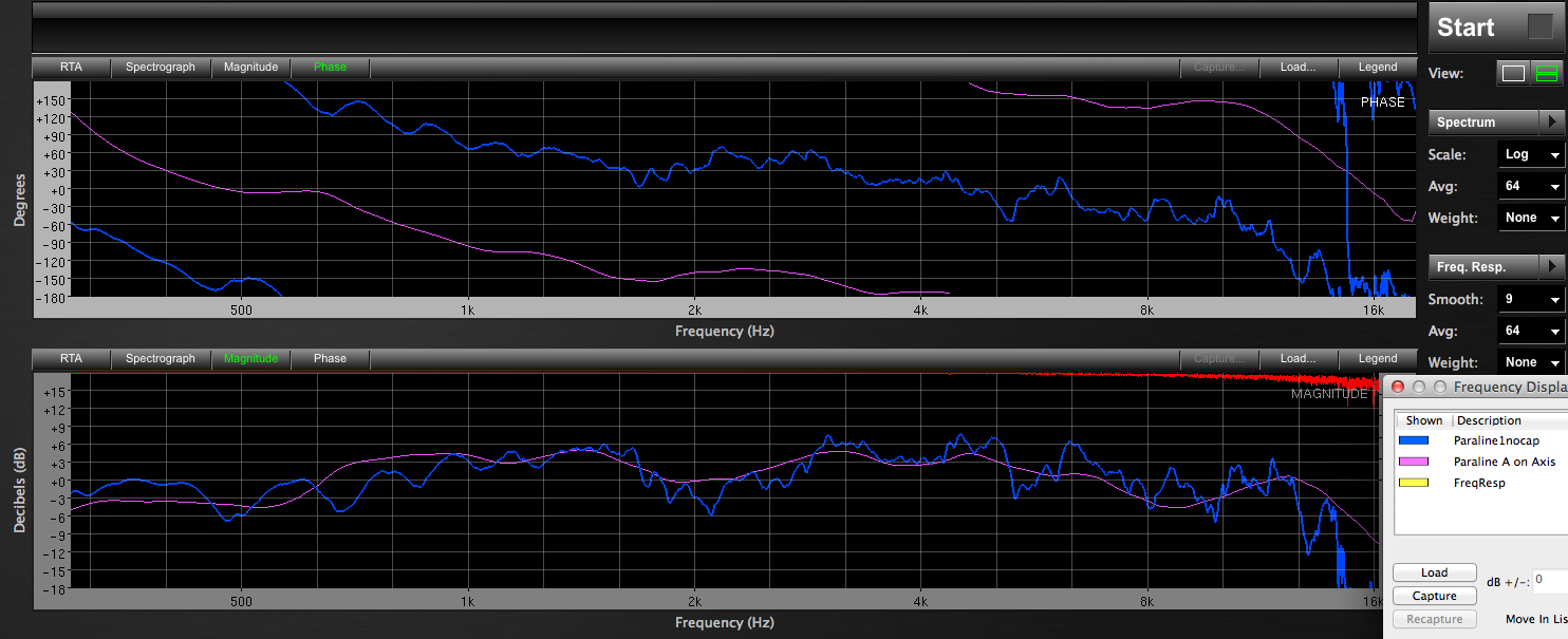

The primary "trend" I see in the measurements is those with a large vertical scale and more smoothing look smoother.
As you can easily see below, my 3 inch diaphragm Paraline "A" is much smoother than any of the other units tested ;).

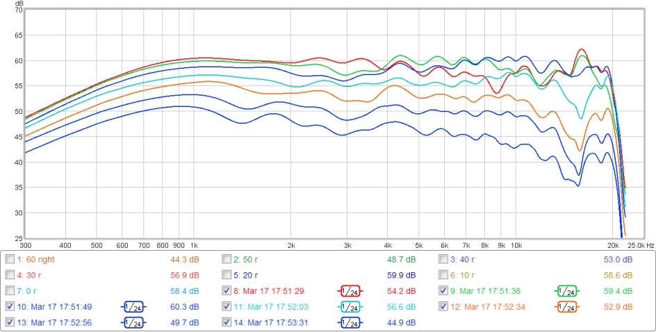

That measurement set of mine that PB posted was a very crude setup to get an idea if the thing was going to work. The dome tweet and sealed off 3" wideband drivers were mounted to a piece of cardboard :eek: with no reflector at the tweeter "throat" and eq'd profusely.
Here's a set with the Paraline mounted to a 60x40 conical horn measuring 20"w x 25"h. BMS 4552nd CD. 3ms gate measured at about 1.5-2 meters, 10° steps. No eq just a 40uf protection cap. Nevermind the dB scale it's not calibrated. The nicer looking set has been eq'd (obviously) and has 4 closed back Celestion mids flanking the BMS. This was my first time building horns, and I can tell you they are far from perfect. Prototypes really. Same can be said for the Paralines.

I still think these have hifi potential. TD specifically states that the entire para line must be kept to less than 1/4 wavelength. Could the top end raggedness be due to these DIY paralines having a space at the CD's throat greater than 1/4wl? I think a throat insert that ensures the paraline "depth" is never exceeded even upon exit from the CDs phase plug. I'm not sure if I'm explaining myself very well.
Basically what I'm seeing is that even with the little cone section that faces the CD exit the spacing is already being allowed to expand to the CD exit's diameter before being constricted to the 1/4wl paraline passage. I'm guessisng this is basically acting as a throat chamber and causing the HF response anomalies.
So why not extend the paraline into the CD exit so that the wavefront never expands past the designated size? Well besides it being difficult to construct. Could this be what TD is telling us?
