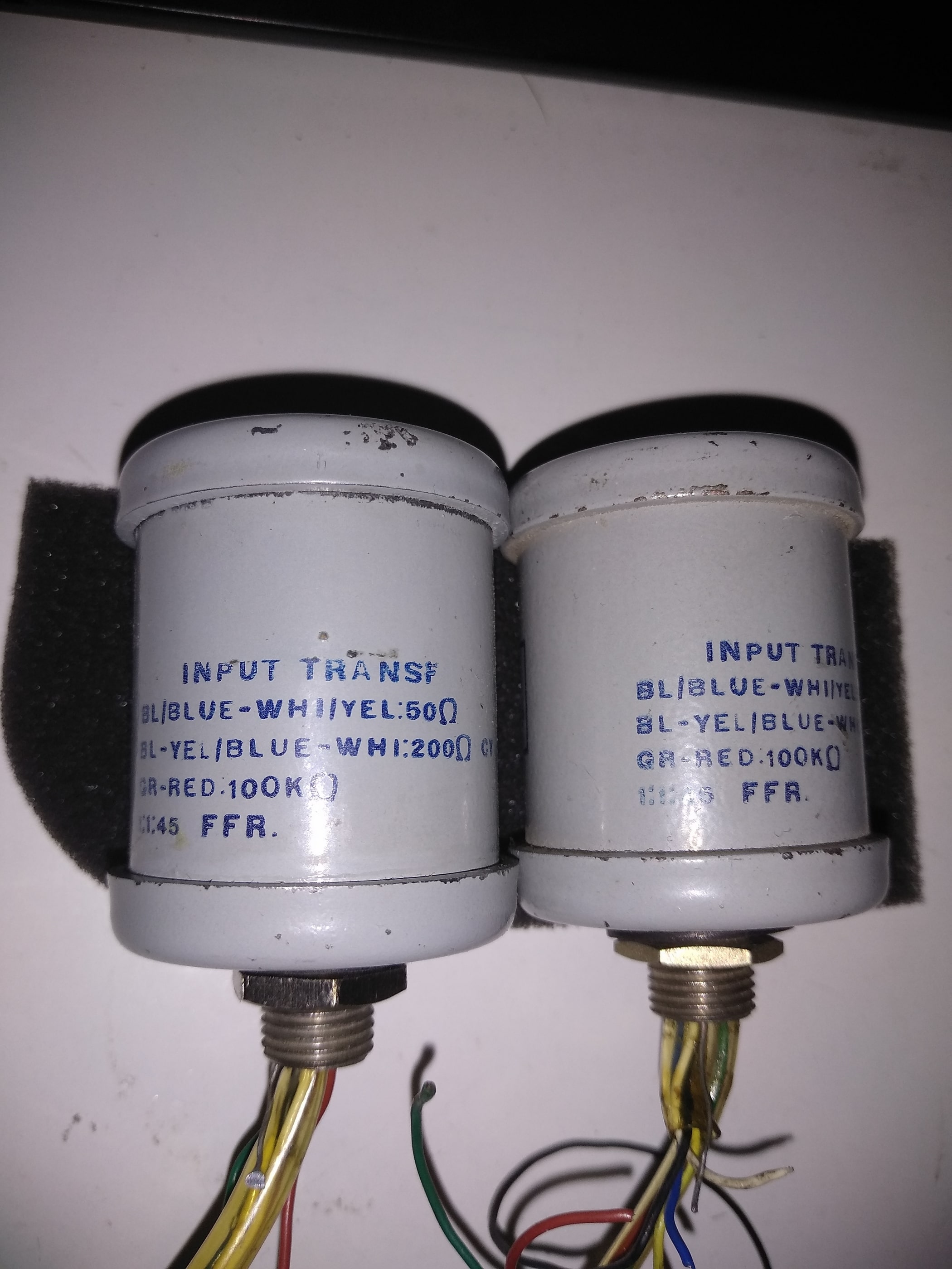

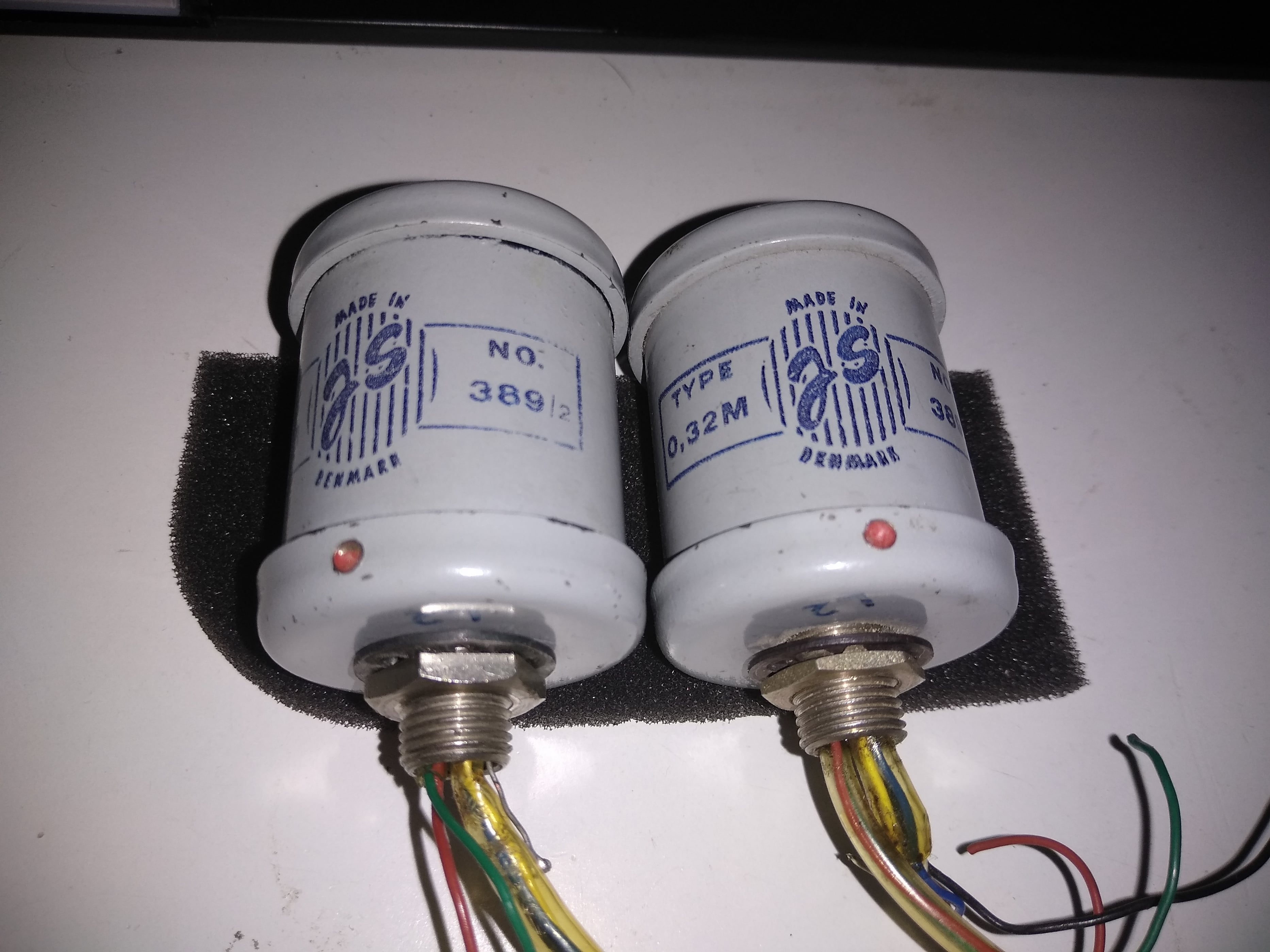

Hello! I suppose there are some vintage-audio gurus reading this thread, so I have a few questions: some time ago I bought bunch of components that belonged to a TV repair shop guy who has passed away a long time ago. I found a box with pair of used Jorgen Schou 0,32M type input trafos NO:389/2. Primary is 50ohm (non ct) or 200ohm CT and sec. 100k. It reads also 1:1:45 FFR. So, do you guys have any idea from where these are pulled out? What means the ratio 1:1:45, is it that each primary has 1:45 ratio to secondary? And finally, what should I build for these

PRR -Thanks for reply! So this is not belong on this thread actually, I was thinking that these might be some old phono-stuff.. I think also that they couldn't be tube mic trafos cos they have smaller ratio's (not really know) but preamp stuff not come to my mind..
It would be interesting to know what is the history of these units.. Another was opened for some reason (somebody has put dampening rubber between the cans), I tested them for my poor signal generator, drive the 100k side of 7Vpp square and found overshooting after 20kHz without any load on secondaries except my old fluke scopemeter.. might need some zobel or load..
There are pictures of them:
Try to put on secondary a standard 47 kohm
If you put the primary in series you got a reflects impedance of 96 ohm and the ratio of 22,5, 27 dB
So you can attach an MC with 3-9 ohm of impedance.
About the freq. answer if you have a good sound card and ARTA software you will find an answer.
To adapt the Zout of sound card you can put in parallel to it a resistor of, p.e., 4,7 ohm.
Then with a good tester you will read on secondary, p.e., 100 mV the you can use a sweep.
