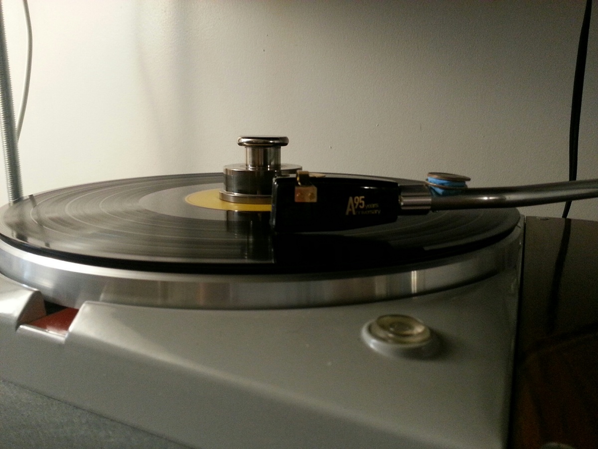

My recently ordered SPU A95 arrived at the local Ortofon dealer yesterday, and today I went and picked it up.
I also own a Meister Silver GM II and Royal N (Royal without the SPU head shell) and have to say even though the A95 is not broken in it is clearly a significant improvement.
The focus of this design is controlling/reducing unwanted resonances within the physical structure of the cartridge.
I guess all of the emphasis on resonance control paid off, it clearly resolves better that the Royal N which is no slouch, and has a more neutral tonal balance - the Royal sounds a bit brighter and not in a way that adds anything to the music, it just is. All round better.
The cartridge specifications included with the cartridge are slightly better than the specifications listed on the site. Tracking ability is now 80um @ 315Hz and 3g tracking force, compliance increased to 10.
It is also slightly lighter than the SPU A90 I had here for a while, or my Meister Silver which means that without a couple of dimes blue tacked to the arm tube of my Schick I cannot set the tracking force to the required value. I know now what I did not know when I ordered the Schick, and that is that I should have ordered the standard counterweight and not the heavy one.
For the few out there into SPUs this might be a must have, I have a more favorable initial impression of it than of its predecessor although as far as I know they are close to if not identical.

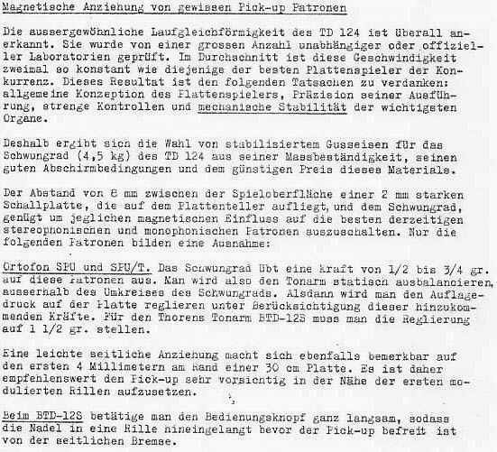

Steve this is what Thorens advices do do with the Ortofon SPU carts, I use a Correx scale.

I generally set the tracking force between 0.75gm and 1gm low for the SPUs I use on my TD-124s unless I am using a digital scale on the platter in which case I set it pretty close to the nominal value.
