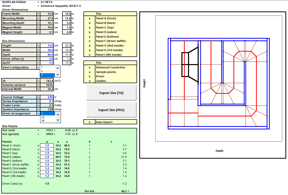

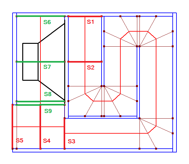

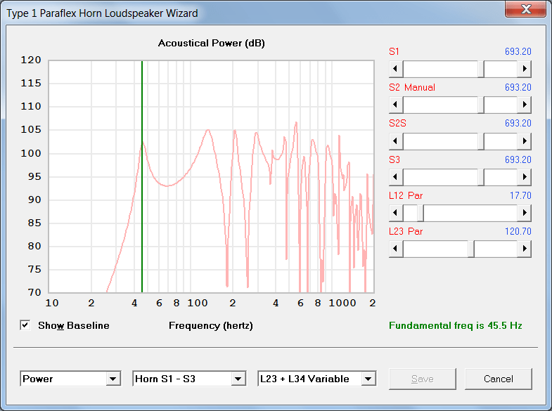

Concerning the PARAC BOXPLAN workbook, there shouldn't be any major differences in the predicted performance at low frequencies. There will be some differences though once you get above 100 Hz or so. Of the two models, the PH model I believe is the more sophisticated one.

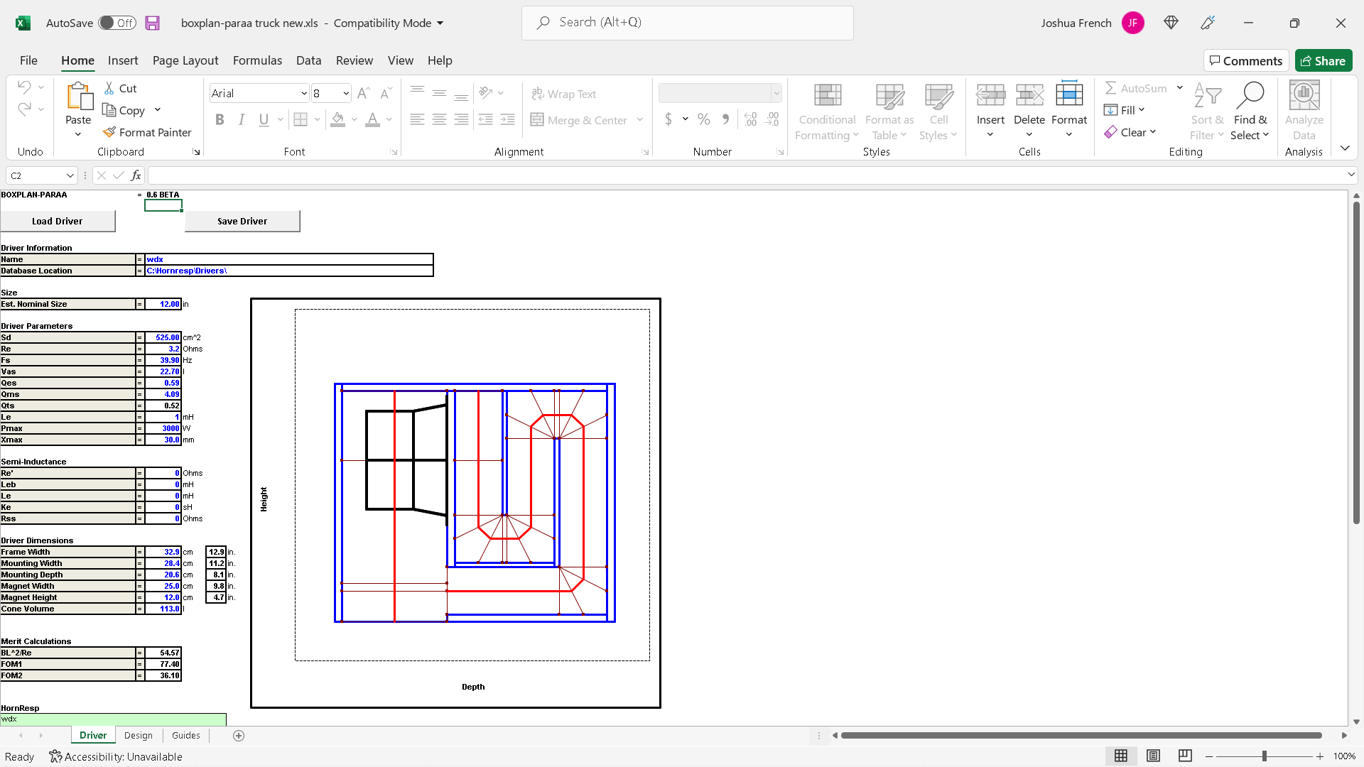

I plan on doubling these dimensions and putting 2 woofers side by side in the back of my truck. I removed the 6th order wall i currently had that i built using term lab pro and replacing with this. I assume that will work because the boxplan doesnt allow for 2 woofers side by side it only shows one in front of the other.
Just to clarify, as far as Hornresp is concerned it is possible to get effectively identical performances out of the PH1 and TH models by suitably dimensioning the component values in each system. For the test example below, Attachment 1 shows the PH1 system model, Attachment 2 shows the TH system model, Attachment 3 shows the PH1 power response and Attachment 4 shows the TH power response.Concerning the PARAC BOXPLAN workbook, there shouldn't be any major differences in the predicted performance at low frequencies. There will be some differences though once you get above 100 Hz or so. Of the two models, the PH model I believe is the more sophisticated one.

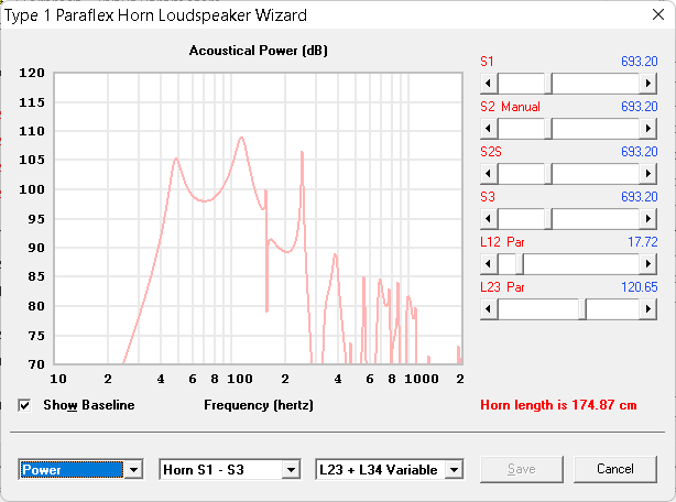

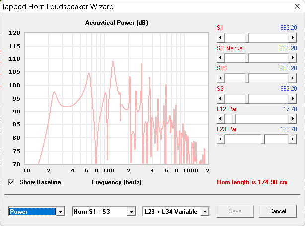

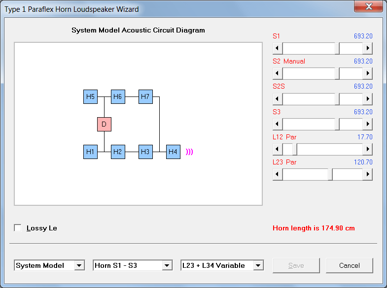

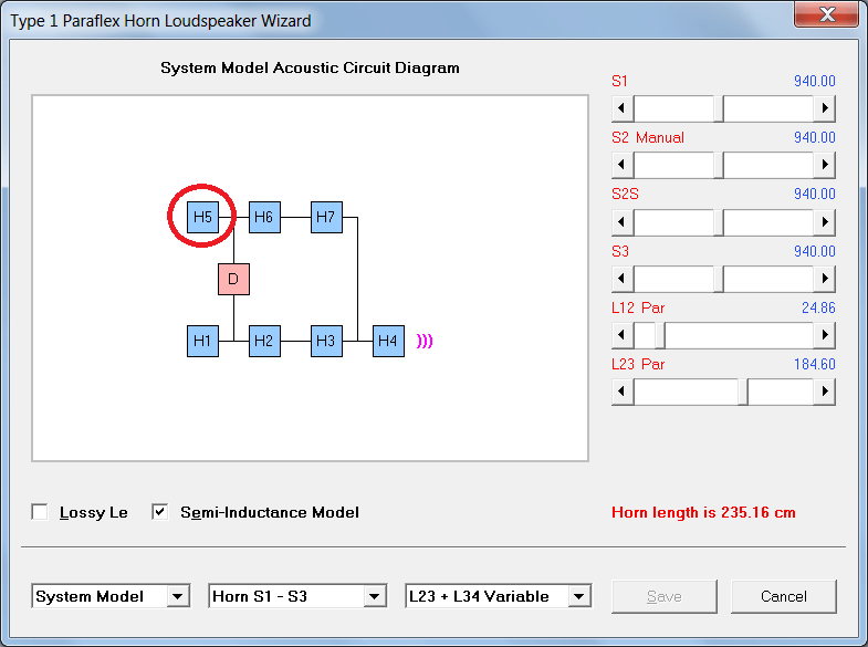

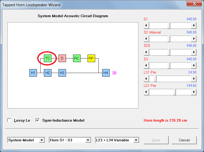

Those are some fairly significant differences.View attachment 1056276
this is export th
this is export ph1
this is the design page
Maybe I am missing something
Please post up the contents of BOXPLAN.TXT export files from the workbook. The contents should look something like this:

I think the minor differences between the TH and PH1 exports have more to do with the approximations BOXPLAN makes about the path lengths in the models than anything else.Just to clarify, as far as Hornresp is concerned it is possible to get effectively identical performances out of the PH1 and TH models by suitably dimensioning the component values in each system. For the test example below, Attachment 1 shows the PH1 system model, Attachment 2 shows the TH system model, Attachment 3 shows the PH1 power response and Attachment 4 shows the TH power response.

is this what you needed? or do you want me to screen shot it from hr?

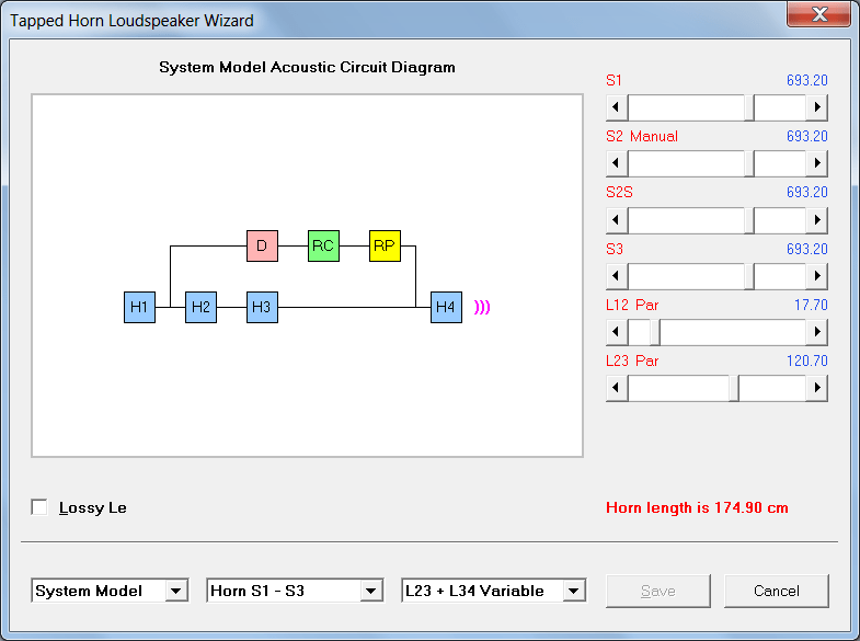

Was this used on just a demo woofer or the specs I gave? because even when I went and changed the values which were only off by .2 on some I got no change in frequency response. My numbers however were the same as the pics you posted so I assumed you were showing me it was possible with the information I gave. However, I didn’t get the same results. I’m probably just missing something simple and looking dumb lol. I really appreciate the help.Just to clarify, as far as Hornresp is concerned it is possible to get effectively identical performances out of the PH1 and TH models by suitably dimensioning the component values in each system. For the test example below, Attachment 1 shows the PH1 system model, Attachment 2 shows the TH system model, Attachment 3 shows the PH1 power response and Attachment 4 shows the TH power response.
I am confused on this response idk what this has to do with my question? Those frequency’s are way off from what I was asking? Please fill me in tho if I am not understanding because I am really trying to understand everything and far from knowing it all. I appreciate any help I can get.try this in HR, look at 860, 1720, 2580 hz (TH mode cant proide that accuracy, as the rear of the driver isnt described in such detail . this is a huge advantage once built, its obvious . in comparison to a >paraflex< its just a piggyback TL >in phase< where it lands on the other.
not a paraflex, its gotten rid of the akward top of the bandwidth and goofy rolloff(in real life). Paraflex is loud but it’s far from perfect. A little more Atention to each sides length from the other and the closed and distances(offset) as driven and it becomes a whole Nother animal

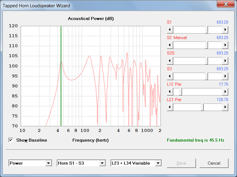

My test example used the Hornresp default driver parameter values.Was this used on just a demo woofer or the specs I gave?

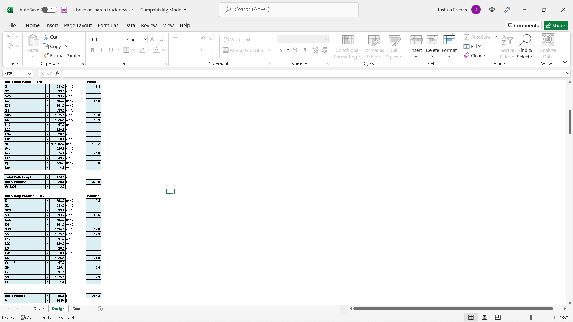

The reason why the boxplan-paraa.xls exported TH and PH1 results are not exactly the same when simulated in Hornresp is because the exported system models are not the same. Attachment 1 shows the exported TH model and Attachment 2 shows the exported PH1 model. Each set of results is correct, for the given model.
The results will only be the same if the system models are the same. For virtually no difference between the two sets of results:
In the TH design:
Set Vtc and Atc = 0
In the PH1 design:
1. Set the length of segment 5 = 0.01
2. Set the length of segment 6 = Lrc (value given in the TH design)
that did work to make my results the same. when i change vtc and atc to zero i get the same frequency response. I guess my main question for the given setup which one do i follow? or what is the difference? i feel like i am not grasping what is really going on when i change those to 0. with the given setup from the boxplan that I am working with shouldnt the vtc and atc be 0? as there is no throat chamber from what i understand? or am I completely wrong?My test example used the Hornresp default driver parameter values.

From a Hornresp perspective it is reassuring to see that your boxplan-paraa.xls system can be modelled as either a paraflex horn or a tapped horn, without there being a great difference in the results.
To avoid ongoing confusion however, it could perhaps be worth considering removing the TH export option from the spreadsheet .
