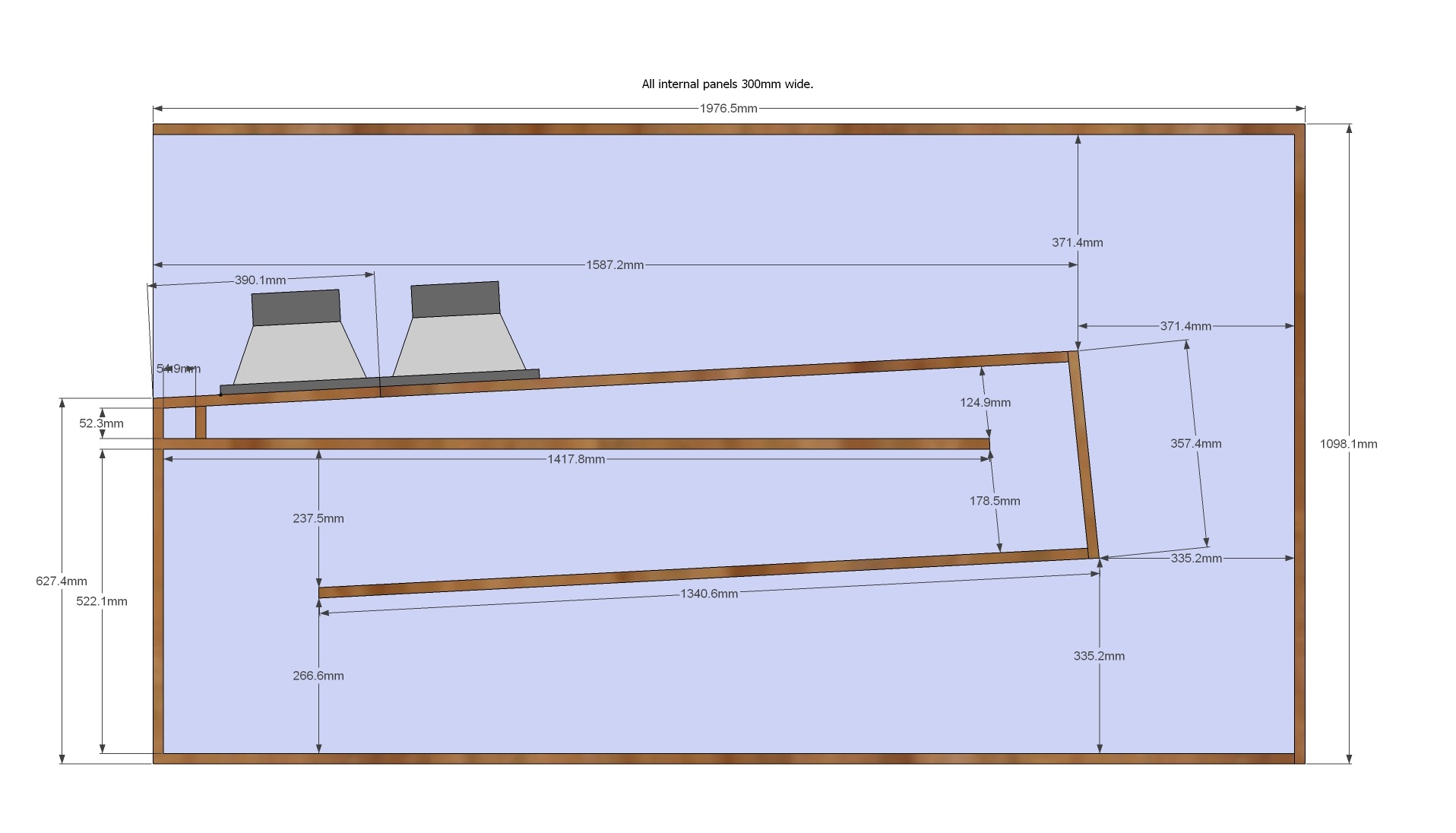

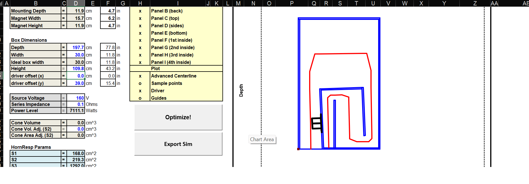

I was fiddling with the boxplan mth30 and is there any way you could add an option to enter the number of drivers (also in series and drivers . Also while i was checking with the horn line path it doesnt move when the driver is off set as well. I am trying to model something similar to this (SDX 3L Dimensions). The model design i get is shown in image(wolfhorn folding. ). Also am a noob still learning on how to use the spread sheet. I did have to manually enter the S1,s2,s3,s4 ,l12,l23,l34 values as it dint get loaded to the design section from hornsrep txt file.
