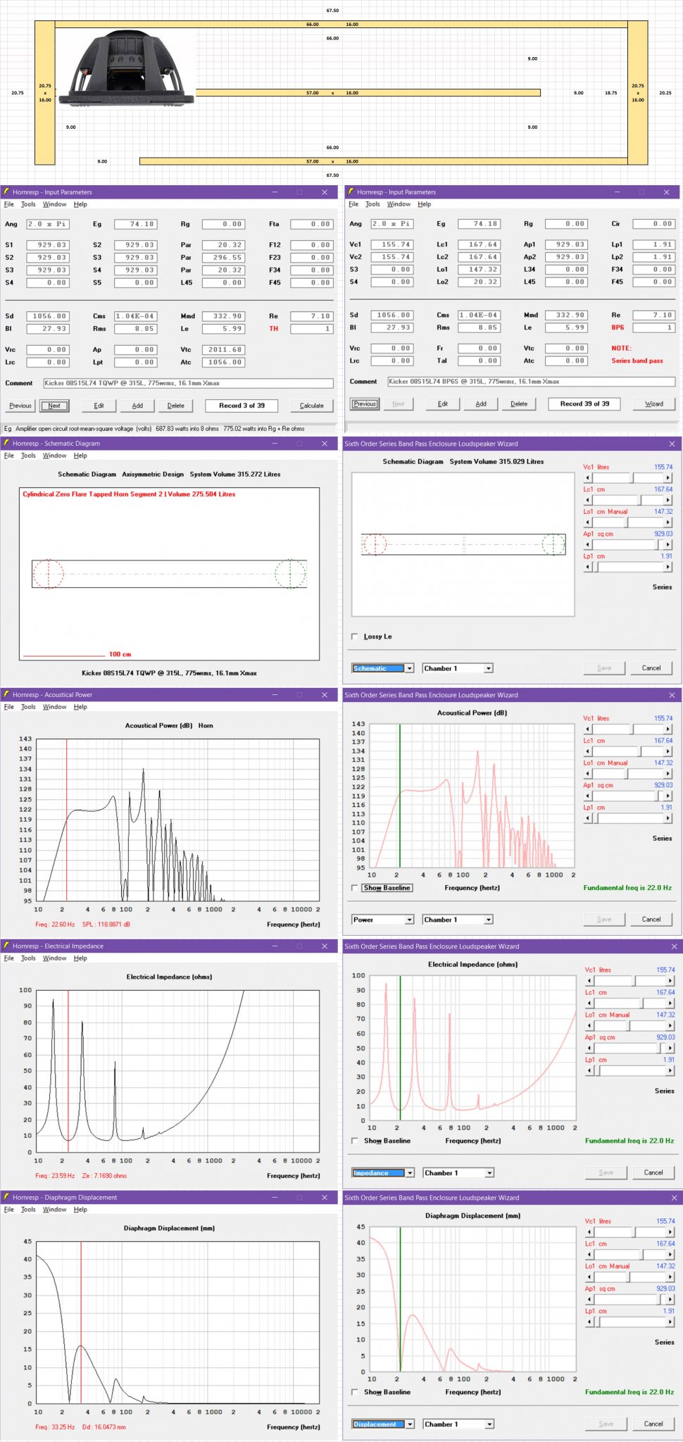

The band pass models include end corrections.Hornresp seems to produce slightly different results, based on which model you use.
Brian , how about a spreadsheet for
hyper bass reflex as seen here ?
https://sites.google.com/site/speak...ass-reflex-type-enclousures-for-single-driver
https://www.diyaudio.com/community/threads/whazza-hyper-bass-reflex.334175/#post-7017239
Looks like I can create a spreadsheet for it relatively quickly. However, what's the value of such an alignment? The box size is the same as a vented box for the same driver, so efficiency at low frequencies will be similar, and the arrangement looks like it's going to produce aberrations in the passband due to harmonic resonances. The Hornresp model also doesn't appear to be accurate as it could be (it should be modeled as a no-chamber OD design in Horresp, IMO).
What about export (ph1)? Does that mean with the woofer flipped the other way?Hornresp seems to produce slightly different results, based on which model you use. I don't know which is the more accurate one, but I'd speculate it's the TH model.
I am getting completely different results when comparing the 2What about export (ph1)? Does that mean with the woofer flipped the other way?
I know what the goal should be that has nothing to do with the question at hand.Well, the goal SHOULD be 25hz versus 52hz for a SUBwoofer.
We were discussing how there are 2 different results in hornresp when modeling but they are coming from the same box plan. Me personally for this build I’m really trying to get down to 20hz up to 70 but I’ll likely end up settling for 22 or 23 hz up to 65 in order to keep it musical.I know what the goal should be that has nothing to do with the question at hand.
