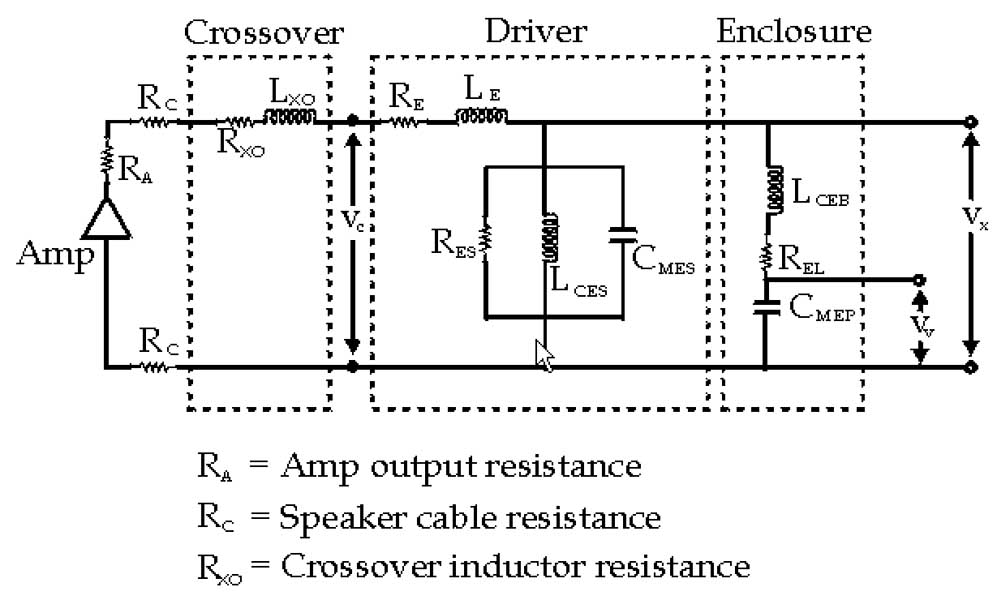

Take an amp with 20,000 damping at 8 ohms that is a z of .0004 ohms (sweet)
Then to know what it is at 4 ohms its 4/.0004 = 10,000 etc
when you put them in an aligned box the whole point is to lower z not raise it in the resonance peak...
It doesnt matter that its a resistive load because damping a quality number

I am not sure how you are applying your zobel... but you do not want to add series r if you want your damping to remain high...
No amps do not have linear impedance... they are basically a very low q bandpass circuit so they can accomodate a large variation in loads...

wll yeh, again I will attach the model below that shows exactly what it all consists of.... since you know how to calculate driver parameters it should be immediately obvious to you....soongsc said:
Damping factors, depending one which part of the amp-to-speaker model, consists of many other things than just series resistance.
Then I wonder whether someone understands what this is saying.
Ok the long version.... I will fill in the blanks for you
I am not sure how you are applying your zobel, in parrallel with the driver? in parrallel with the wire? or both? or exactly what you are trying to accomplish with this?
but regardless of what you mean, do not want to add series r if you want your damping to remain high...

Damping Factor consists of a simple DEFINITION: Zspeaker/Zamp.
Jan Didden
So in reality, where does the speaker cable come in. We have to associate it with speaker cables to be back on topic.
Can you actually show use a measured speaker that complies with that model within 10% tolarance throughout the audio spectrum?
