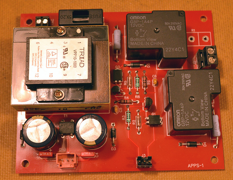

Is this a separate power supply for the relays and protection circuit?
The boards take up quite a lot of space. My problem is available space in the casings.
I have one case with all the amps and attenuator power supplies and another case with the filter, attenuator and amplifiers. Both cases are full so my next build will have to have larger cases.
Yes, it powers the controller board and speaker switch.

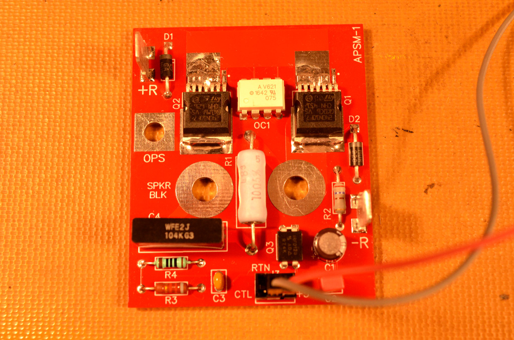

I made this separate board design, so P/S can mount by Amp power supply, controller can be away from P/S and speaker switch mounts on binding post. All the boards can be installed in separate box for external protection on existing Amps.
Did you make the boards yourself?
No, ordered from PCBway.

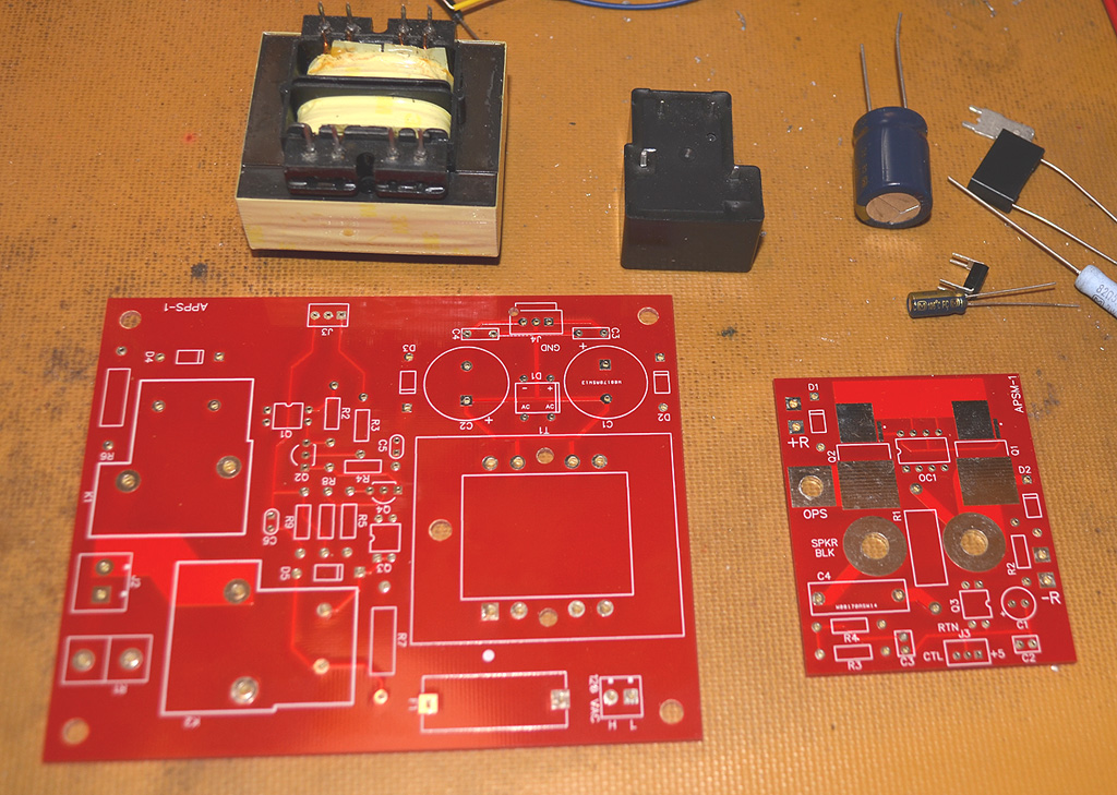

Soft start options
I finished one of my power supply/soft-start boards. I have R1 pads for leads running to terminal board to the side, so I can use inrush limiter or power resistor, if it fails badly, won't burn the board. Will build speaker switch next. Still need to finish MCU design and software.

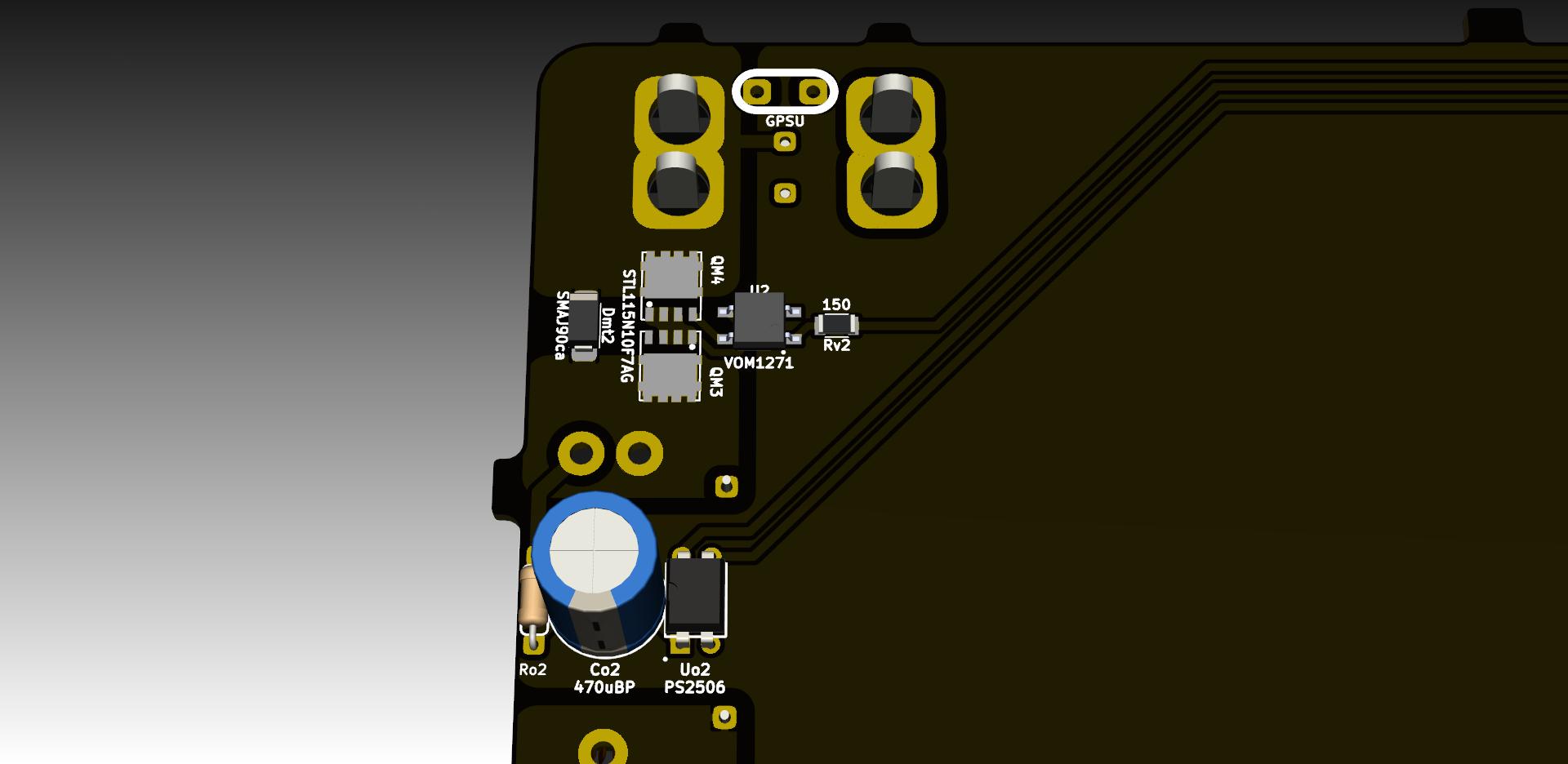

Madinventor, take a look at the smaller PCB mount switching supplies. Digikey has some tiny ones in the 200mA range, and RECOM has some in the 2A range. I'm using a RECOM for powering a RPI3 and my start and protection scheme..
After some tinkering and testing, the following is all that I have found to be needed..
I have kept the MOSFET output relays as an option and are all comprised of SMD parts that hide their ugliness on the bottom of the PCB board. I intend to omit the MOSFET relays in that I don't find it necessary to either/both mute my soft start powerup (its quiet), nor to protect from DC at the output, given that I will be using speakers capable of 1000w short term and that the power is disconnected in one second and gone in less than 2 seconds. It's there nevertheless out of the way as an option..My DC detect duration is long because I have discovered that my DAC will output a strong 1HZ signal and my amp is DC coupled, hence the 1 second trip time. One could play with the values to get a quicker trip time. Also, where I show the "RUN" signal, one could easily replace it with a low voltage power switch running from the same 5v supply, perhaps altering the zener in the delay circuit as well. This circuit will need a 5v supply using these relays, Digikey has some small SIP switching supplies that can power this circuit for under $10. I've started some time ago intending on using PIC or other MCU, however, even those that I asked to help program it recommended doing it otherwise. It's down to so simple now that even the rest of the PI stuff complexity is gone. I've got a UPS with a real power button and real power cycling and filesafe powerloss functionality for the PI as well that will actually fit onto the same PCB as the DAC does. No MCU.
I'll probably make this into something and freely collaborate if there's some interest.

Forgive missing 3d MOSFET prints

interesting
Hello synonymous
Let me guess you use a toaster oven to mount the Mosfets. Interesting circuit, my setup will watch DC offset, sink temperature and bias. I'm pretty much stuck on this coarse having bought everything but the controller PCB board. Here is the speaker switch, I just finished.

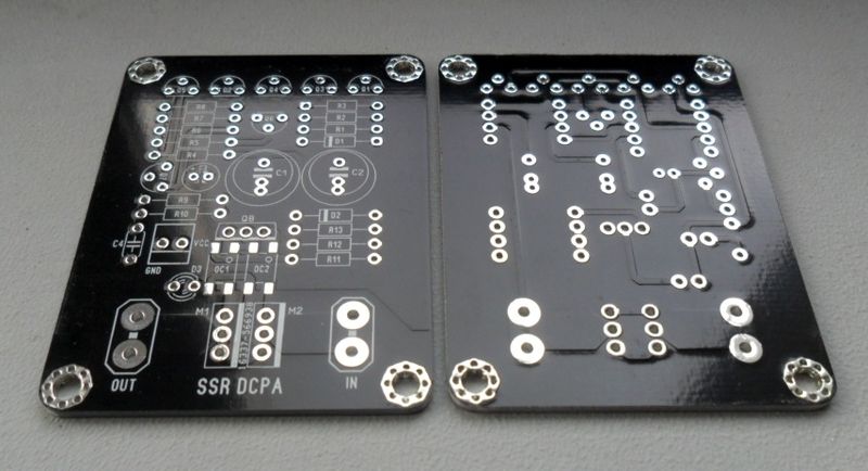

Hello everyone

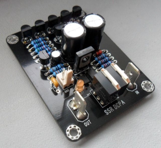

I realized a DC protection with mosfets relay that gives me complete satisfaction. the input is equipped with a second order filter for very low frequencies that could be assimilated to a DC voltage, an adjustable DC detection of +/-0.6V to +/-1.5V and an adjustable delay and with some changes in resistance values the operating voltage is +15V to +50V.
Are documentations for share?
Have you any spare pcb?
Project16
Where did you get your PCB? Maybe I should of gone with black, they would have blended in with the black chassis sitting on the speaker post, gone invisible.

Yes, I can share schematics and the list of materials but it has to be clean and well documented. I have some pcb of available (2oz).Are documentations for share?
I made my pcb at 'FirstPCB'.Project16
