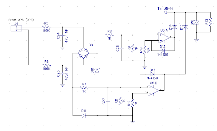

Since my original thread I have looked at various circuit designs; most appear to be a single pole low pass filter with a transistor sensor and relay operation.
I checked a few with spice and could not get very good results.
I tried using two opamps as comparators and got good results.
Comparator voltage can be set quite low, I used 1v.
Only problem was below 3hz with a single pole filter which produced a square wave. It disappeared with a two pole filter but I have read that there can be problems using a two pole filter.
Has anyone used opamps for the protection circuit and is there a problem suing a two pole filter.
Hi Oldjack,
My preference is for opamp/comparators for their precision as you note.
But your observation of "square wave" sensing is due only to the knee of the single pole filter being set at too high a frequency. Double the cap size will help however even a double pole low pass filter will cause a square wave at some low enough freq.
Therefore, the real need is for a latching function on the comparator output so that any protection you have is not self re-setting.

I would go for a comparator as op amps can sometimes flip their output if the input signal goes too close to the rails.

Hi Johno
For the filter I used a 100k resistor with a 47u cap.
+30/-30v sine wave at 3hz with 1V dc so it was just at the comparator level.
Single pole filter let through a low voltage sine wave, two pole filter reduced the sine wave so I guess there will always be a level whereby the comparator will switch on and off but in practice will the dc voltage be almost at the supply rail in which case there should not be a problem.
I used two opamps, one sensing for +dc and the other sensing for -dc. diodes at input to each then output from each opamp to an npn transistor with the collectors connected together to operate both relays.
I will build it on a breadboard to test.
I am running the triamp with old kef speakers at the moment and the amp is operating at fairly low outputs so hopefully should be okay without protection.
I did not expect the triamp to work as it does so did not bother to sort out dc protection. Now there is not enough room in the cabinets for extra circuits.
Have to fit them in the Mk2 version

MI
I set the trip level at 0.75v but this can be adjusted to any level from zero to 15v by changing the resistors at the op amp. Cannot go above 15v due to the limit on the op amp supply.
The low pass filter will filter down to 1hz but can be changed to a higher value if required.
For my triamp I will change the filters for the middle frequency amp to 100hz and for the high frequency amp 1khz.
