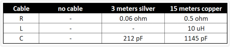

But why does wire length make a difference?
Because of the different RLC of the cables - the values are significantly different. Attached are the measured values (I have measured only the 3m and 15m cables) - they are pretty much in line with the model, described by Nelson Pass, for example.
You must copy the name the link, use the search engine, download the pdf file and then open it.
Look here :
Page 14,15, and 16
