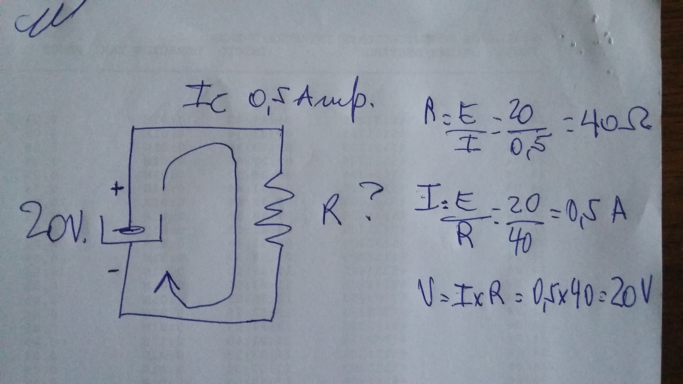

Allow me to close with a tremendous OT on the exercise proposed by me, a little in jest and a bit like challenge because the phrase about my confusion hurt me.
I apologize to all of you who already know this to the point of exhaustion, but there are always beginners in electronics, with no experience, they can use them.
Once a teacher told all the students:
Who knows Ohmn's Law, and knows how to apply it, is a good electronic technician. (He was referring to the Ohmn Basic Law, which by the way in its entirety is much more complex than the classic reminder aid triangle - and that any electronic engineer as there are many here and from whom I learn, know in all its complexity - )
Suppose we are reconditioning a vintage audio amplifier, which works perfectly but you know, fashions are fashions, there are people willing to pay to see new components inside their amplifier. And the technicians are there for that, to satisfy our customers, right?
A resistance is unpainted, you can not see any color coding or screen printing, that is, we do not know its value, and you want to replace it and that your client sees that he has put in place a resistance of the new, exotic material , that does not "generate noise like the common ones"
We do not have the circuit. What do we do ? First we measure the tension that falls on it, then the current that passes through it - opening one end of the R and interspersing the milliamperimeter - and then, we apply Ohmn's law and it was a child's play!
In a next post I will upload the sketch and calculations, sorry to the author of the thread, vzaichenko, for this digression.

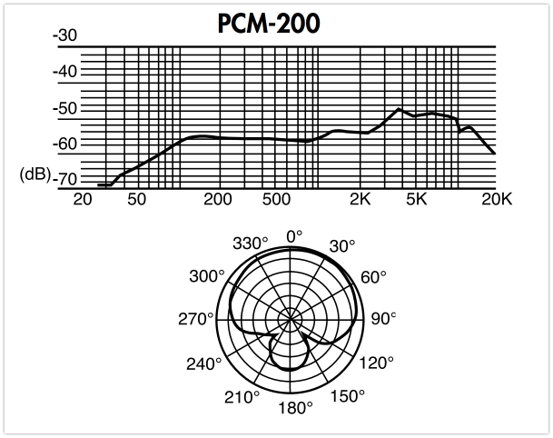

Is the crossover freq of that speaker around 500hz?
Its nothing but guessing but below quote and graph from post 377 could be some of the reason why distortion peaks at 500Hz and amplitude response have a such out there.
...P.P.S. Just noticed on the picture - I've mounted the microphone with its back "looking" at the speaker... not catastrophic, but not good - to be corrected next week
