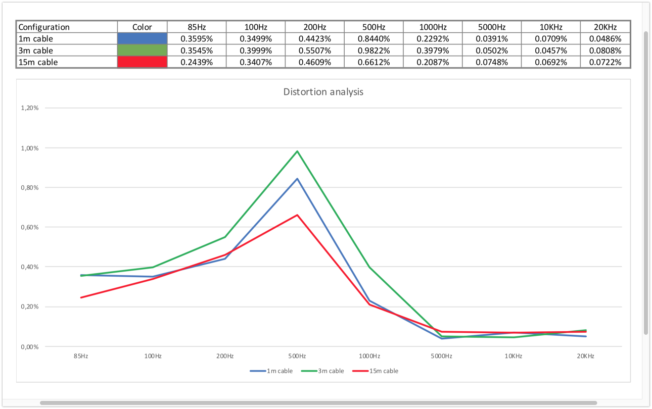

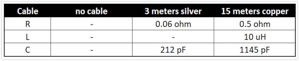

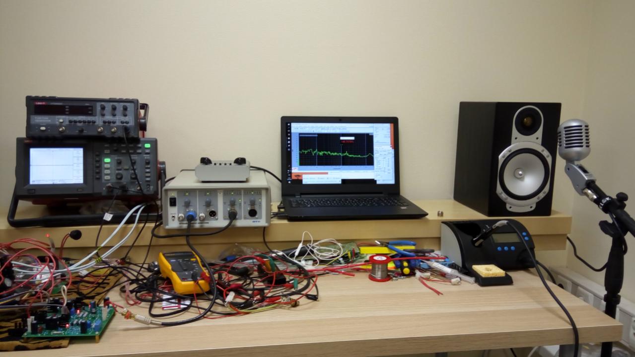

Microphone measurements
OK, let's see what we've got here.

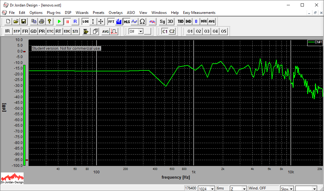

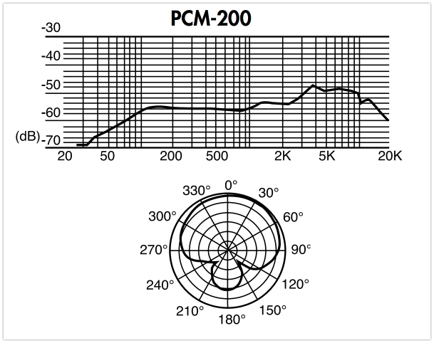

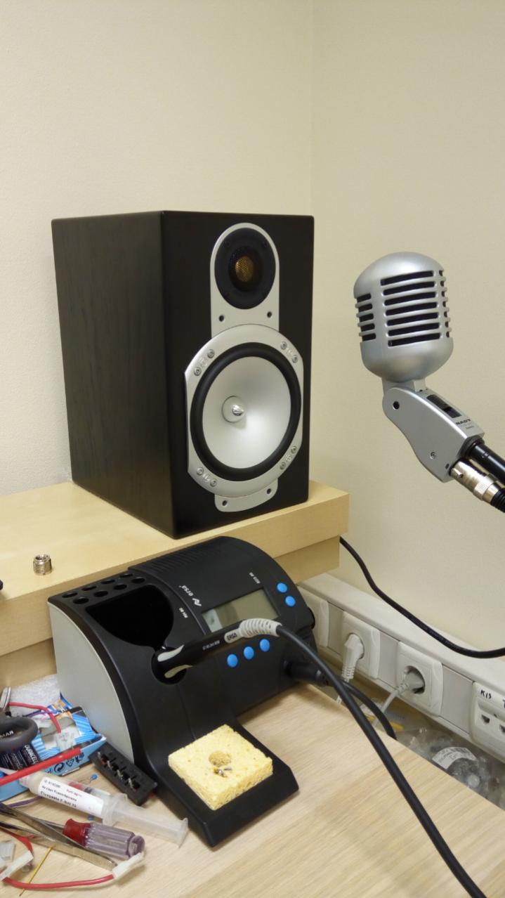

I didn't find my Behringer condenser microphone, so I used a dynamic one - not as neutral (designed particularly for voice), but anyway ok for comparative analysis.
The overall frequency response (measured with MLS signal) of the whole system - amplifier, cable, speaker, microphone, mic-preamp - is horizontal enough up to some 8KHz. Certain "presence peak" is clearly visible - it's coming from the microphone. What I didn't expect is the "hollow" at 500Hz - we didn't see any impedance or distortion anomaly there when measured at the speaker terminals earlier. I believe it's related to some acoustic effect (reflection in the room?).
All the spectrums show clear H2 and H3 dominance - neither the speaker nor the microphone produces any high-order stuff - example at 100Hz with 15m cable is attached.
So - the resulting curves. The highest distortion is shown with the 3m cable. Then goes the 1m one - ok, that's what I expected. But then the 15m cable goes even lower. The one, having the highest Z, performs the best. My thinking - it "normalizes" the speaker impedance, as a far-end Zobel would do.
Next step would be trying some Zobel network at the far end of the shorter cables - Nelson Pass suggested this approach at the beginning of this thread - now it's a good time to test the thing.
Any thoughts are welcome ;)
Valery
P.S. I continue trying to find by Behringer - it's much more neutral in terms of the frequency response, giving less distortion at the same time.
P.P.S. Just noticed on the picture - I've mounted the microphone with its back "looking" at the speaker... not catastrophic, but not good - to be corrected next week ;)
