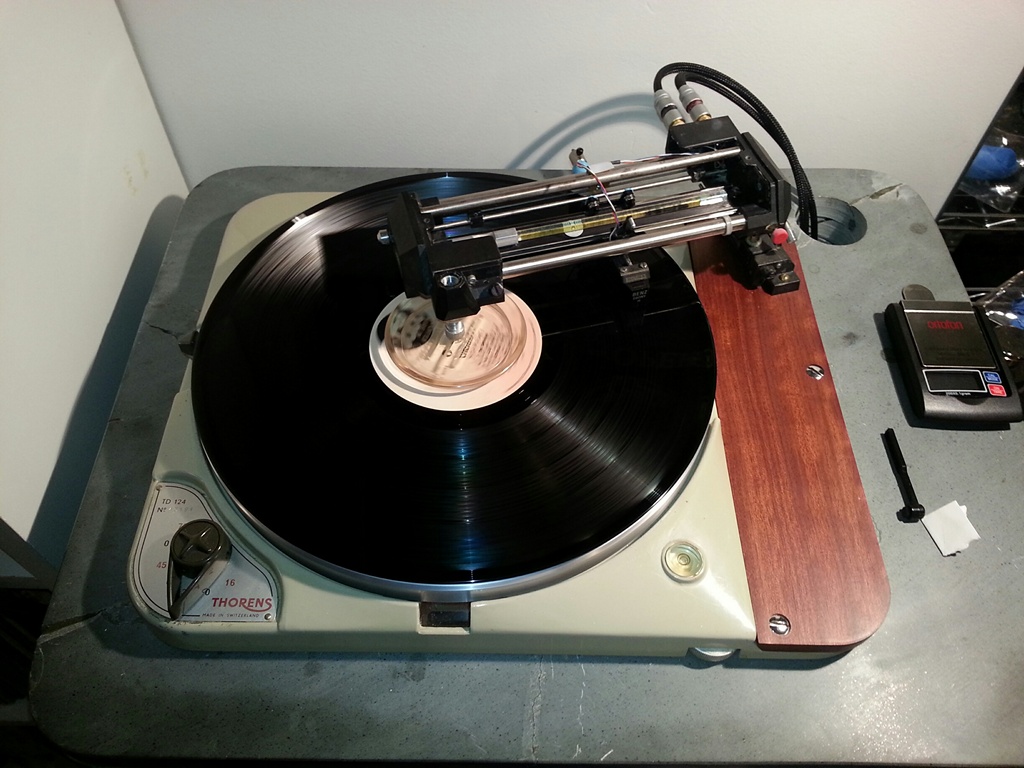

Tracking force issue has been resolved with the new scale, its design makes slipping it in under the stylus very easy with the arm properly set up.

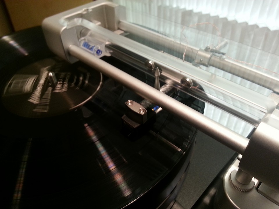

The other news of note is in a moment of insanity or inspiration I stuffed one of my hollow titanium arm tubes completely full of cork. (This is NOT reversible!) Quite laborious, and yet surprisingly effective, for a gram or so of additional mass the HF sibilance on some material has been killed deader than dead. Playing the worst case vinyl now and not a peep.
A friend and I are planning to make some new arm wands in various materials for evaluation.

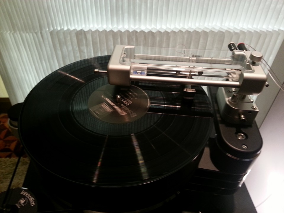

I got to play with a TT-3 at the Salon Audio show in Montreal yesterday, quite interesting arm that exhibits many of the same strengths and weaknesses as my much older Southers. Overall I liked it quite a lot. (It's a lot more refined)

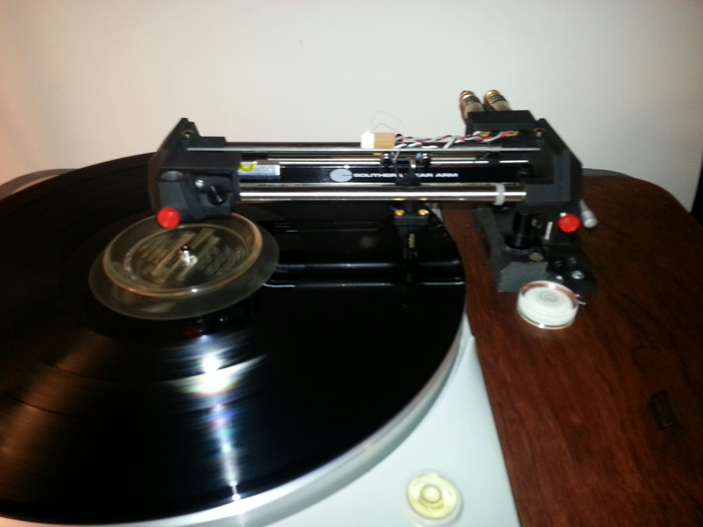

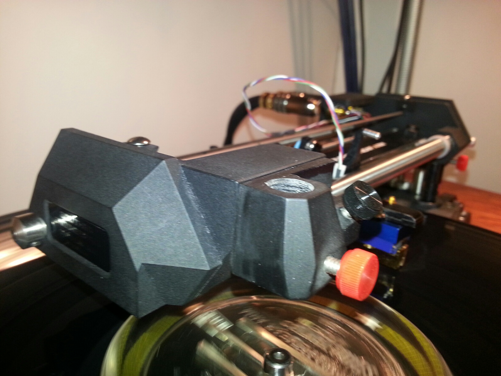

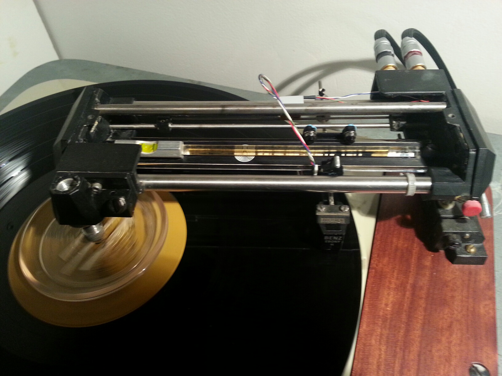

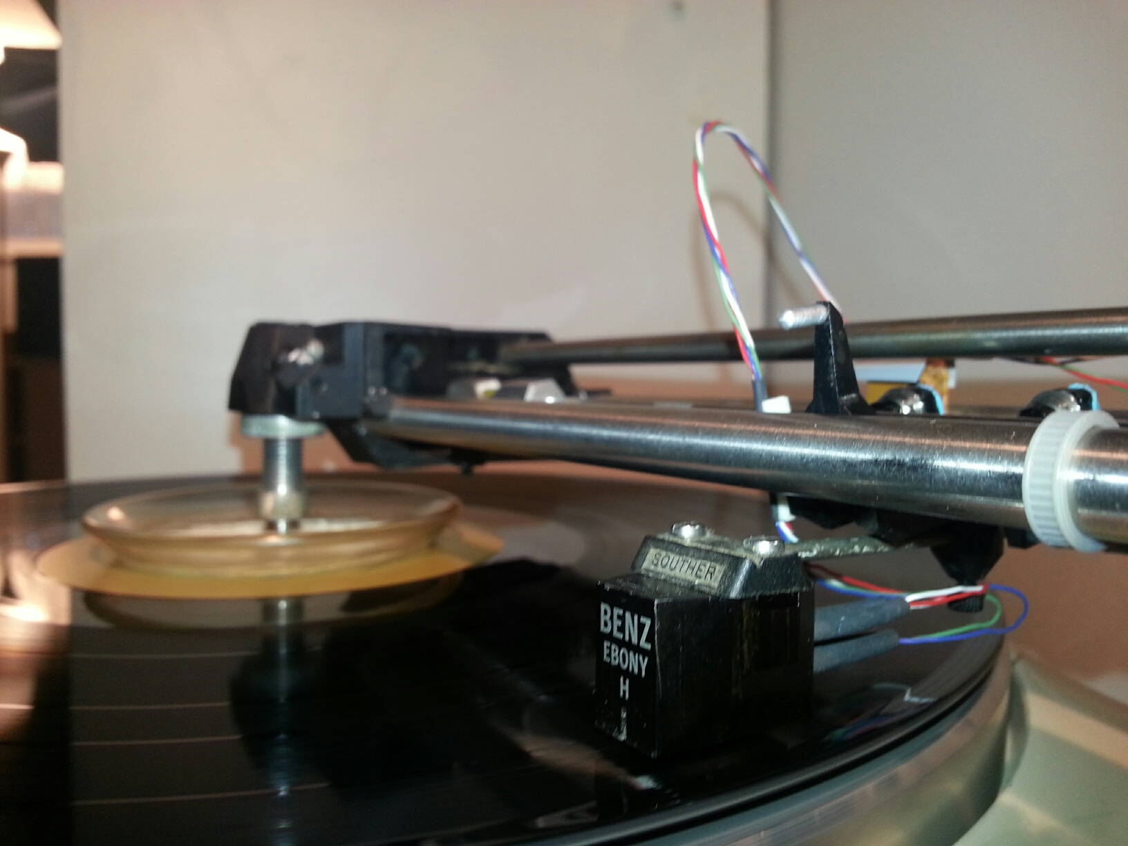

A couple of pix as the SLA-3 currently stands. Next I am going to replace the wiring. I noticed on the TT-3 that the arm cable goes directly to the RCA jacks which is I think I am going to do, it eliminates the intermediate connector but retains the RCA jacks which I find convenient.
Kevin,
What tonearm wire are you going to use? The original cable on my SLA-3 is starting to fray and may eventually fail. I've looked at the Cardas Clear and may order some to try.
I see you still have the wire cable guard installed. It could be another source of unwanted resonance. You should try removing it. Mine came off very easily.

Hi Dave,
Given my fumbled fingeredness I figured I would leave the sleeving alone and set this cable aside at some point soon. I assume you are talking about the very flexible heat shrink tubing on the cartridge end of the cable.
I have a Clear Audio super cable that I will try with a 4 pin header before I proceed with further wiring modifications which will require new wire.
My understanding is that Clear Audio can provide replacement wiring for these arms, that said I have not found the U.S. distributor to be particularly helpful. Might have better luck talking to an authorized dealer who might have some pull with the distributor.

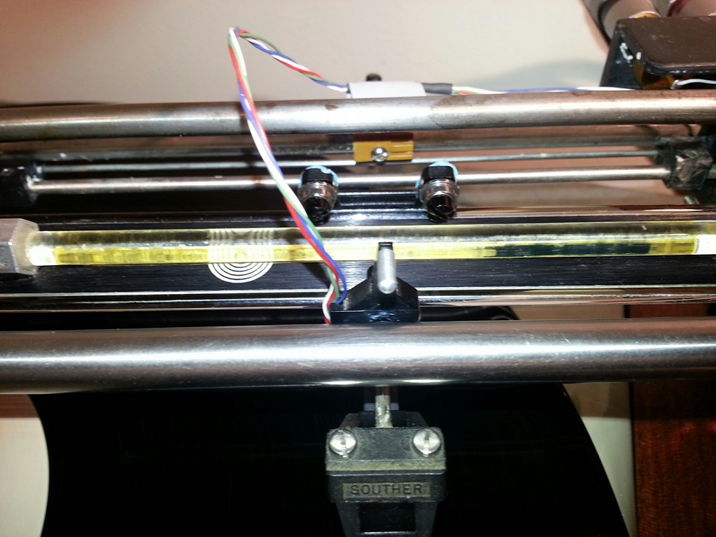

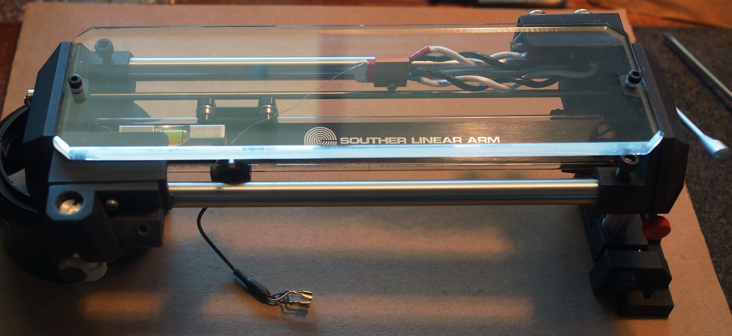

Hello Kevin,
Here are some pictures of my SLA-3. Sorry about the size. I couldn't figure out how to size them correctly. The third pictures shows my arm with the optional thick plastic cover. In the second picture, you can see the thin metal rod laying across the top of the arm, which Souther calls the cable guide. I took it off because it added resonance. It was simple to remove on my arm. You may want to try it out yourself.
Also shown are the two holes I drilled to add lead shot into the two metal tubes. I tapped them and used screws to seal them. This mod added a bit of mass to the arm and I believe this mod reduced resonance further. You can see the one shot I removed to show its size. You can fill these rods with anything you want even sand or glass beads.

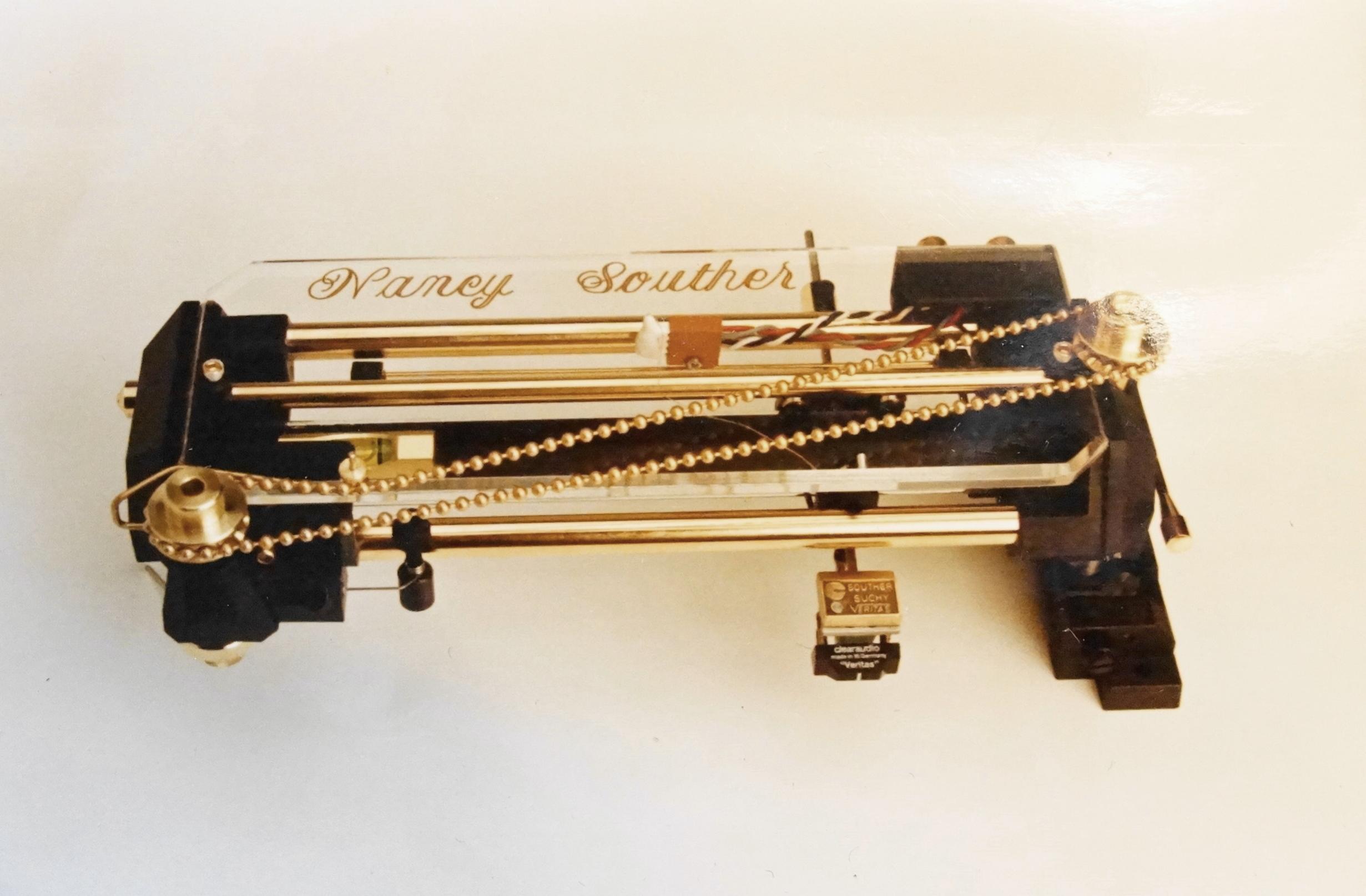

The first picture is a picture that I got from the Souther dealer when I bought my arm. I don't know much about it, but I think it was an attempt my Lou Souther to design the arm to be actively driven by the chain mechanism that you see. Any guess on how it would work?
David

Hi Dave,
The size of those photos is just fine. Great detail actually which is helpful in my on going mod plan.
My Tri-Quartz is heavily modified with many of the things you have approached from a different angle. The metal tubes on that are are filled with a mixture of sand and what appears to be acquaplas - not sure will ask the guy who gave it to me. This arm has a third large metal rod added as you may have noticed from pictures for additional stiffness - this was done at Souther's suggestion.
The SLA-3 has only some very minor modifications to date, but I will make some additional changes soon. I like the idea of lead shot or similar in the support tubes. The big change was damping a hollow titanium arm tube internally with cork - this has largely killed the sibilance issues I was having, careful adjustment of azimuth, overhang and VTA have helped with the rest.
I am also thinking about adding the third quartz rod found on the Tri-Quartz, although this really makes bearing replacement a pain in the butt.

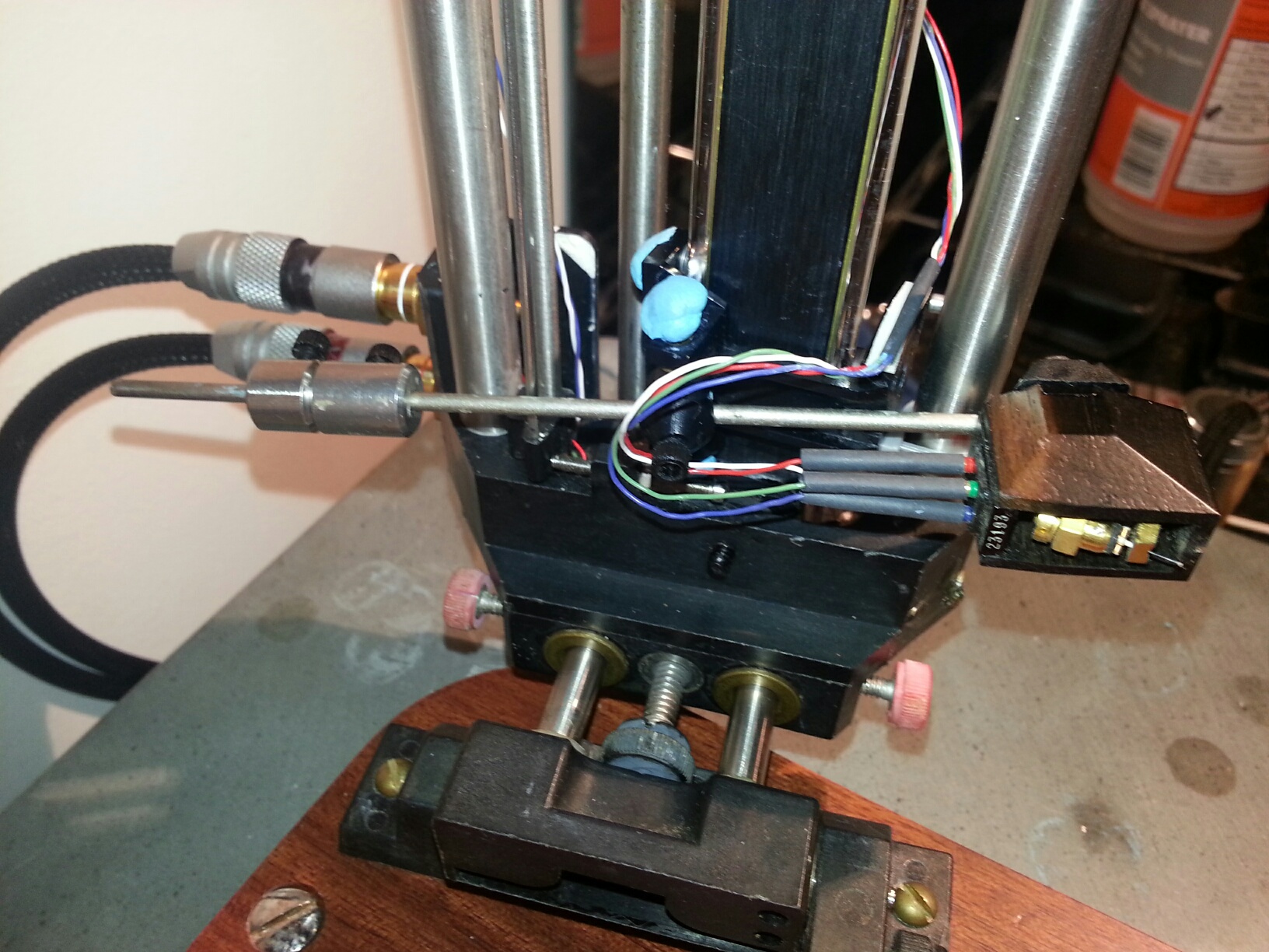

I ordered two sets of KAB super flexible 34ga litz tone arm wire, and some Cardas tags, it was cheap enough so that if it does not work well I will just use it for something else in the future. My plan is to wire directly to the RCA jacks as Clear Audio has done in the TT-3. My cartridge has a source impedance of 2 ohms so I am hoping to avoid adding excessive dcr in the signal path.
This will be the first major mod I undertake on the SLA-3, and I plan to install a new set of RCA jacks on the Tri-Quartz and do the same thing.
The source impedance of the Per Windfeld is low, and to my considerable surprise my expedient choice of unshielded interconnect works fine, no discernible hum pick up issue, at this point adding ground lift switches on the input of the SUT would give me balanced operation - something I will add shortly when I have time to order the appropriate switches.

I definitely have seen pictures of this particular arm before, I've never seen it in person though and have no idea what might have happened to it.
I assume there is a threaded lead screw hidden somewhere on the arm, but don't see evidence of it. I don't see how this could work, ever. Given its entirely passive nature and no defined groove pitch for LPs I don't see how it could maintain tangency to the groove over even a portion of the record being played.
I'm wondering if it wasn't just a humorous chain pull by Souther.

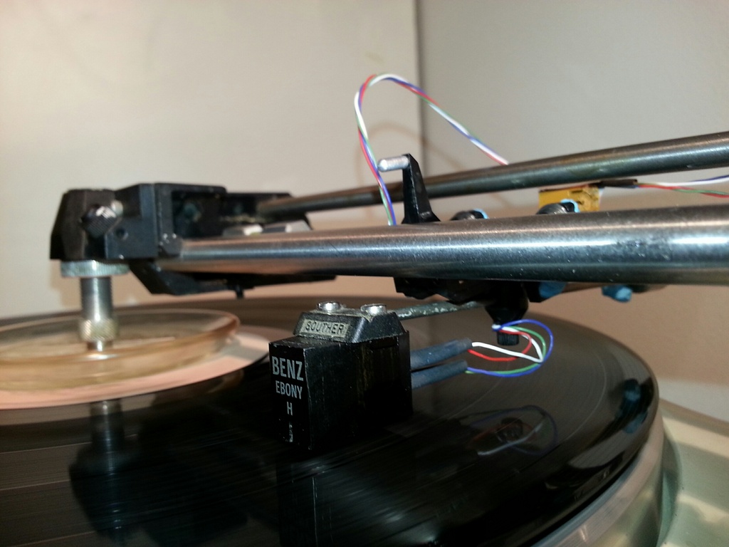

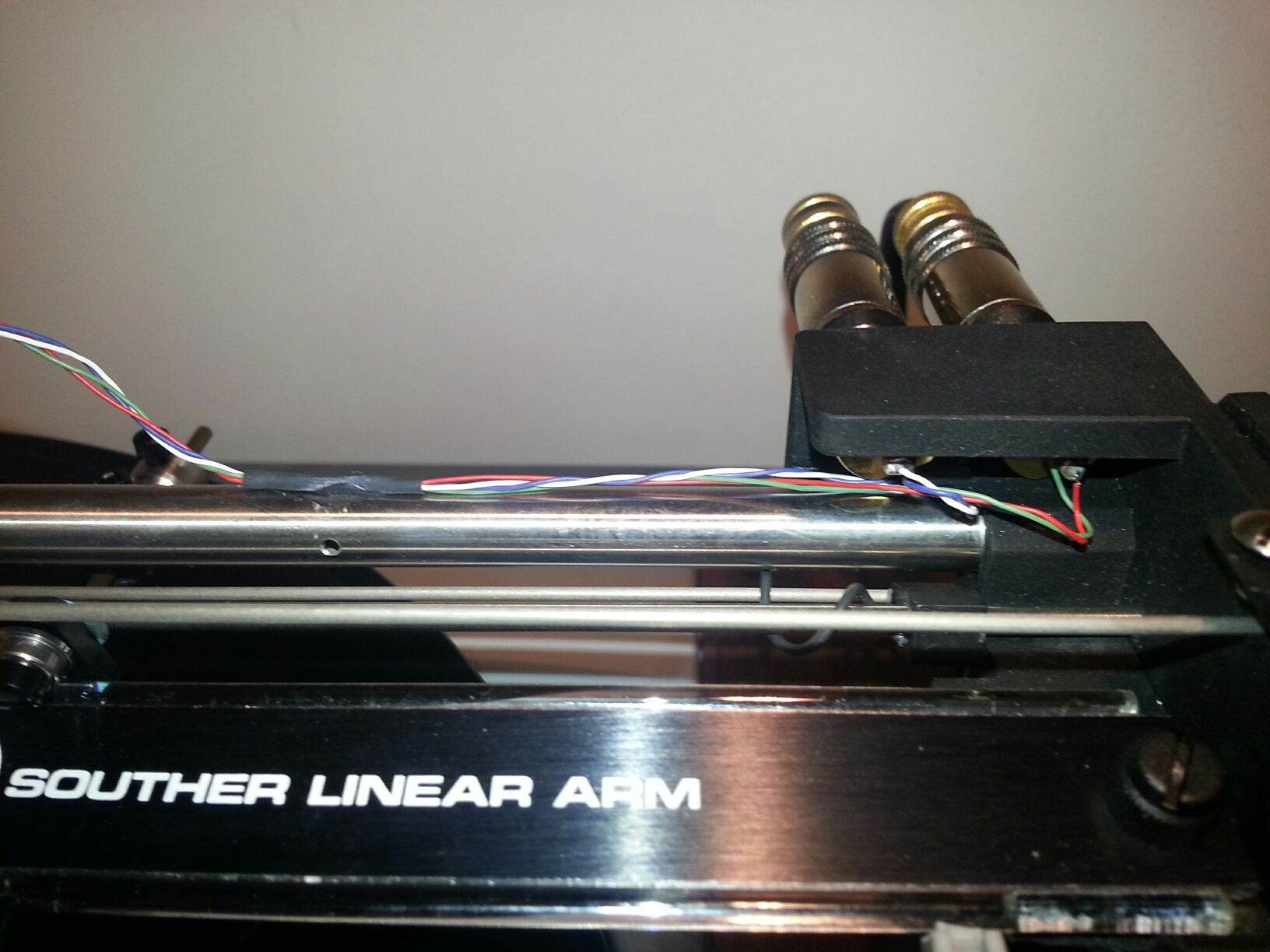

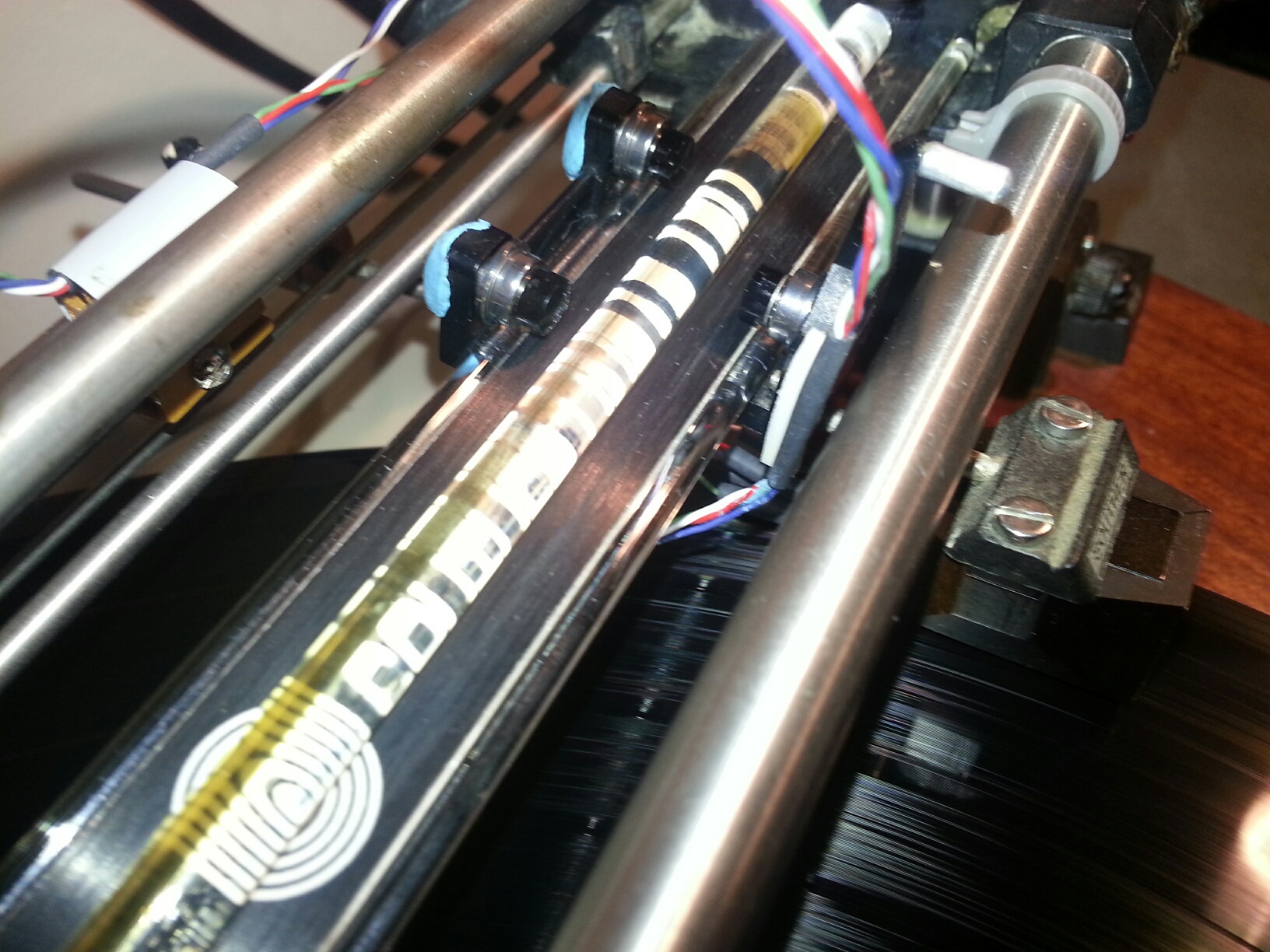

Tri-Quartz Rewire
I purchased some Kab super flexible tone arm wire which is 34 awg per for conductor. I was not entirely sure that it would work, but it turns out that 4 conductors of this are much more flexible than the rather stiff wire I had on the arm.
I also installed a set of RCA jacks on the arm, undoing one of the mods done by the previous owner.
I didn't really have a great feel for the dimensions of the wire and made it a bit too long to be honest. It doesn't look that great, but works fine. I would leave off the tubing I slipped over the clips as this and the thicker wire adds significant mass which may not be a good thing in some instances. (Here it does not hurt)
It is a vast improvement over what it replaced subjectively speaking (and to my surprise) - perhaps eliminating a couple of solder joints helped. The RCA jacks are Tiffany which just fit. (Pretty much nothing else did.)

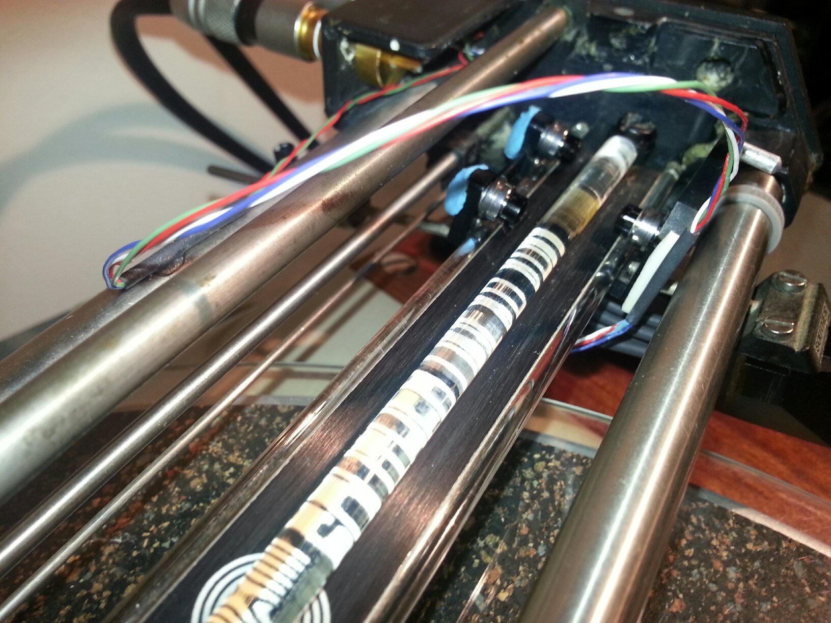

Figured out a better way to route the tonearm wiring.. Involved a wee bit of double sided sticky tape that I pressed the sleeve into the tape. This is a pretty major improvement over the kludged wiring I used previously.
This stuff is extremely flexible, it's also a bit heavy and created an issue with setting the tracking force which required the addition of an additional counterweight. In this case the additional mass is a benefit. This particular Benz model will never have great bass unfortunately, but otherwise performs quite well.

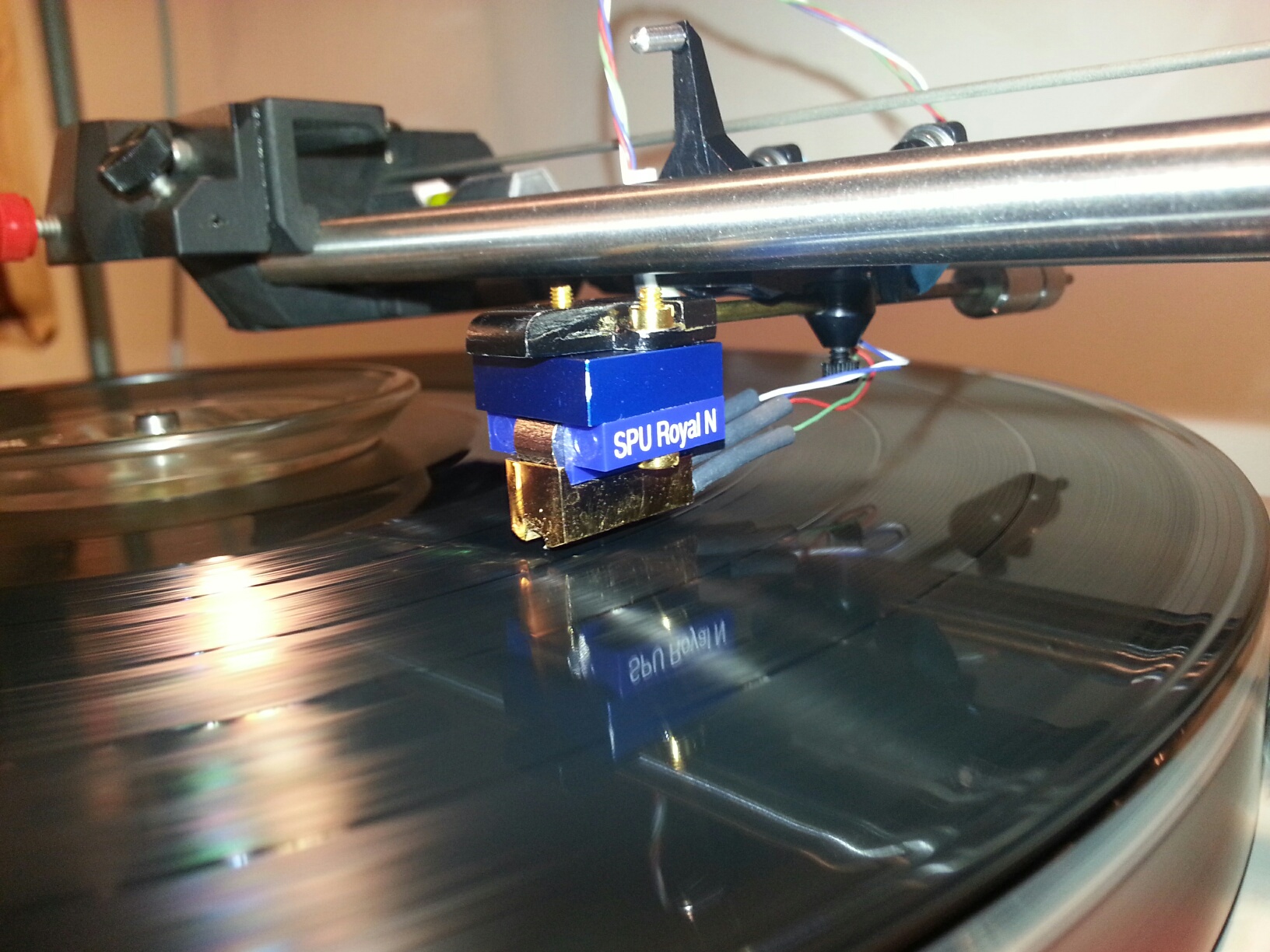

Cartridges:
- Benz Ebony H - best arm match I have heard with this cartridge. Bass is a bit wooly and tubby, but is worse on any other arm I have tried it with. Otherwise wonderful.
- Ortofon Royal N - Strangely this one works better than anything else I have tried so far. Sounds very good, no mis-tracking or other odd behaviors.
- Ortofon Per Windfeld - Problematic and not recommended at this point in time. Very promising, some of the best and worst sound depending on vinyl. Very unforgiving of VTA, azimuth and overhang settings. Substantial issues with sibilance, more sensitive to arm wand material and condition of carriage bearings than any other cartridge tried so far.

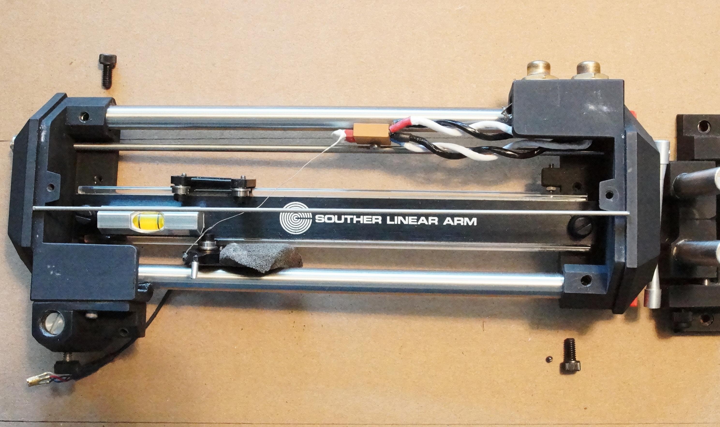

I went through the other thread and all of the mods you've done are on one of my arms. My Tri-Quartz has 3 rods as suggested by Lou Souther himself, the SLA-3 will get one relatively soon. The TQ is also full of lead shot, aqua-plas and sand.
Both are completely rewired and no plastic covers in sight.
One of our fellow members pointed to a replacement bearing that he thought would be a suitable replacement for the originals - seem to work better despite the presence of lubricant. Installed on both arms.
I put the support block I got with the TQ on the SLA-3 since that is the arm that went on the better table. The TQ was a complete salvage job.
I may or may not add the third quartz rod found on the TQ to the SLA-3, it creates maintenance nightmares (bearing service) and I am not convinced it is doing a lot.
On the carriage thing I use fairly heavy MC cartridges, tracking at 2 - 3gms and have tweaked the bearings and I haven't observed the rocking motion described to anything like the extent described, but I will watch for it.
Strangely enough a little blu-tac judiciously applied to key areas on the carriage seems to improve the HF behavior considerably. (Possibly I have deluded myself into believing this.. lol)
Late in life Souther started to recommend using heavier low compliance cartridges on his arms which seemed a bit strange to me, but I can report that the Ortofon Royal N with a compliance of 8 cu tracking at 3gms works really well, and will get moved to the TQ shortly. (The Windfeld went back on the SLA-3 last night and is working better than previously, although I think the custom arm wand when ready will be a better match to this cartridge.)

Some things to note:
**The SLA-3 carriage and the Tri-Quartz carriages differ significantly.**
**Arm Wands and Weights**
Neither of these arms have problems with skipping, HF mistracking can be a big problem with the hollow arm tubes even when internally damped. I won't use them in the future, and the arm wands a friend and I are getting ready to make will use a variety of solid rods.
- The vertical bearing and mount on the SLA-3 has a round hole designed for 3/32" O.D. arm tubes only. Both solid rod and hollow tube arm wands were available.
- The vertical bearing and mount on the Tri-Quartz has a rhombus shaped hole and will accommodate both the older 3/32" (0.094") and the later solid 0.105" diameter rod based wands.
- Hollow and solid arm tubes differ in length, with the solid arm tubes being slightly longer.
- Hollow wands are rather light at ~1.4gms
- Solid wands are much heavier at 4.5 - 5.0gms.
- IMLE the solid wands perform much better.
- Weights are typically approximately 2, 4, 6 gms, a single 10gm weight would in many cases be useful with modern MC cartridges.
