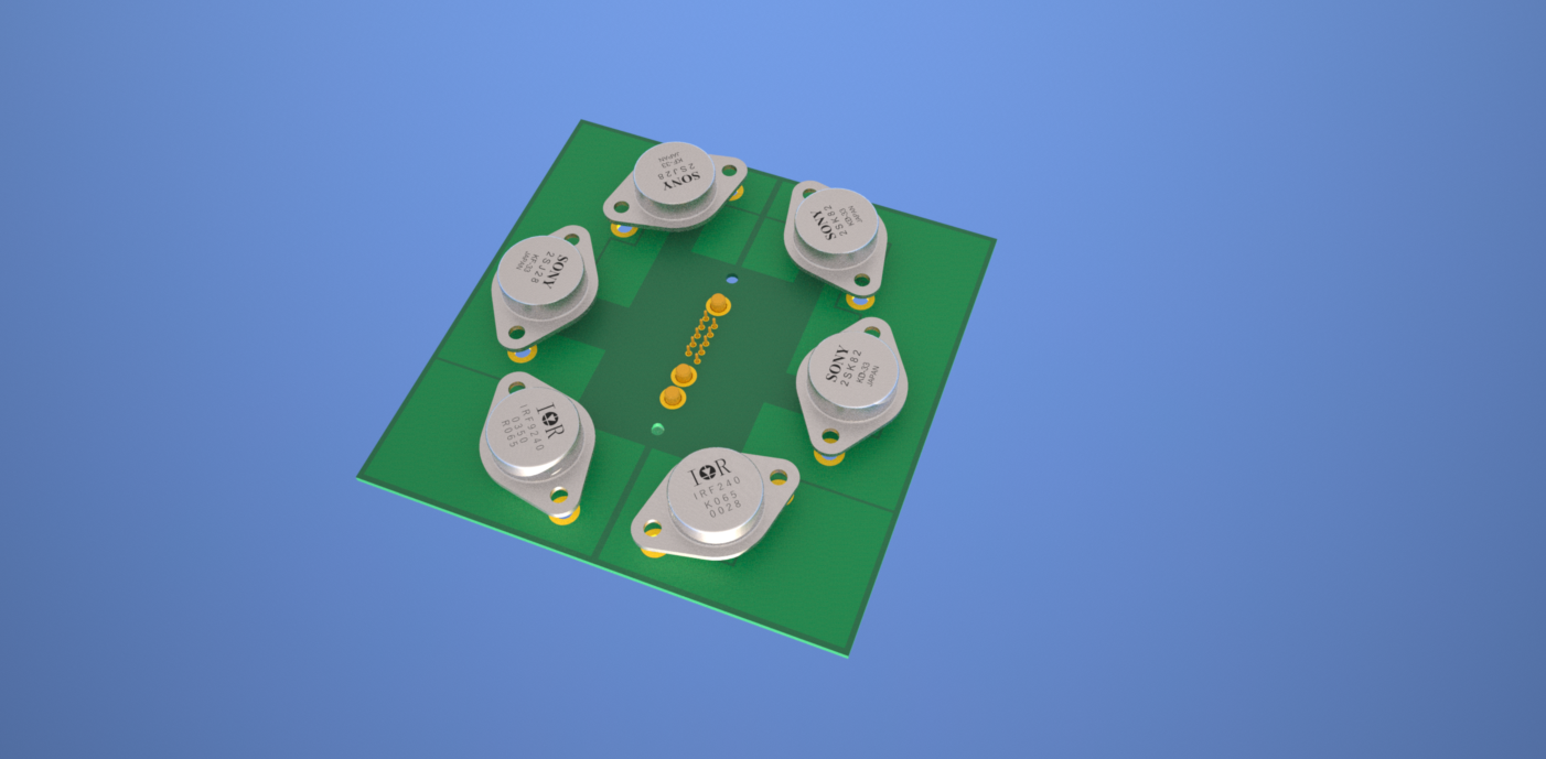

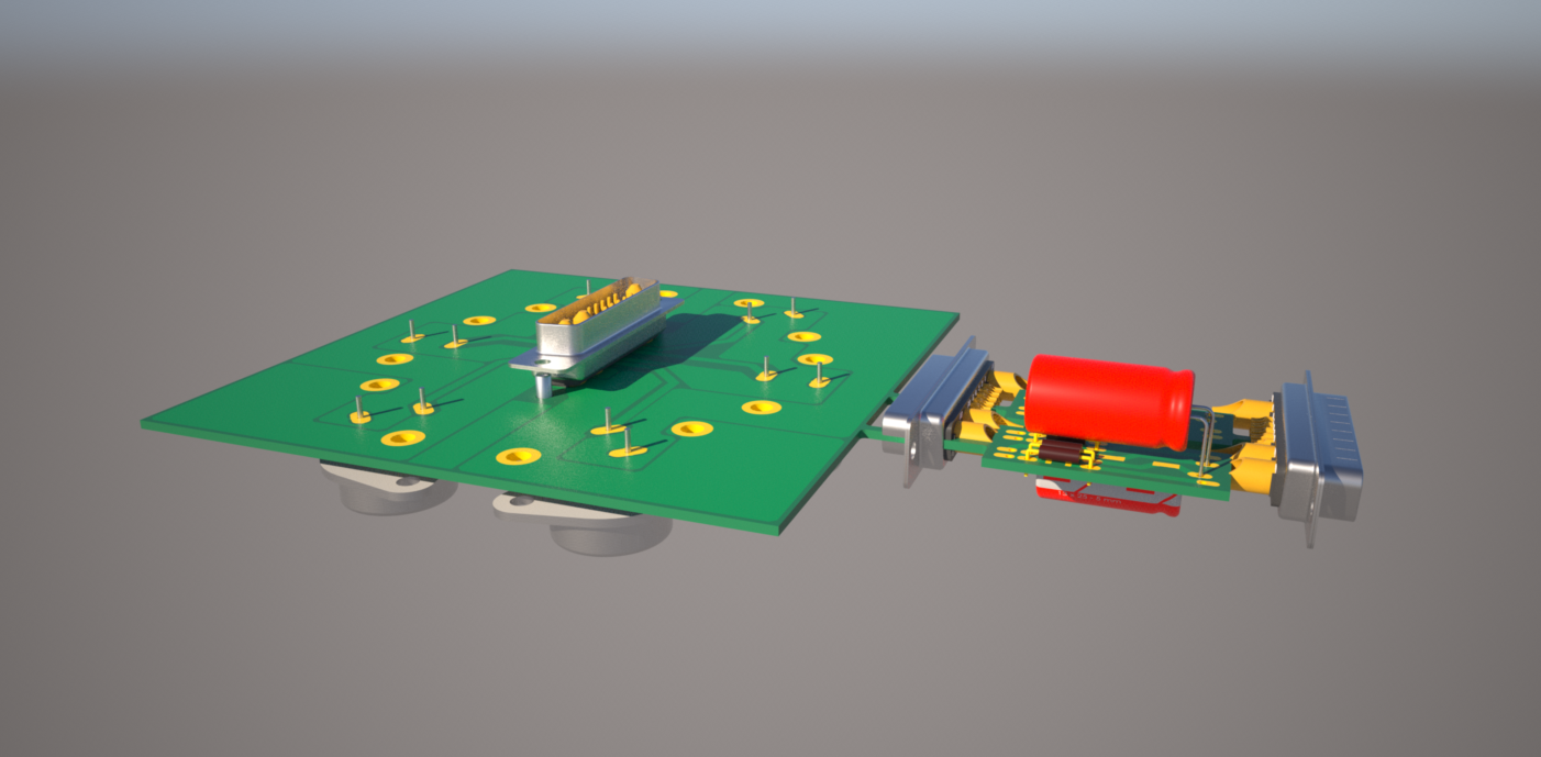

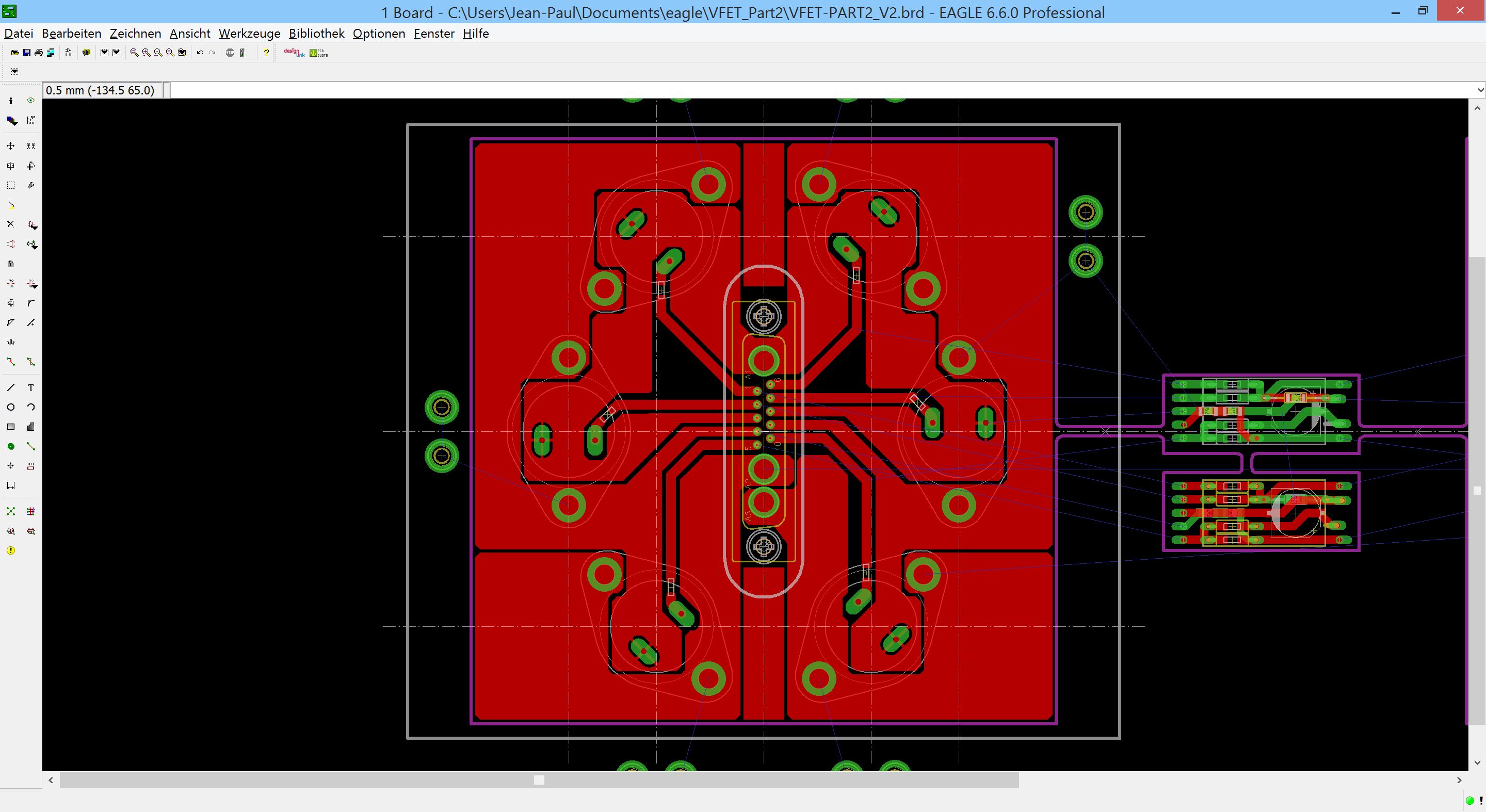

What are the thermal requirements for the heatsinks? K/W?

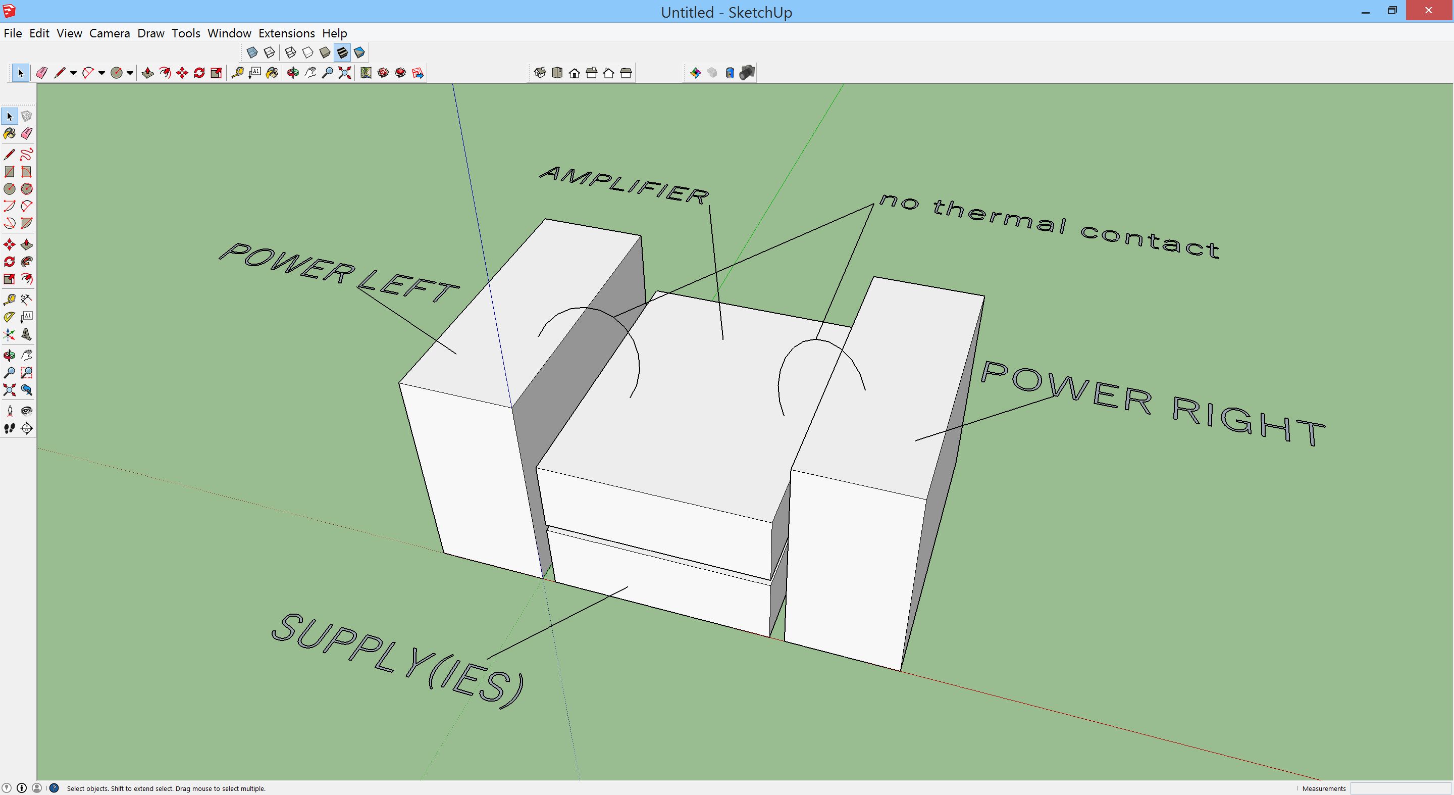

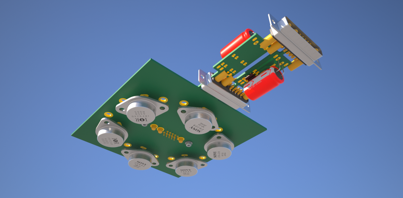

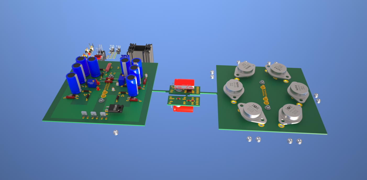

The POWER LEFT/RIGHT parts of the amplifier are connected with following BRIDGE to the AMPLIFIER part (SMD or THT are possible).
The choice of the heatsinks defines the dimension of the overall amplifier: you choose 300mm and 5U then the deepth is 300mm and the height 5U minimum (the POWER LEFT/RIGHT PCB is centrally mounted: I suppose the heat is radiated from the FET´s away; some FLIR measurements should be nice and helpfull).

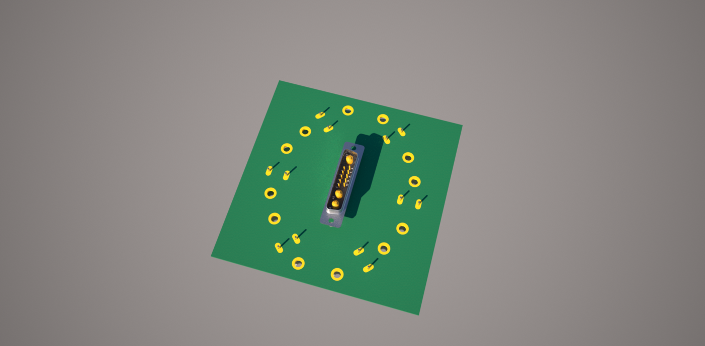

I know, but no components except mosfets in the power part, thats the challenge!
This is not a good practice. The gate resistors must be as close to the gate pins as possible.
I know that the resistor should be so close as possible near the gate.
... take a look at Mr. Pass layout, or Tea-Bag´s layout: the resistors are not so close anyway...
Simple question: did the temperature have an influence of the behavior of this resistors? No, then I will place this 221R and 1k0 as short as possible near the gate!

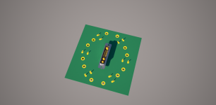

Jean-Paul,
You seem to have the skills, time and energy. It would be great if you designed boards that could be bolted to a L-shape or T-shape aluminum profile attached to a MF35-151.5 Conrad heat sink. Conrad Heatsinks - Products
The boards should accommodate 2 pairs of VFETs and use TO-247 package for the MOSFETs. The boards should also be symmetric single pieces, one for each channel, similar to what Nelson presented. I would be certainly interested in buying them.
