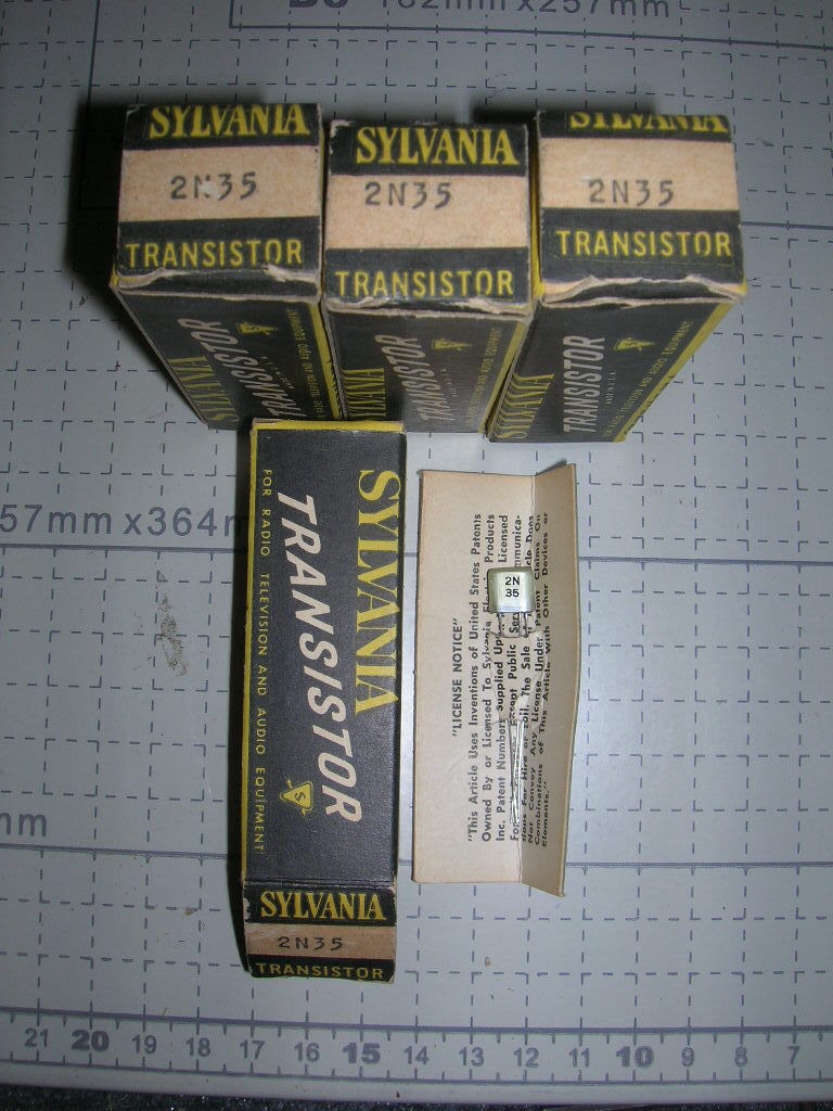

Early days transistors was sell in packaging boxes similar to vacuum tubes
Oh old good days nostalgy let's go see what bring us the future

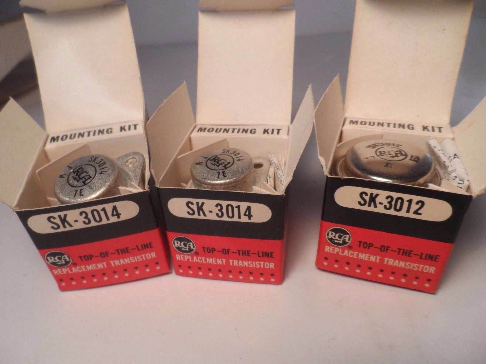

RCA logo
Don't you love that old RCA logo?

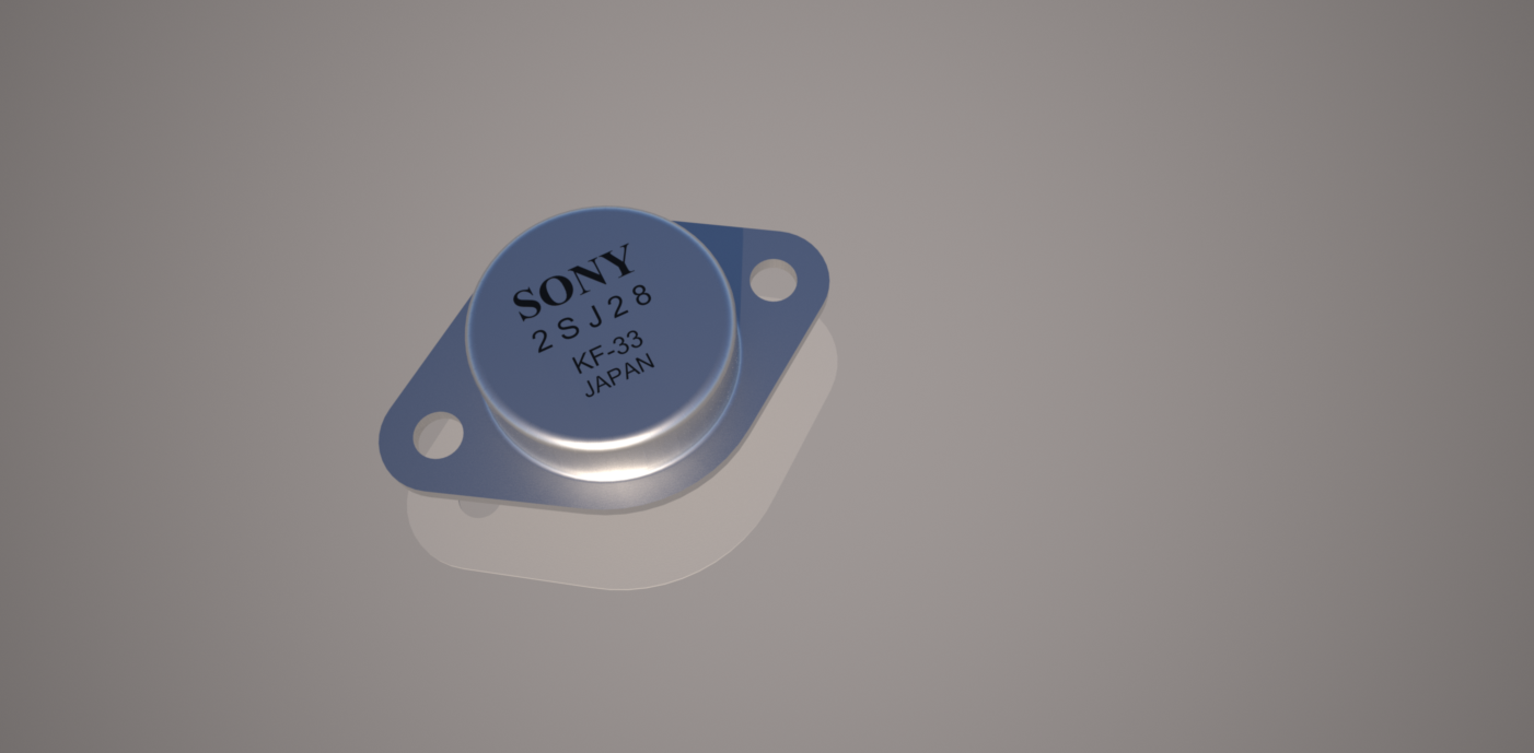

Haha imagine we can buy at 2015 such transistors from Mouser
Excellent vintage

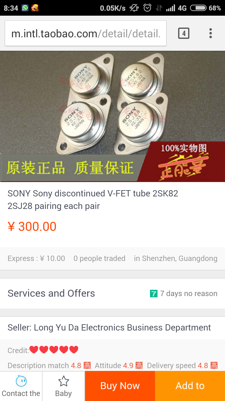

but any of member here who bought from taobao store?
m.intl.taobao.com/detail/detail.html?spm=a1z5f.7632060.0.0&id=40300679359
i'm still waiting 4pairs of them that was send thru sea shipping, dont know when it will arrive. hopefully they are real, just realise that i only paid ¥200/pair, a lot cheaper that acronman sold for $40/pair
hopefully the letter on taobao picture means "100% original, return if they are fake"

Note that not every country can shop with TB, and many TB sellers cannot communicate with English (not sure about this one). I bought some Yamaha 2SK76/SJ26 from this shop before, and as far as I can tell they are authentic.
Hi Walter, i bought them from this store but the seller does not use english and the price already increase 50%

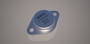

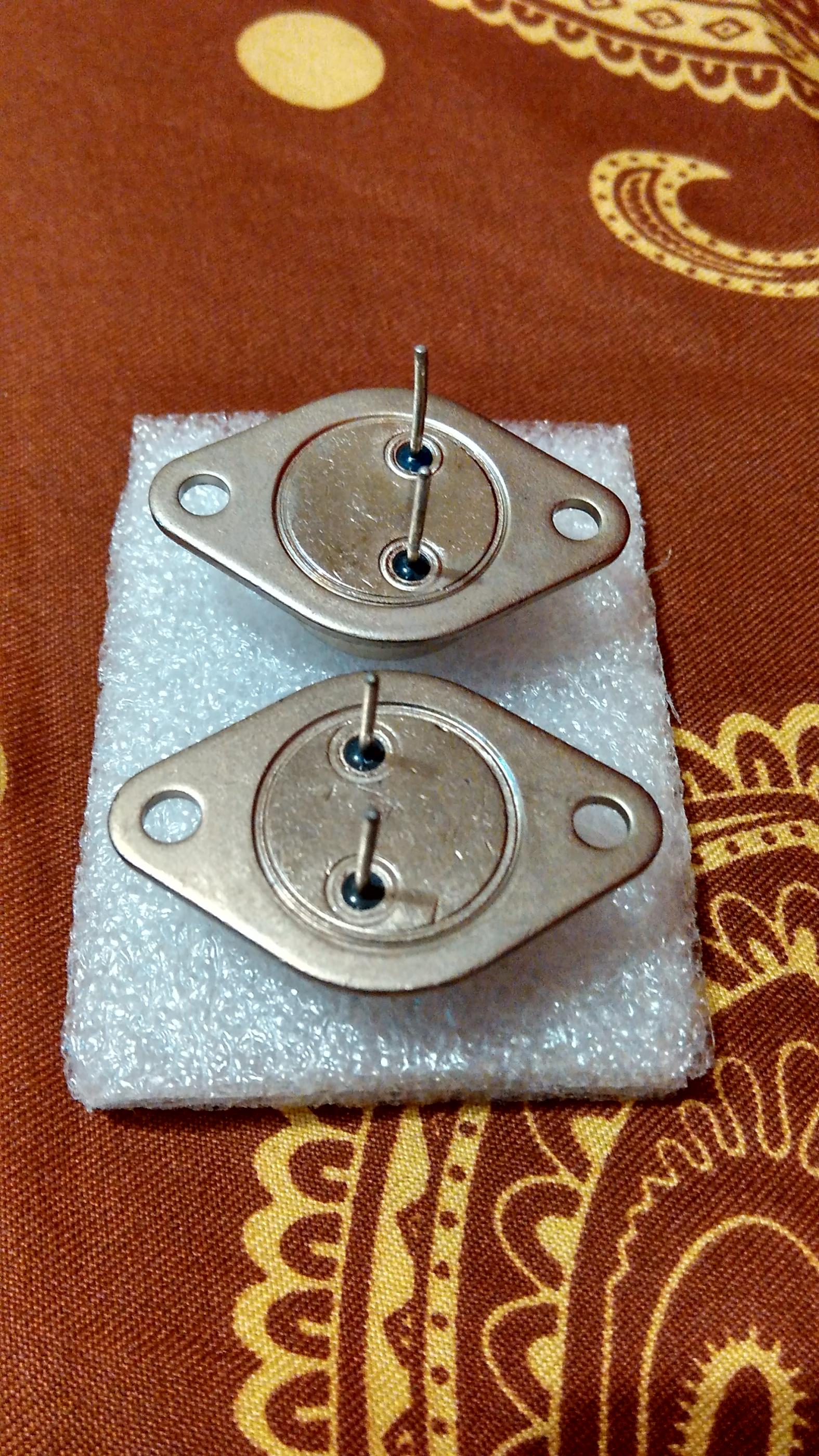

tonight when i get home, i'll get a close picture side by side with KD-33
when i flip those 2 vfet, tadaaa the G and S position is opposite to KD-33. is this possible?
That's not a good sign.... my fakes (relabeled 2SK60's) had that same feature...
You have to measure them to tell if they are real or not...
Yes it can.
Yesterday I tested two paralleled 2SK60s, they have exactly the same curves as one 2SK82.
But as Zen Mod already said, since they are used here as followers, and at only 10 Watt ( 19V x 0.5A) per device, it can be a direct substitute.

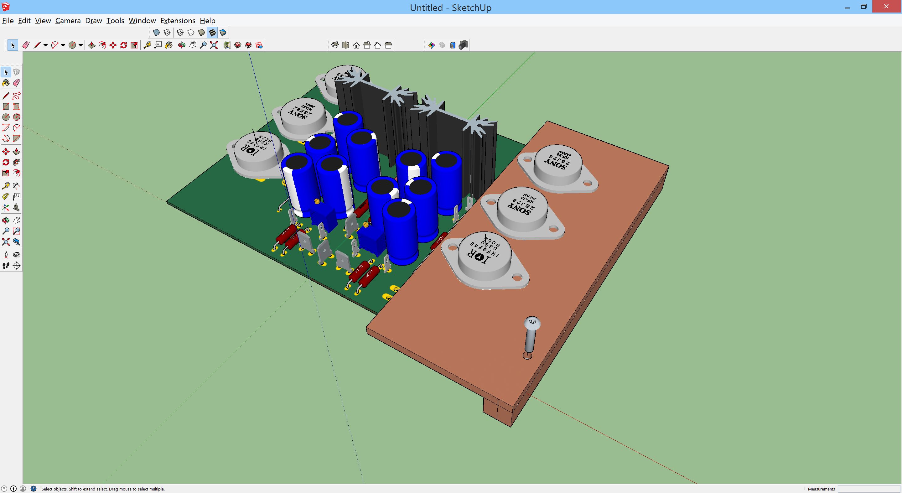

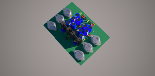

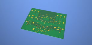

PCB equipped with heatsink alu plate (or copper or...).
Mounting PCB verticaly to heatsink (faston for power input on bottom; faston for IN on top; faston for OUT in the middle) and screw it!
I need urgently the values for Q13 and Q14 so I can finish the PCB and start with the mechanic...
