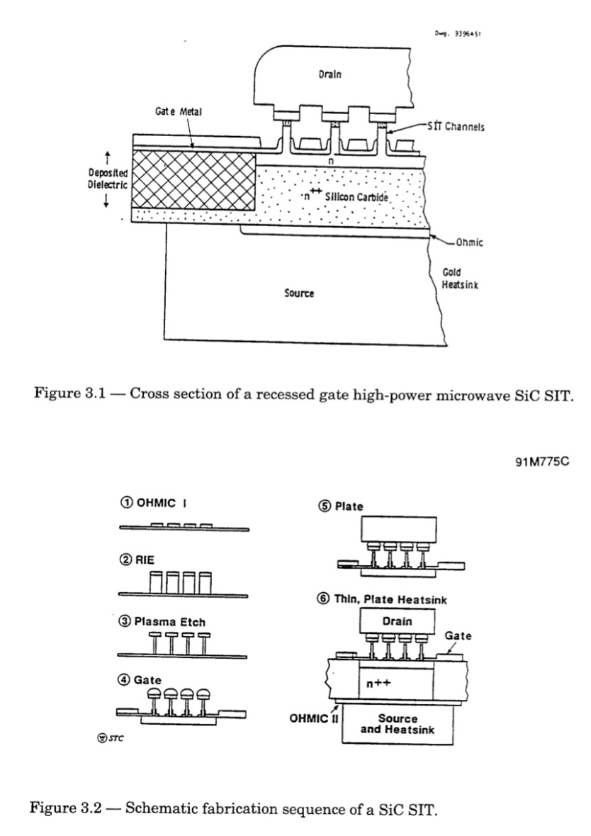

I was sought of hoping that $10,000 to $20,000 would cover it. :(
I might have a go at trying to make one in the lab for fun. No I dea whether I'll be successful but fun to try.
Are the patents still available online somewhere?
Specialised tech documentations about manufacturing of semiconductor triodes are not for free example : IEEE source
but we have lot information on line
www.dtic.mil/cgi-bin/GetTRDoc?AD=ADA299605
http://libinfo.uark.edu/aas/issues/2003v57/v57a31.pdf
Patent US4889826 - Static induction transistor and manufacturing method of the same - Google Patents
Kick Starter or https://www.rocelec.com/
Kind regards :house:

The semiconductor fabrication process involves much more than the geometry of the device. The geometry of these devices should be no problem, but the doping and other process details could be non-trivial and certainly not something for amateurs.
OTOH, it would be really nice if someone acquired an old fab line and had a knowledgeable old geezer who could make these devices.
