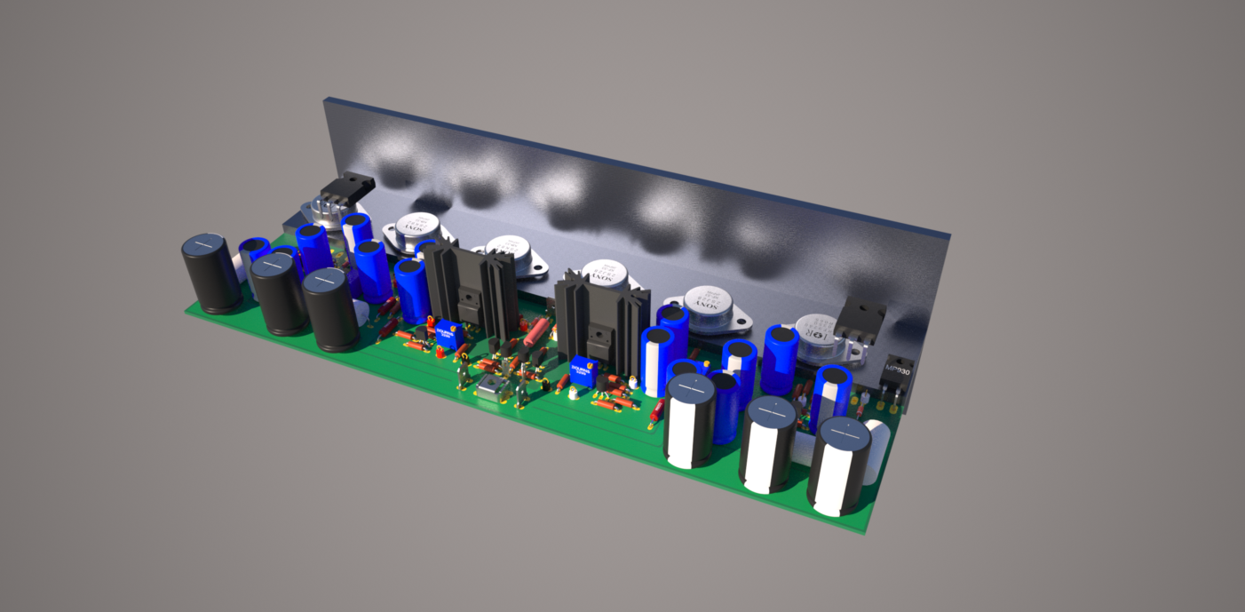

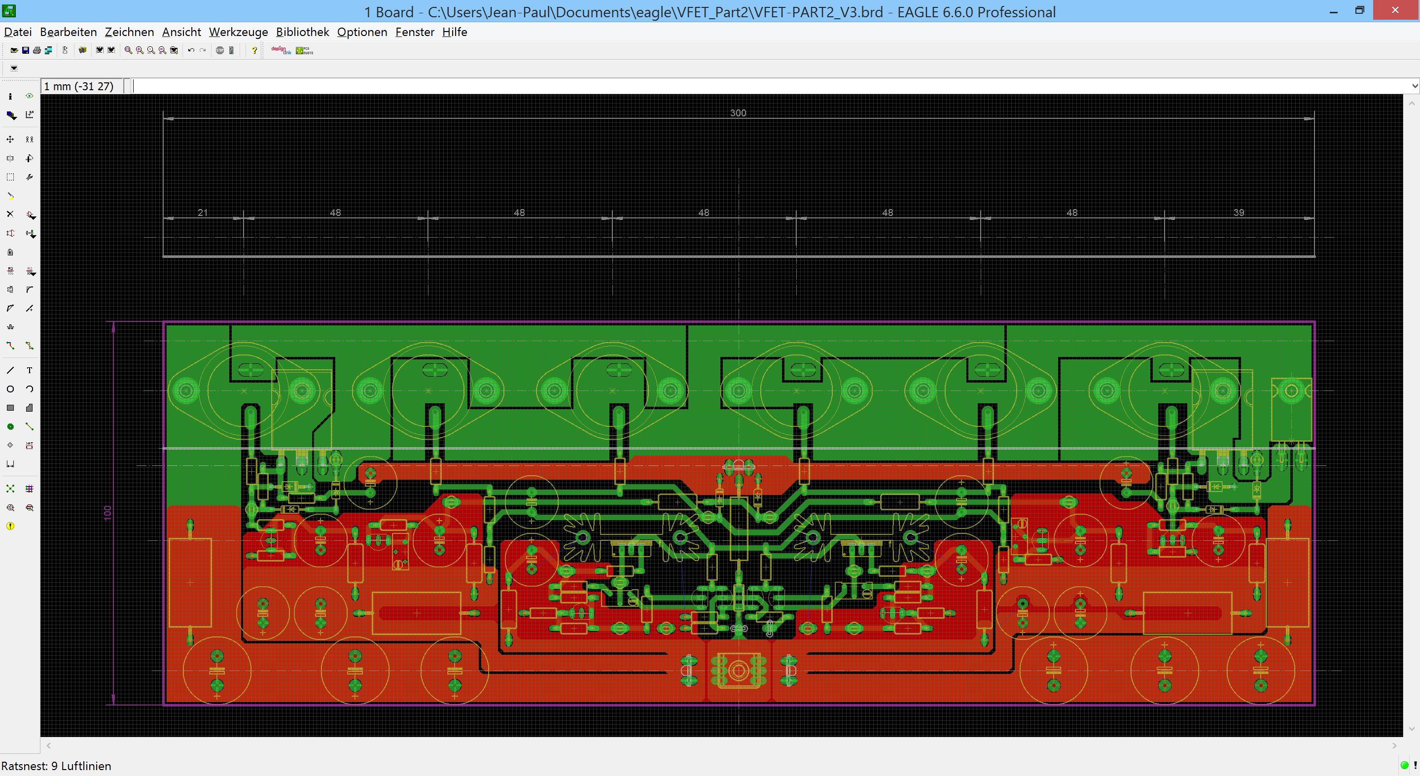

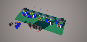

300x100mm; only THT components; some more reservoir and filtering capacitors should be equipped on the board.
I´m curious about comments?!
I will switch to the B1-BUFFER...
That is certainly looking good.
PCB layout ..can you post ? ( i mean the 2D version...)
