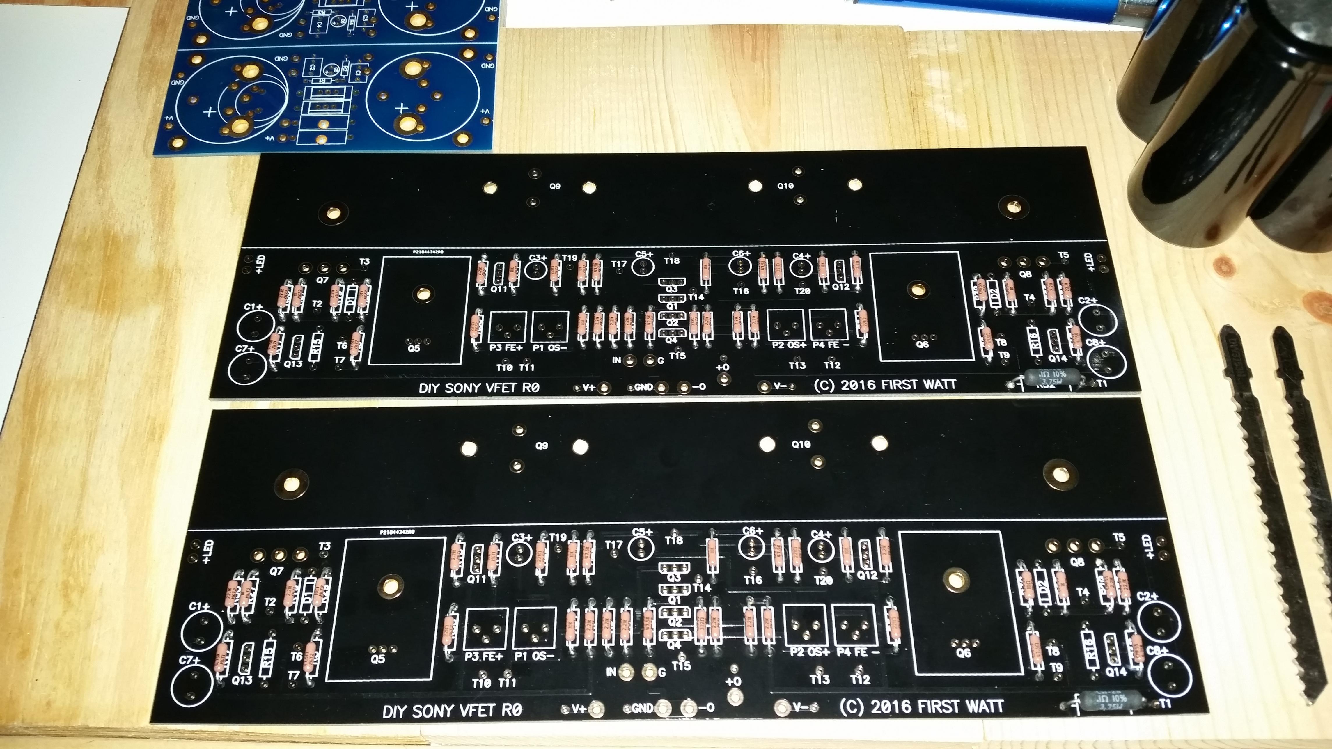

I use the flat jigsaw blades to leave a gap beneath the resistors and the board. They're smooth enough that they slide right out when done, without damaging anything.

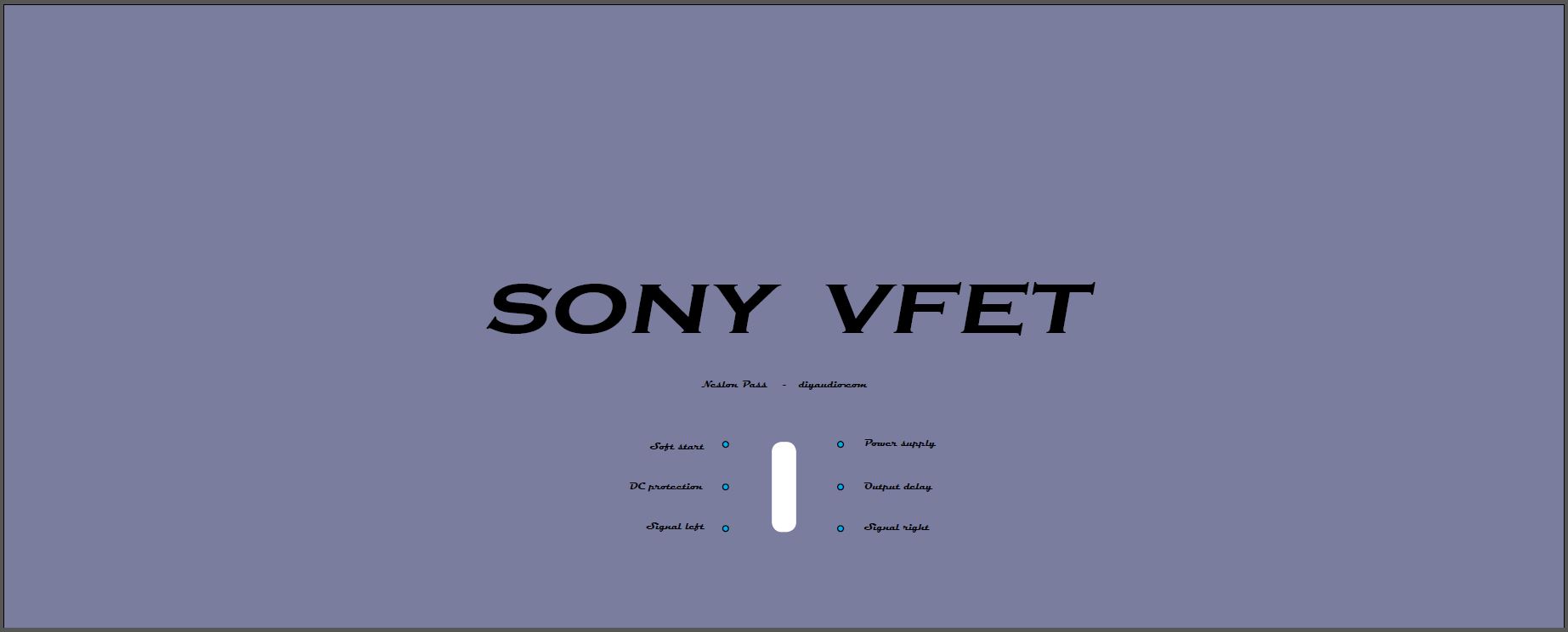

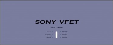

This is the frontplate I´m planning on for my one vfet amp. What do you think of using the word "SONY" on the front. It is a brand, should I not use it? Other comments are welcome too.
Well, it's not like you are planning to market and sell your own line of amps under the Sony label. And the amp does have Sony VFETS in it, so I think you are okay.
But definitely proofread for typos before sending the plate out for printing! :D
