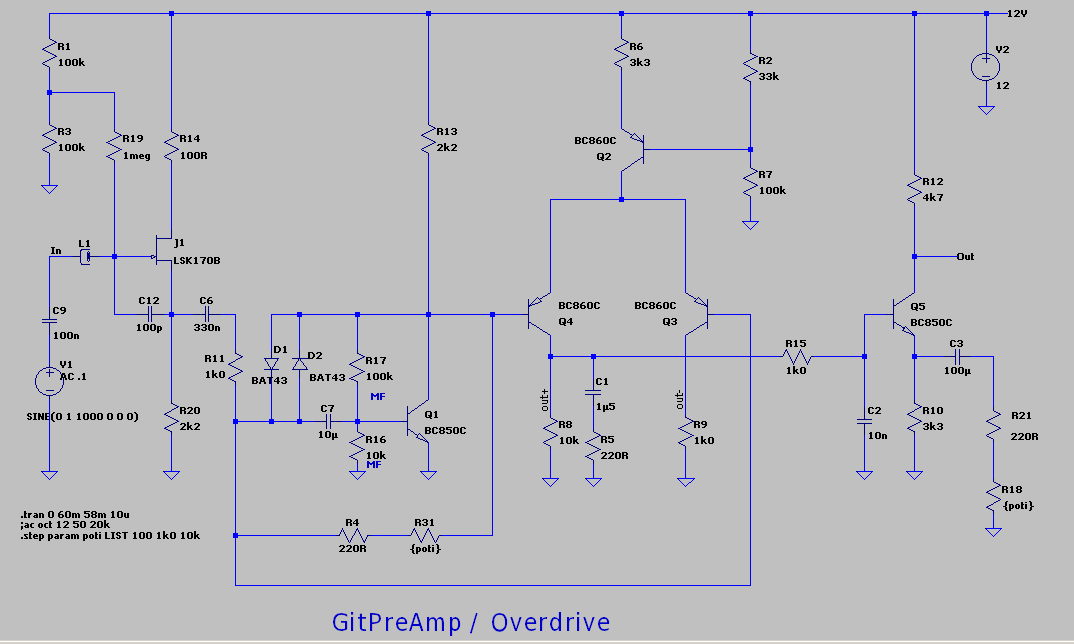

Input with overdrive looks in LTSpice like that:
View attachment vorverstaerker_preamp_bluesman_2012_10_31.asc
It should be noted that
-Both Si-diodes are intended to prevent excessive differential input levels only, inhibiting any blocking distortion.
They do NOT contribute to distortion as diff pair distortion takes in at much lower levels.
-There is a significant bass cut before the overdrive and reciproke bass boost at the output. This improves response to chords.
-Overdrive is set by a tandem pot. The second section serves loudness correction.
-The range is from very close to clean upto heavy overdriven sound.
enjoy!

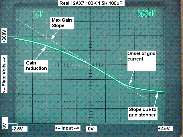

Below is an X-Y plot of a 12AX7 input vs output. You can see the non-linearity as the tube goes into cutoff. This is the characteristic that gives a tube preamp it's even order THD.

That was taken with a triangle wave input, I take it, or some sort of similar linearly increasing ramp voltage?
I usually use a sinewave and you have to adjust the frequency to get minimal looping. Most of the time it's between 200 and 500 Hz. I should mention that the circuit in the above post had a 33K grid stopper. The high frequency roll off causes a slight phase shift at the plate which causes the scope to display a loop.
Thank you for sharing the details. I really like the technique you're using to look directly at the voltage transfer function of a working amplifier (single stage or more).
I have only once before encountered a similar set of plots, somewhere on the Internet, years ago. Those were obtained by driving a valve preamp (Fender, I think) with a trapezoidal signal - a triangle with the tops and bottoms cut off and replaced with flat plateaus. I don't remember the frequency range used, but it was within the normal range of guitar frequencies, and probably near the middle, just like the frequency you picked.
In effect, the amp was driven with a linear ramp with input and output voltages monitored, then given some time to settle down, before the signal repeated again. I think the scope was set to single-shot mode, but I'm not positive about that.
