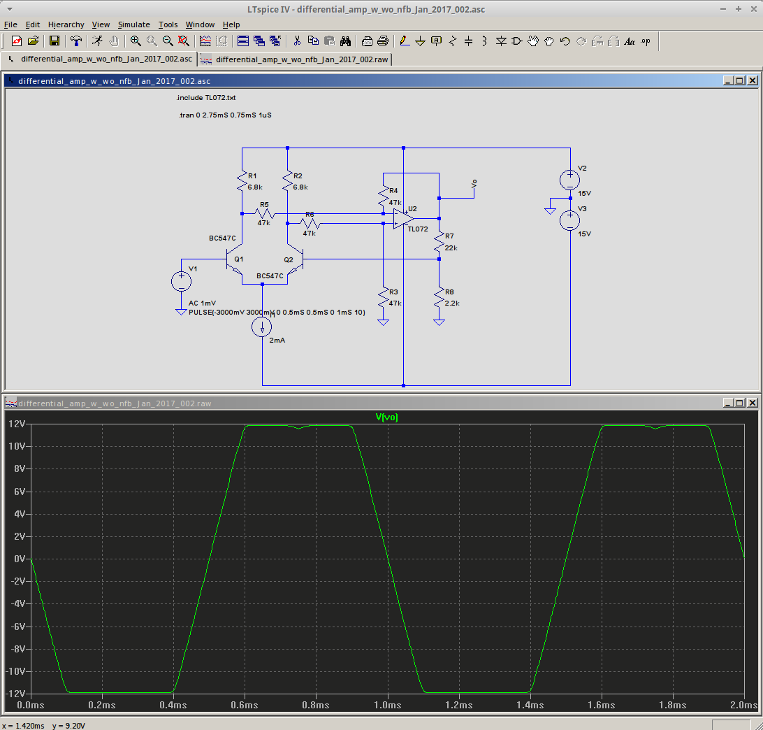

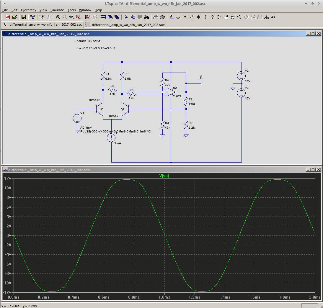

I had a little time today, so I put together a little LTSpice sim to show what increasing amounts of negative feedback do, when applied around an amplifier with some gentle, progressive non-linearity in the transfer function.
First up: a differential BJT pair, fed a rather small input signal, and no negative feedback (look at the feedback resistor value if in doubt).
Input signal is a triangle (best for viewing nonlinearity). Output signal is also a pretty good triangle.

Here's what happens if you take the previous circuit, and drive it a bit harder. Input is still a triangle, not a sine. There is gentle, progressive distortion in the output - it looks more like a sinewave than a triangle due to this distortion.
(Note that there is still no negative feedback.)

Here's what happens if we now apply just a tiny bit (6 dB) of negative feedback (that means the open-loop voltage gain has been halved due to the feedback.)
Look at the output waveform - it's quite straight in the middle, more like the triangle it's supposed to be. But when the output starts to clip, the clipping is more abrupt, and less progressive, than before.
That's what negative feedback does - it tries to make the amp linear, but that only works as long as there is excess voltage gain to trade for increased linearity. When the output starts to clip, there isn't any more excess gain, the feedback loses its grip on the situation, and abrupt overload happens.

And now lets crank up the negative feedback - we're going to drop the gain from 200 (without feedback) all the way down to about 10 (with feedback). That's about 26 dB of feedback, more than most valve designs, but much less than most solid-state amps (including opamps).
We now have excellent linearity in the middle of the waveform, but harsh and abrupt clipping at the ends. Keep it from clipping (Hi-Fi) and it's great. But let it clip (guitar), and it's awful!
So, for use with guitar, I think GJB is absolutely on the right track when it comes to staying away from negative feedback.
