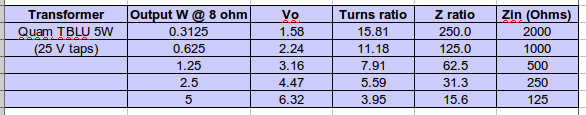

Using my spreadsheet, I found two locally available transformers that are in the ballpark for GJB's amp design. Screenshots of my spreadsheet entries for both are attached.
The first candidate is a 5W Quam unit (available at Parts Express, very inexpensive: Quam TBLU 5W-25/70V Speaker Line Matching Transformer Multi-Tap
On the 25V primary, there is a 5W tap, which corresponds to a 4:1 turns ratio. There is also a 1.25W tap, which is an 8:1 turns ratio.
So you can use this transformer with the 5W tap as the centre-tap, the "common" tap as one end, and the "1.25 W" tap as the other end. The turns ratio is 4:1 for each half, rather than the 1.4:1 you (GJB) specified.
Not ideal, but if you put a 1 ohm speaker on the secondary, you'd get exactly the same primary impedance GJB gets from his 1.4:1 transformers. More practically, two 4 ohm speakers in parallel will probably work just fine, with MOSFET supply voltage adjusted accordingly.

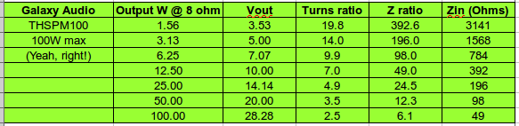

The second transformer that looks like a possibility, is a nominally 100 watt Galaxy audio unit. Not cheap:
Galaxy Audio THSPM100 70 / 100 Volt Audio Transformer
Higher powered audio line transformers have lower turns ratios, which is what we want in this particular case.
Look at my second attachment for the Galaxy transformer. Turns ratio is 2.5:1 for the 100 watt tap, and 5:1 for the 25 watt tap. So the 25 W tap is the centre-tap; use the 100W and "common" leads for the two MOSFET drains.
We need to roughly quarter the primary impedance, so using a 2 ohm speaker will do the trick; as before, two 4 ohm speakers in parallel is probably the way to go.
Mind you, it's quite possible that these will work just fine with 8 ohm speakers, with the power MOSFET supply voltage adjusted accordingly.
Personally, I'm not yet convinced that an output transformer is the only way to make a MOSFET output stage sound good with a guitar. But I might very well be wrong. :D
For those who want to try the transformer route, the QUAM unit in particular seems worth a try - it's very inexpensive, so well worth a try for a little 5W or less amp. (My 2W valve amp is way too loud at home, unless I dial down the output power with an L-pad.)

Hi Gnobuddy... While your theory sounds fine there may be some practical problems. For use in SS circuits transformers need (generally) to have as low turns ratio as possible... normally between 1:1 and 2:1 or thereabouts.
The problems you may have include:-
1) While connecting low impedance speakers may provide solve the problem from a different direction they may be difficult to obtain and/or configure.
2) Don't forget that the impedance ratio will be the SQUARE of the turns ratio. i.e. a 4:1 turns ration will produce a 16:1 impedance ratio.
3) 70 and 100 volt transformers will inherently have higher (rather than lower) ratios. 25 volt transformers will be better.
4) Low powered (10 watt) line transformers will also inherently suffer the same problem. A 25 watt unit was the lowest suitable I could find. (Details available if required)
Having said all of that... what you are suggesting is still possible... but you will need an output set up for higher voltage and lower current operation... to get your load line matching the transformer. Something like 2SK2013' s would be possible. I have some of these! :)
GJB
