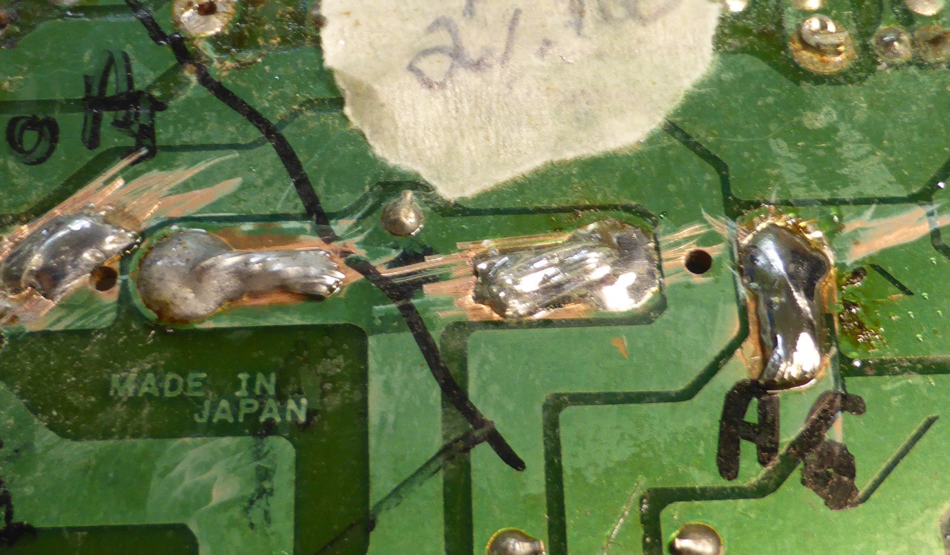

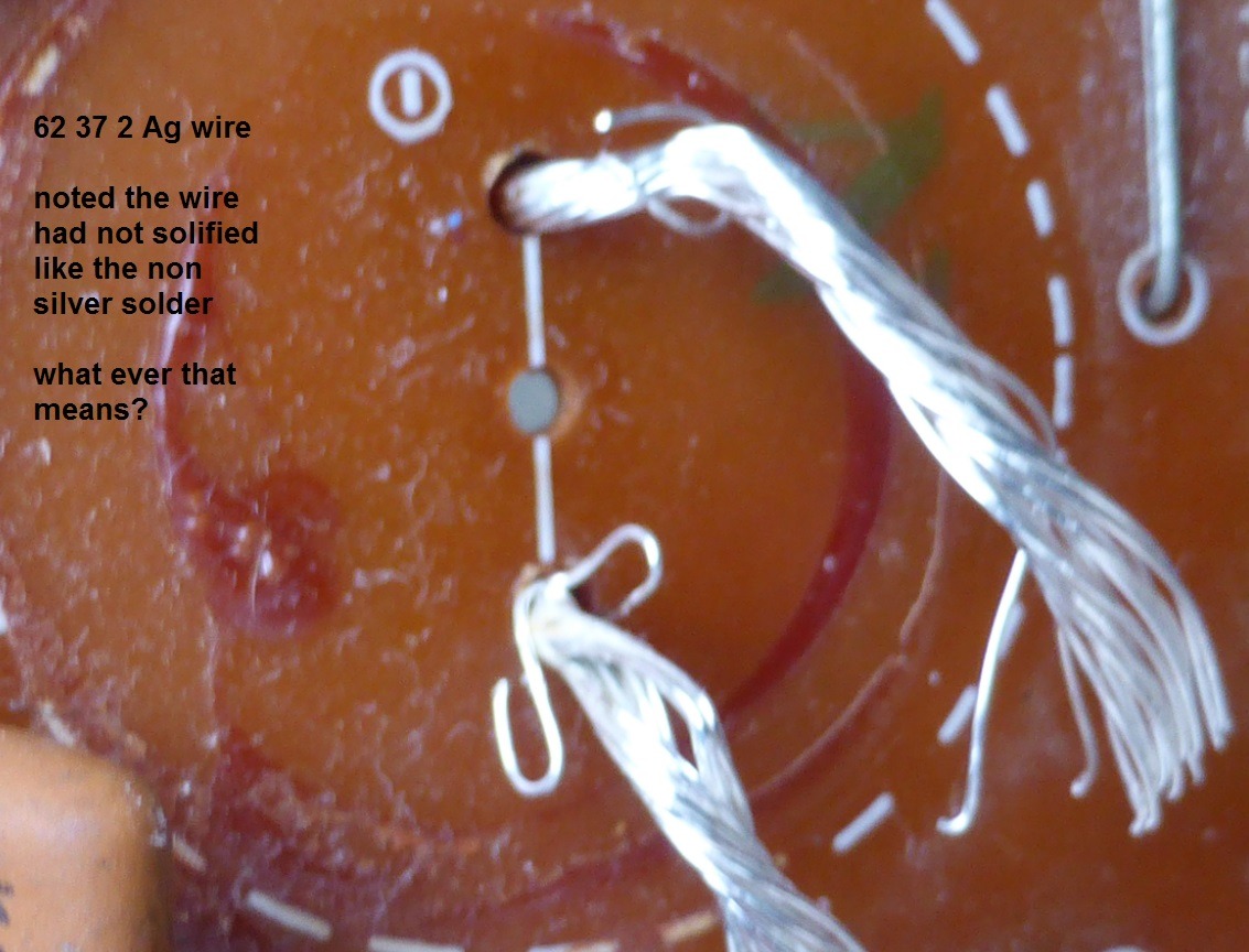

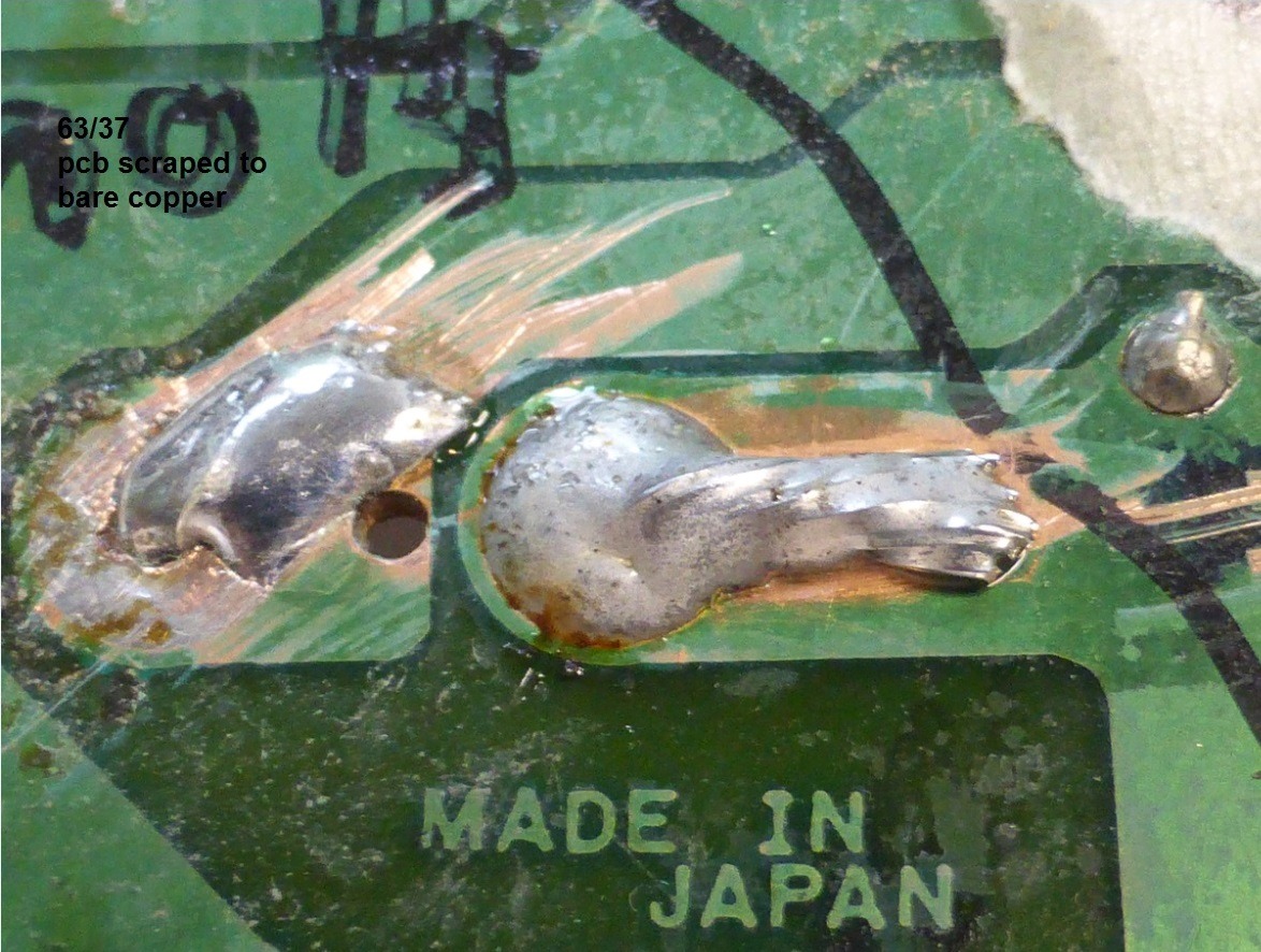

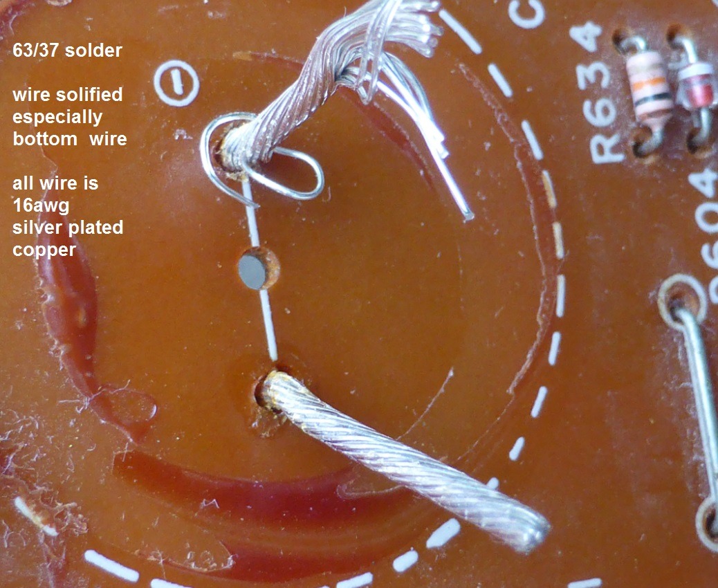

I think, regardless both are good and from my test, i think the 63/37 seemed the better joint
I decided to test for myself, and with images, I got some old spare amp board around and scraped back to bare copper on the traces. I got 16 silver plated copper same length.
I swapped which solder went first.
1. Duratool 63/37, really like it and have been using it
3. Chip Quik 62 37 2 AG, very nice flow also, hard to pick.
Detailed images
Side by side
6337 close up, my fav is the right, looks nice and solid
Silver content 62
The no sliver based solder, the silver plalted copper wire had solidfied
Silver version wire, not solidfied
