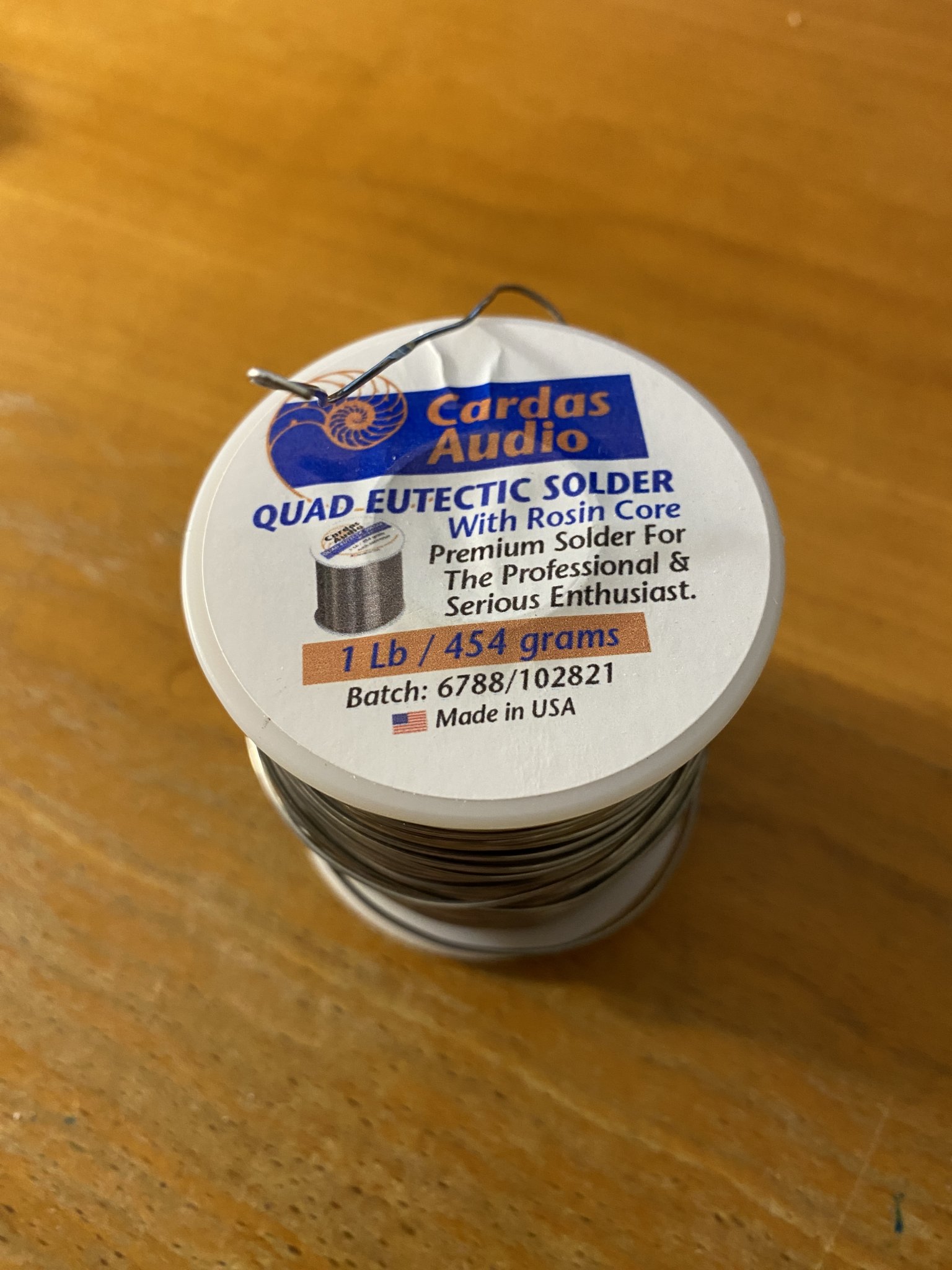

I tend to avoid the middle one... it's for a serious enthusiast only...
Reactions: 1 user

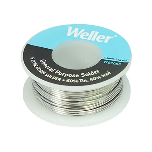

I use the cheap Weller stuff from Bunnings for most of my work:
https://www.bunnings.com.au/weller-...older_p0248145?store=5212&gclsrc=ds&gclsrc=ds
Still have a small spool of quality 0.5 mm 60/40 solder from the time when was working in the trade.
The best I had was a 60/37/3 tin/lead/copper which alas I can not find anymore, at least for a decent price locally.
Refuse to buy off ePay or Jaycar as the quality is really questionable.
Use an old Hakko 926 and because I've been doing it for 30 odd years I'm comfortable using a single chisel type tip for all my work. Max temp that I use is 350 C, but most of the time stay between 300 - 320.
All the advices to use higher temps are risky and ill informed to say the least.
It's not just temperature, but the quality of solder, the power of your iron, the size tip, the size of the solder pad, the ambient temperature and so on.
Pre-tinning legs of passive components, pre-tinning the iron tip, also cleaning it before every single solder spot are mandatory if one wants reliability.
You should not stay on a single pad for more than 2 - 3 seconds. If it takes longer it means either the solder is not right, the temp is not right, the tip is not right, cleanliness is not right, your iron is under powered.
Never use flux unless I need to de-solder a very heavy wire or terminal and do it without damaging the pad. The risk of lifting pads, especially with old equipment is huge.

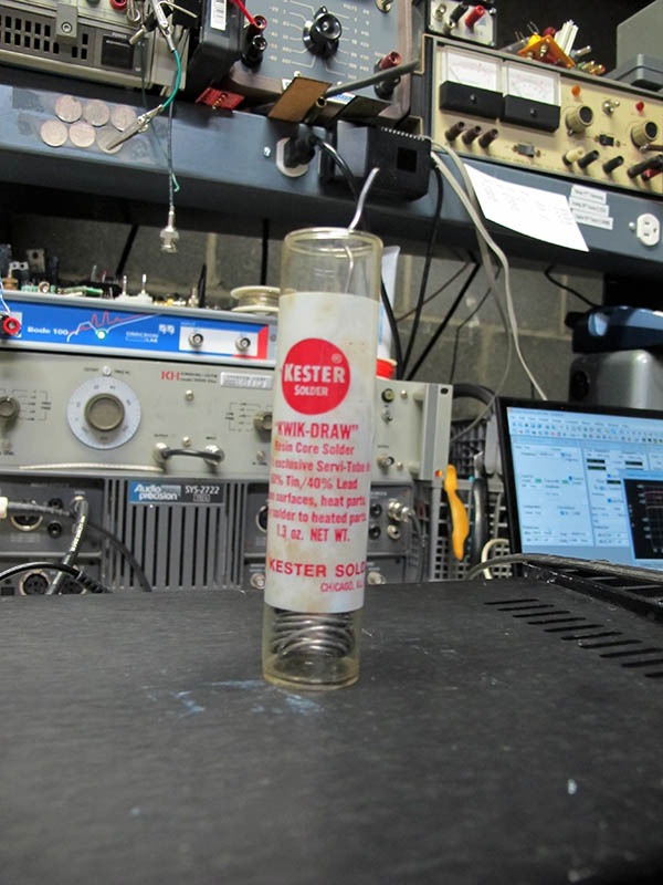

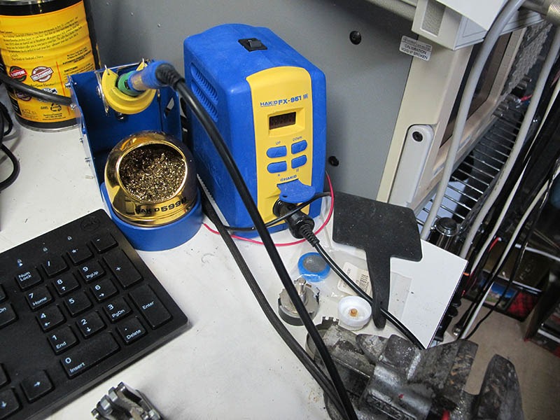

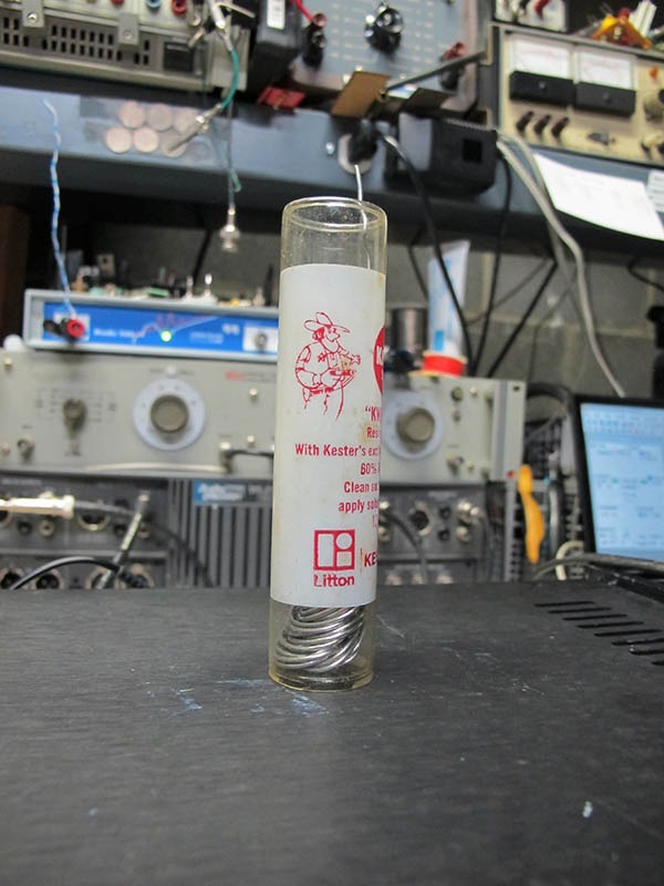

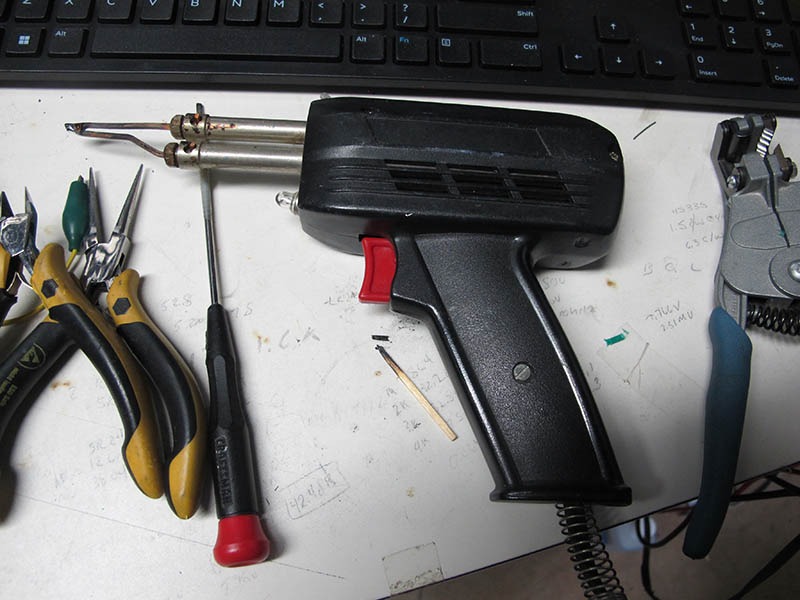

Here are my various soldering apparatus. I don't use the Kester "Kwik Draw" -- just keep it around for sentimental value as I used it throughout the 1960's DIYing ham radio transmitters. The Weller gun was a Christmas present circa 1966. #1 son dropped it from a ladder so it has a new case. Still works.
