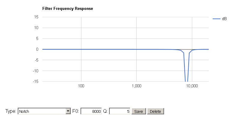

I miss the SXQ graphs showing response of applied filters.

Just published a Software Crossover/Equalizer that I have been working on. It will be further developed, and more testing is yet to be done. Very curious what the homes here at diyaudio think of it...

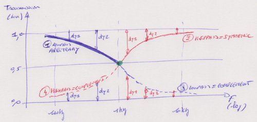

1. You measure and store the bare amplitude and phase responses of your drivers, using a FFT-4096. Please note, the value of 4096 is not far away from the FIR-filter length of 4410 we've been talking above. For grabbing the phase, you need a dual-channel FFT analyzer : channel#1 is the reference (pink noise voltage feeding the speaker driver) and channel#2 is the measure (voltage coming from the mike that's facing the speaker driver).
2. You define your acoustic target curve, same format as above (amplitude and phase). If you are dealing with a medium driver, you will specify a highpass -6 dB at 600 Hz, pseudo 2.5 order, low Q, and phase linear (equal to a 100 ms delay). If you are dealing with a woofer, you will specify a lowpass -6 dB at 600 Hz, pseudo 2.5 order, low Q, and phase linear (equal to a 100 ms delay). In doing so, you need to satisfy one criterion : the highpass acoustic target must complement the lowpass acoustic target. In other words, their sum need to equal unity, in amplitude and in phase. Addressing this, you will discover that you don't have many choices what's regarding the "Q" factor. Actually, the "Q" factor is not a good paradigm here. You better take a piece of paper, and sketch the symmetry that's required, which in turn defines the lowpass amplitude diagram that you require, for ensuring that there exists a corresponding highpass diagram complementing it. You don't find this in textbooks.
3. You compare the bare curves with the target curves, in amplitude and in phase, same format as above. This is indeed the equalization you require.
4. But wait a minute, such required equalization appears in the form of a 4096-FFT. Thus, applying an inverse FFT to it, will show the convolver implementing it. And here, look, such convolution is the 4096-tap FIR filter that you require. It is that easy !
Job done. Agree ?

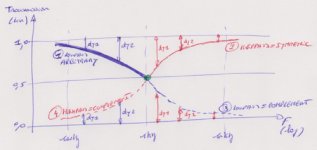

Attached is a piece of paper showing the symmetry that's required for ensuring that there exist a highpass, complementary to the lowpass being specified.
